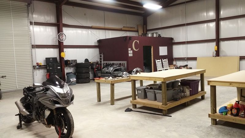

First post on here and wanted to introduce myself. Name is Del and there's no doubt future SLC builder/owner. Modifying stuff has always been a hobby of mine. If I own it or want to buy something, likely it's going to be modified. Stuff ranges from cars, truck, CRF50 stunt bike, making a CRF50 street legal, Hayabusa's, guns, RC cars/boats and the list can go on and on. I've owned several vehicles, 2000 Trans Am Firehawk #102, 2005 GTO, 2008 Trailblazer SS, Suzuki SV650, 2003 Hayabusa and presently own a Ford Raptor & 2009 Hayabusa. Every vehicle I've owned has always had a personalized license plate (another childhood thing). While I have time to figure out what SLC will have, past has been XTINCT (Firehawk & GTO), LS2SSUV (TBSS), MY 420 (03 & 09 Hayabusa), FIDDY (street legal CRF50) and the Raptor has had both XTINCT and EXTINCT (just got the latter when it became available). My passion lies in electronics and back when I was in college and still is a big part was LEDs.... Coincidentally my name spelled backwards is LED.
Now that I have finished building my house (of course all LEDs) and shop last September (built same time, like any man should do, haha) and now have the shop cleaned and setup I'm coming to the part of my life where I can build my childhood dream.... A kit car. For better part of last decade I've had my sights on a GTM and now that priorities are out of the way I've been doing a lot of researching lately. I've determined GTM :thumbsdown: is definitely not the kit I want to build. Everything I've read just seems like one huge headache (and 2x amount of time) which thankfully has also led me to the SLC. Upon first look, it's definitely different but had so many cool aspects like the doors, interior and mainly the QUALITY of kit. The more I looked at it, the more I fell in love and can't wait to start it.

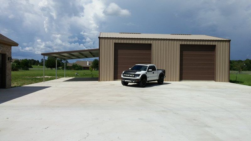

My shop is 50'x40'x16' metal building (insulated) with 3 14'x14' roll up doors (2 on front, 1 on rear). When I originally designed the shop the right bay has always dedicated to this project. The other bay I can use for daily driver, bikes or whatever other kind of projects I have going on at the time and likely will get a lift at some point.
Right now I'm thinking stages that way I can start working on it while saving. Any suggestions on ways I may need to setup my SLC bay to accommodate the build? I have 2 4ftx8ft work benches between the bays and I'm sure they'll get alot of use holding parts for most of the build. I haven't fully decided if I'm going to order it stages or complete.

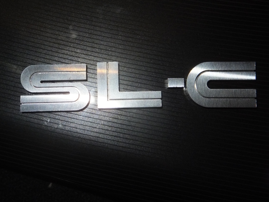

Also one last random question... Anyone happen to have a picture of the Superlite SLC logo? I've looked around and I can't find anything. I definitely plan to design and get some emblems made for my SLC, of course, with Fran's blessing.

Your shop is perfect. If I had the room you have I would build a temporary rack to house the front and rear clip from time to time. I always seam to be taking them off and leaning them against the wall. I have also considered a rolling stand up rack of some kind for them to stand on end vertically.
Your shop is plenty high so maybe mount a lift point in the right place so that you can hoist the center section up and out of the way from time to time. The body work will get in the way and it does take up a lot of room.
Other than that you look good to go except I don't see a refrigerator. Your gonna need one of those.

I made the 4x8 tables you show, although mine are on wheels so I can get them to the location they are needed (or out of the way) easily. They are great for fiberglass part production.

I agree that putting your benches on wheels will help a bunch. You will have to move them around, period.
Finding a place for both front & rear clips is VERY helpful.

I actually had planned on putting casters on those middle benches when I built them, but afterwards they're so massive I don't "think" I'll be moving them much. I do plan to built a 6th, smaller bench with casters for just what ya'll have suggested. Make it easy to roll around parts/tools. I also have kicked around building two 30" deep ones (like on opposite side of shop) that will go where my wife's pink kayak is now, specifically for parts. Just need to get the chassis in first and make sure I have plenty of room around it. Tops are MDF, thinking I need to seal or laminate the middle ones so I can cut and put dirty oily/wet parts on them.
BTW that 3rd shorter bench between the bays is for the office once I finish inside it.
Anyone have a guesstimate on what sort of dimensions (including car with body) are ideal for SLC working area? If I can get a feel for it, I may can go ahead and build some benches on that side.
Here was my preliminary floor plan I drew right after shop was built. I've changed table sizes and outlet heights as needed so everything was more ideal. Reminds me, I need to update it just because.

Anyone have a Superlite SLC logo? I can't find one on the site and want to Photoshop a background for my computer.

My eve's are 16ft and I believe the peak is ~21ft (off memory, I know i went with the least steep roof line). I can find my building drawings if you'd like to get you an exact figure on total height?

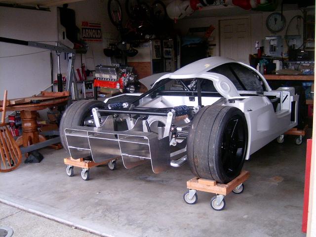

Make some of these. Wheels at McMaster Carr. Use cheap low capacity wheels. 150-200lbs will be good enough. Great when working alone and if you get 6 inch wheels and put them on 2 inches of wood you will be able to work underneath.

I was curious about if you need to move car around solo and more so you gain some clearance when building. Beats heck out of jack and jack stands constantly!

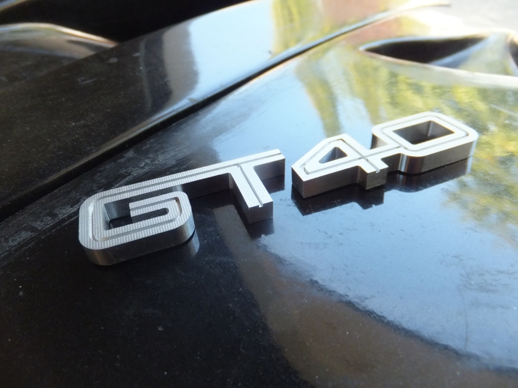

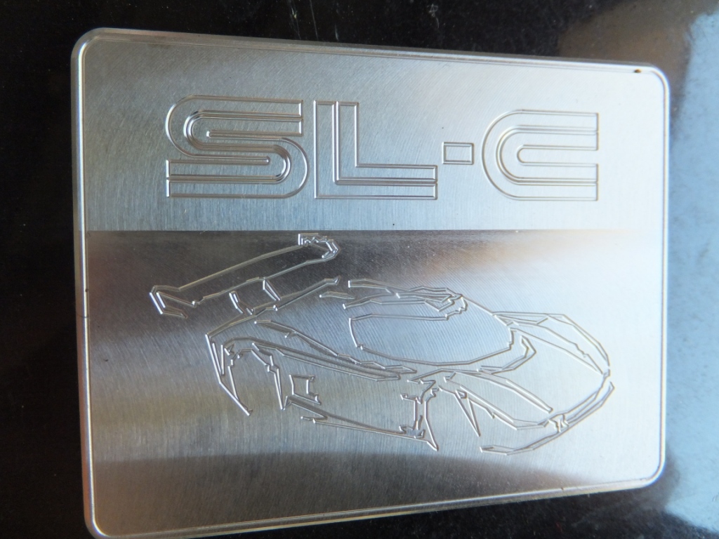

Hi Del
I have a badge design that I made for Peter and Stu's cars. It goes in the center area above the rear bumper.
If you can PM me I will send you the DXFs or cad files if you can open them.
If needed you could design your own and send me a 3D (IGES or STEP) of what you want and I could make and send to you.

That's awesome looking! I'd love to have the CAD files, definitely can open them. I can draw in 3D a little bit, looks like I'll need to sharpen my skills and see what I can come up with! Thank you!
