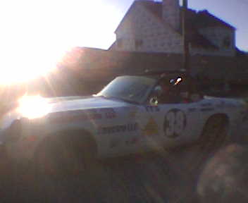

Here are some really bad camera phone photos and video:
