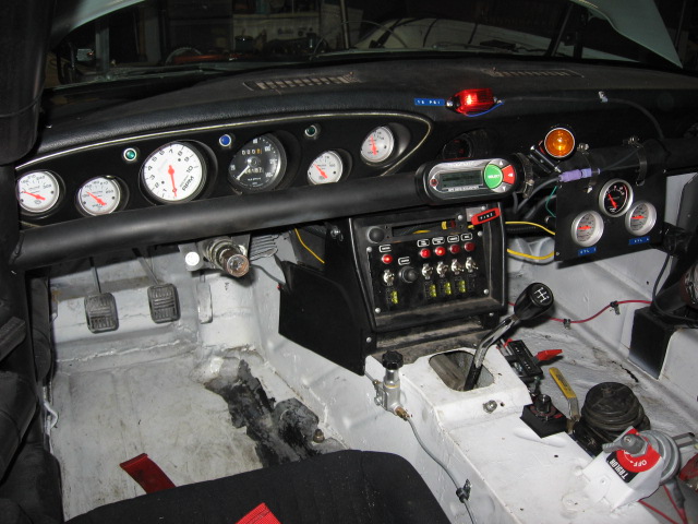

Now the accusump is plumbed to the main gallery like it should be and we've got good fittings throughout. Hot oil pressure, and I mean hot, doesn't drop below about 25 psi at idle which is damn good for a 9XX motor. At 2500 RPM we'll get 50psi at least even when toasty. My old Lotus Esprit routinely got down to 10-15psi at 185F and lower when hotter at idle. On the dyno we have good oil temp, cool water temps in the 170F range even with long steady pulls, and oil temp in the 180F range or a tad higher. I like what we have now and feel we're safe.
