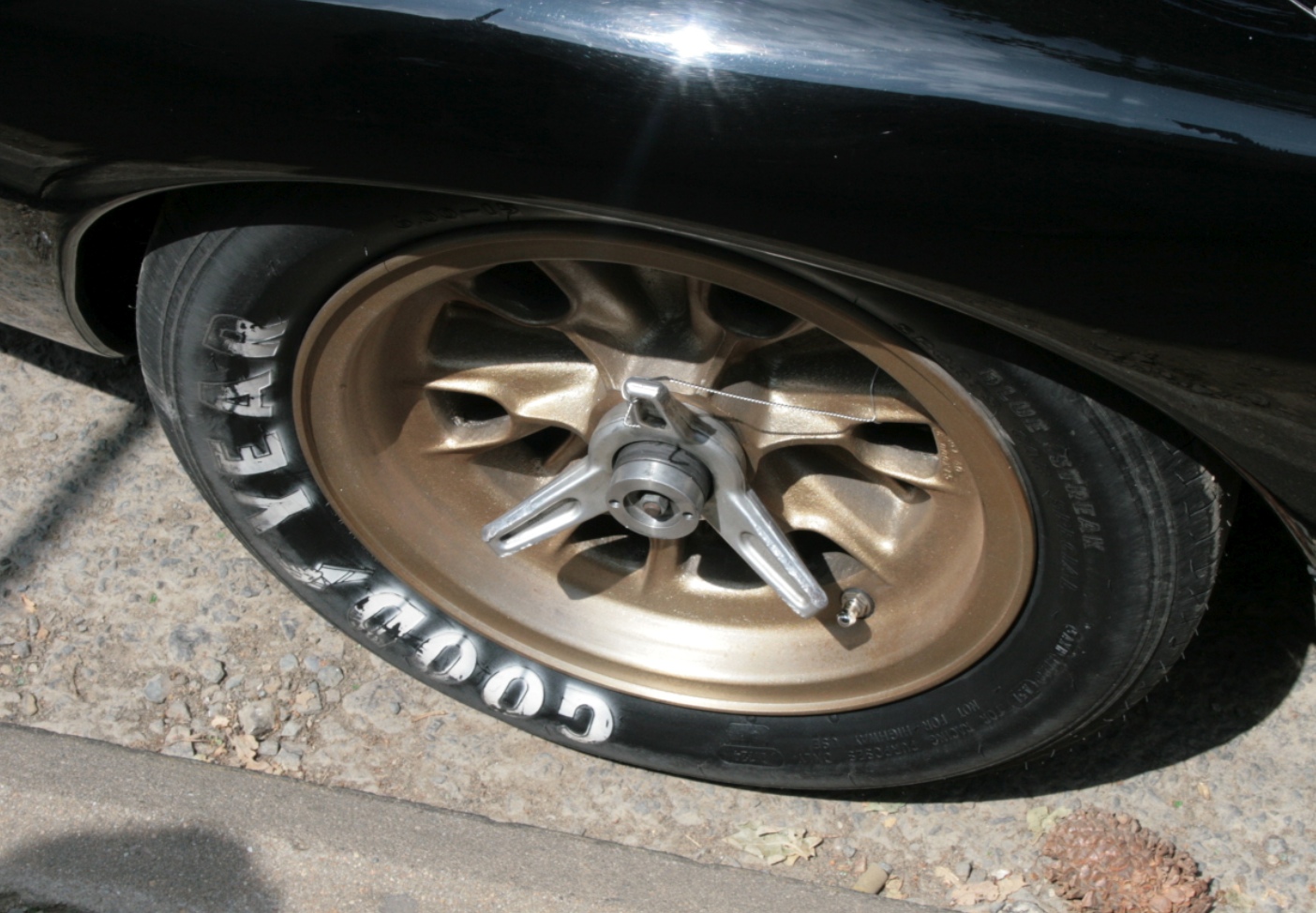

Anybody know the spec for the gold paint on original cars?

Hi Andy,
The originals on the Mk.II's weren't painted gold, that was effectively the natural finish of the magnesium I believe. Don't ask me why they appeared bronze rather than silver as I can't remember the reason now.
Have a look at 1046 as it is now to get a feel for the colour used these days.
Brian Stewart
I took lots of pictures of 1046 at the Le Mans Classic back in 2006 and then spent ages searching for a gold that looked reasonably close to 1046's wheels. Finally settled on Maya Gold Metallic, a Landrover colour with the code GAN. It's not exact, but I am very pleased with the result. Take a look at my build thread for a picture, although the picture doesn't show the colour terribly well. Maybe go to a local auto paint shop and ask to see a swatch.

Hi Andy,
The gold color comes from the DOW coating that was applied to prevent the magnesium from corroding and powering as it will do when exposed to moisture and atmosphere.
Brian Stewart
1046 wheel.
DOW 7
There are lots of smaller aerospace shops that still have the capability to do DOW 7, due to the fact that a lot of helicopter parts (main & tail gearboxes, wheels, various controls etc.) are mag castings.
