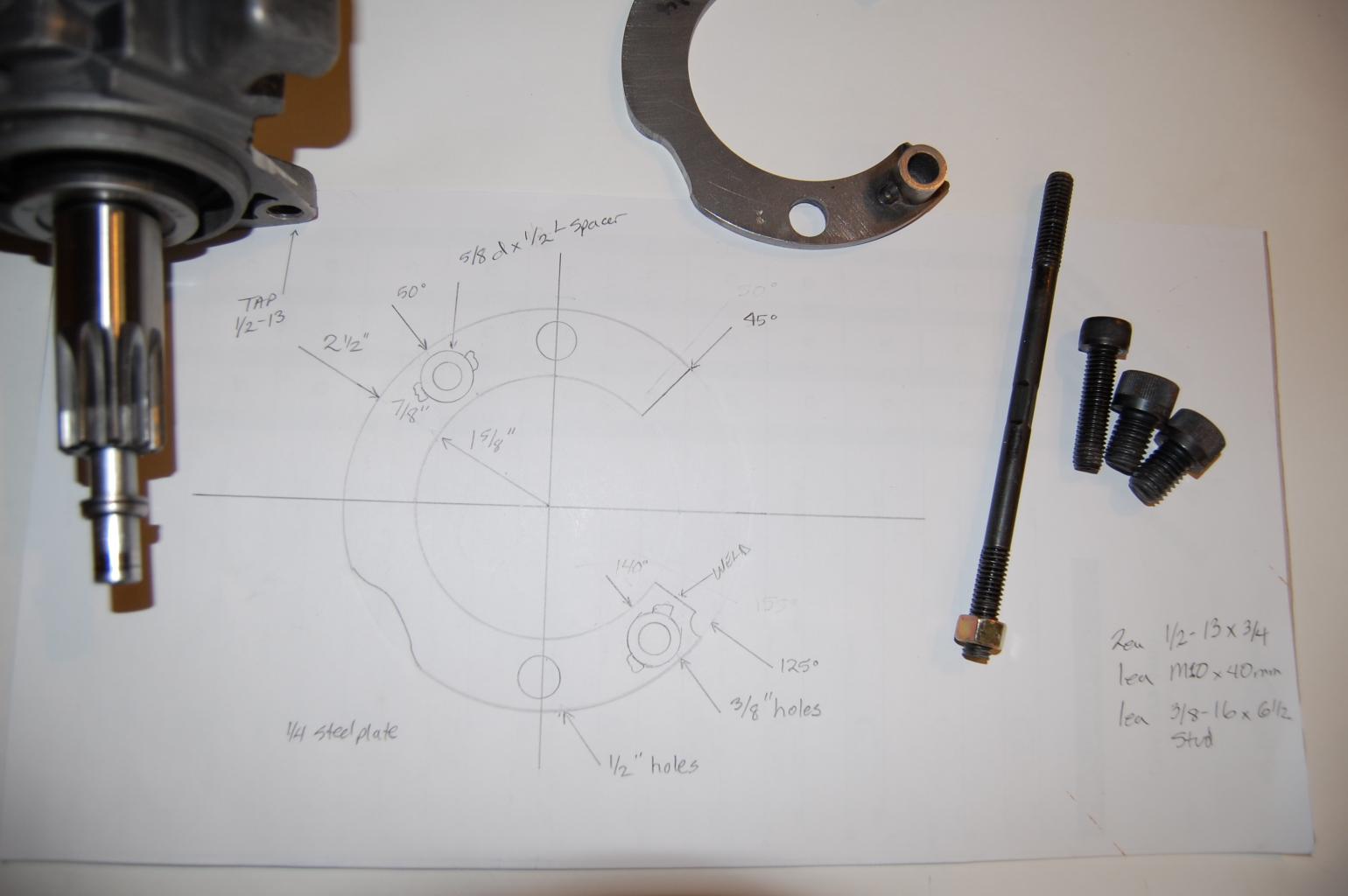

Yes; Plate steel on a turntable & mill. Welded the spacers on, there is a short bolt threaded into the starter flange - be careful tapping the flange - to keep it the starter from trying to spin. Two bolts hold the starter in as normal.
If anyone would like a diagram posted, I can work one up with dimensions, etc.

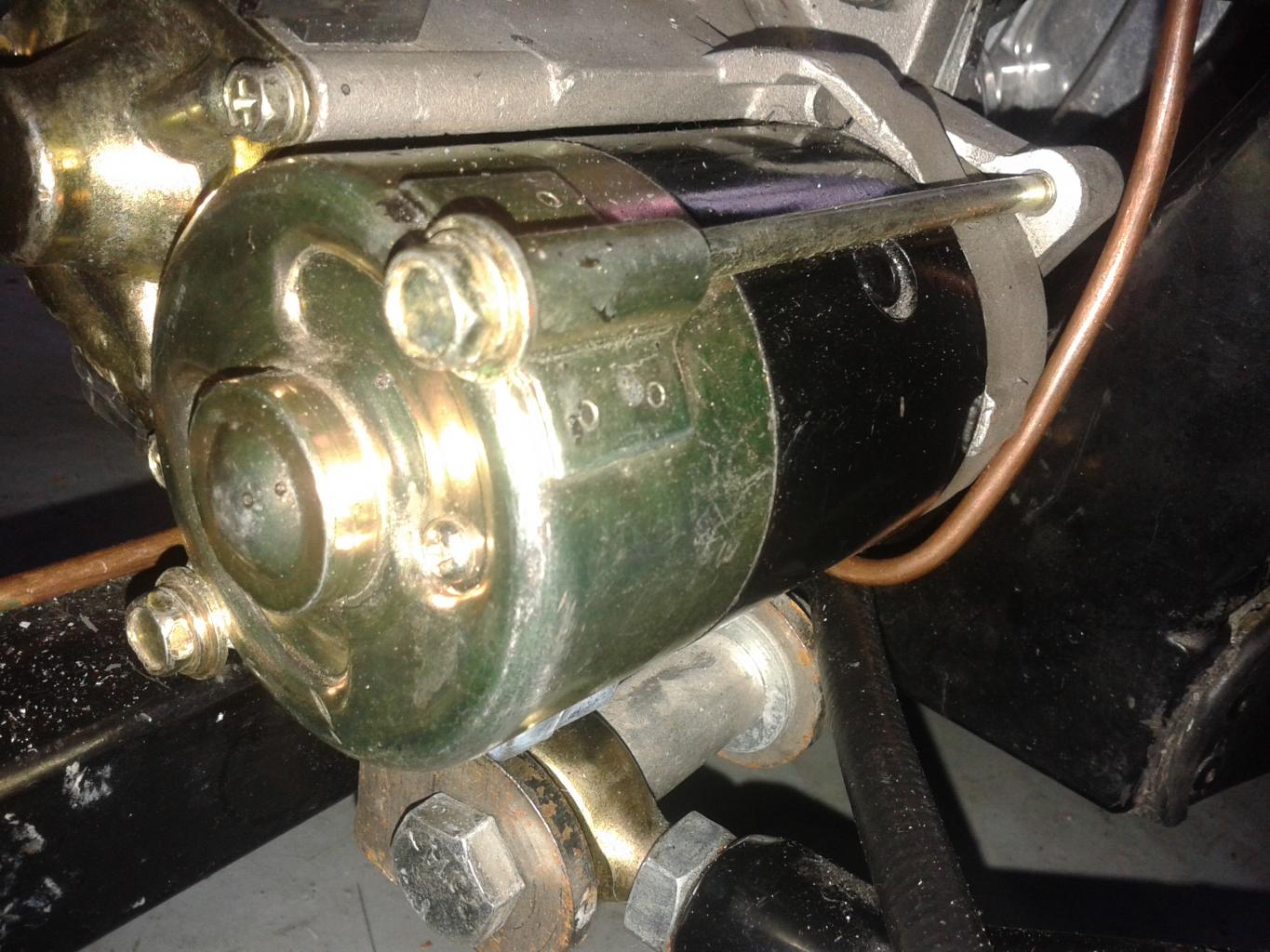

I have one of Chris (Flatchat) trans adapters, bit concerned as I thought it was just a case of buying a G50 starter motor and plonking it on which I did, picture attached.
No idea what indexing is about will it be OK

Nick,
If you got it bolted on and it starts you don't have to worry about indexing. That is when you try to mount the starter and you can't because it hits something(frame cross member etc.). Then you try to turn it to where it will go in all the way, and it won't line up with the bolt pattern. There are adapters on some of the starters that give you multiple mounting holes.

Thanks Bill,
Had a feeling from the drawing Chris put on it was something like that.

Yes Doug I would like a diagram
HTML:
thanks Dwight
Please go ahead and post up the diagram here Doug...

Well today I installed my starter, Thanks to the help of Doug and BigFoot pictures.
Thanks guys

pics of the pieces to mount my starter
I turn a aluminum spacer for the 10 mm all thread rod. This holds the bottom mount on the starter. I did have to cut a notch in it to clean the trannie case on one end.
For the top mounting hole I made a piece to clamp the starter in place. I welded a 7/16" rod on one end to hold the starter and drilled a 10 mm hole for the stud on the trannie case. this will keep the starter from turning under torque. I used the small spacer under the stud.
I'll know if it works after a few starts on the motor.

Spent the day in the shop; here's a photo and some dimensions that may help. You may have to massage the outside radius for trans clearance. Go easy on the starter holes if you tap them - don't break the lugs, that is bad. Anyway, hope this helps.
Thanks Doug!!! These measurements along with all the pics will certainly be of help to guys that need to re-clock their Porsche starters..
