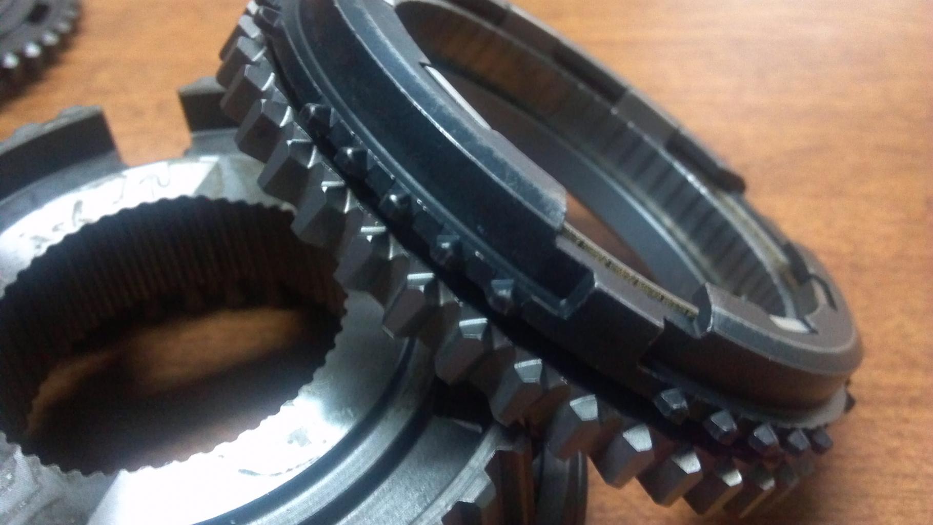

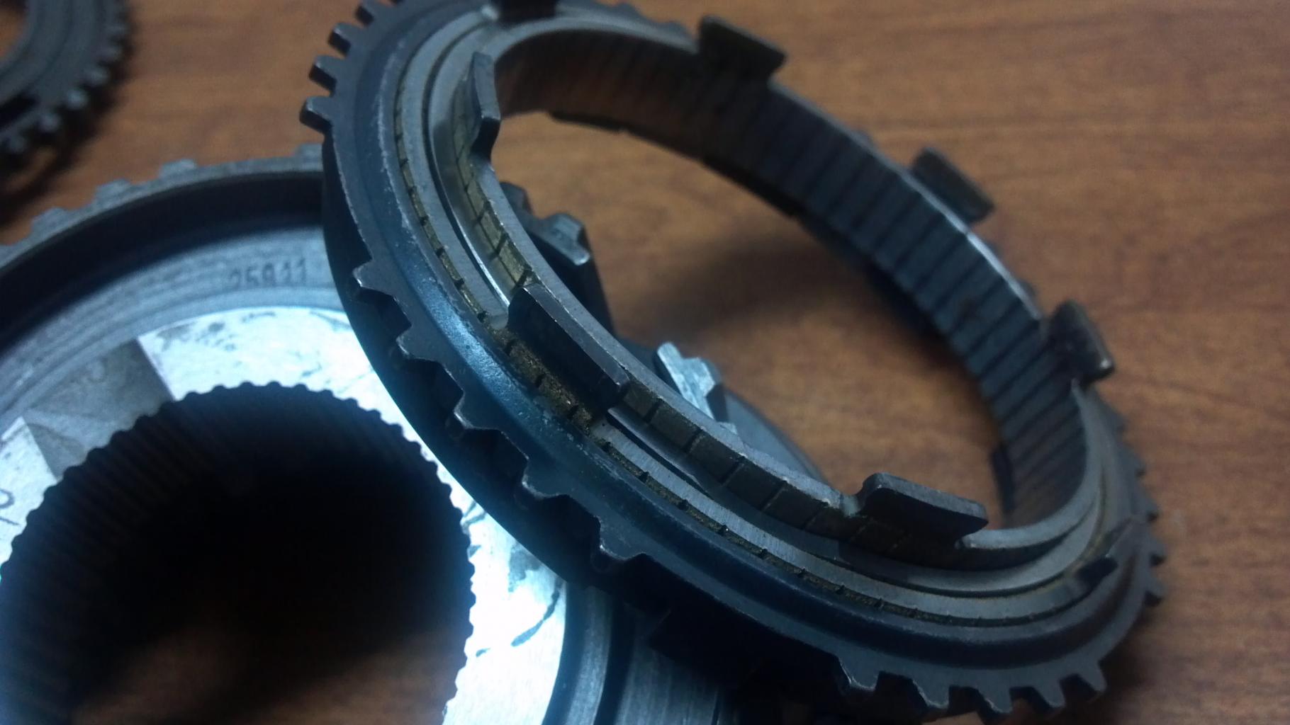

I will give you a sneak preview...
:idea: Good Ideas... Make Geat GEARBOXES
DeLynn
And what advantage is that Jack? (or is it?)
On the 'old' style single synchro rings they have a limited 'area' of contact to work , with heavy-larger gears to handle high torque loads/HP there is more mass & weight for the synchro cone to overcome when you change gears in order to get the shift hub speeds equalised to select the next gear, "better" or more mechanically sympathetic drivers get quite good at judging RPM etc to make life easier on the synchro units, but unfortunately most credit card car drivers & builders these days wouldnt have a clue what I am talking about so the manufacturers have had to find a way of improving this area, the enviromentally biased who voted to remove some of the 'good' or 'bad[ if your that way inclined] additives from todays oils have not helped either....such is life...
