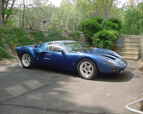

Bill Bayard,
What wheels are those on your car? Are they Simmons? And what size are they?
You get used to only seeing the cars with the original wheels, but those look good on the car.
Kevin

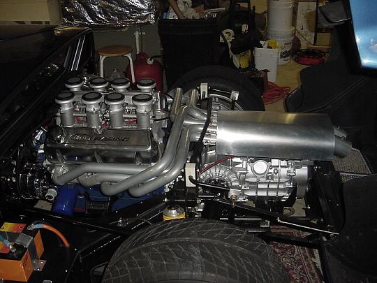

If you liked the outside view of my car, how about this? /ubbthreads/images/graemlins/wink.gif
