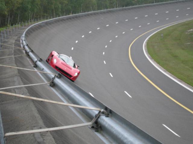

Cx was about .3 We were making about 1000 lbs of downforce at 150 mph. We could have made more but didn't want to increase springs for the street. At 200 on the banking we put the rt rear fender into the tire compressing the body about 2 inches.
The springs are fine for the street but you'd want more for racing.
