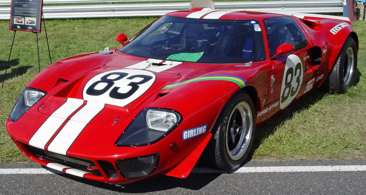

Hi guys.... painting a Mk 1....looking for a red paint code to match the 1083 car....not sure if anyone really can assist but thought I'd try....:)
Thanks in advance

To me it looks like the Superformance color, Monza Red.

1083 was painted carnival red in 1969 when the car was originally painted . Racing icons did the restoration according to my information it was repainted carnival red .

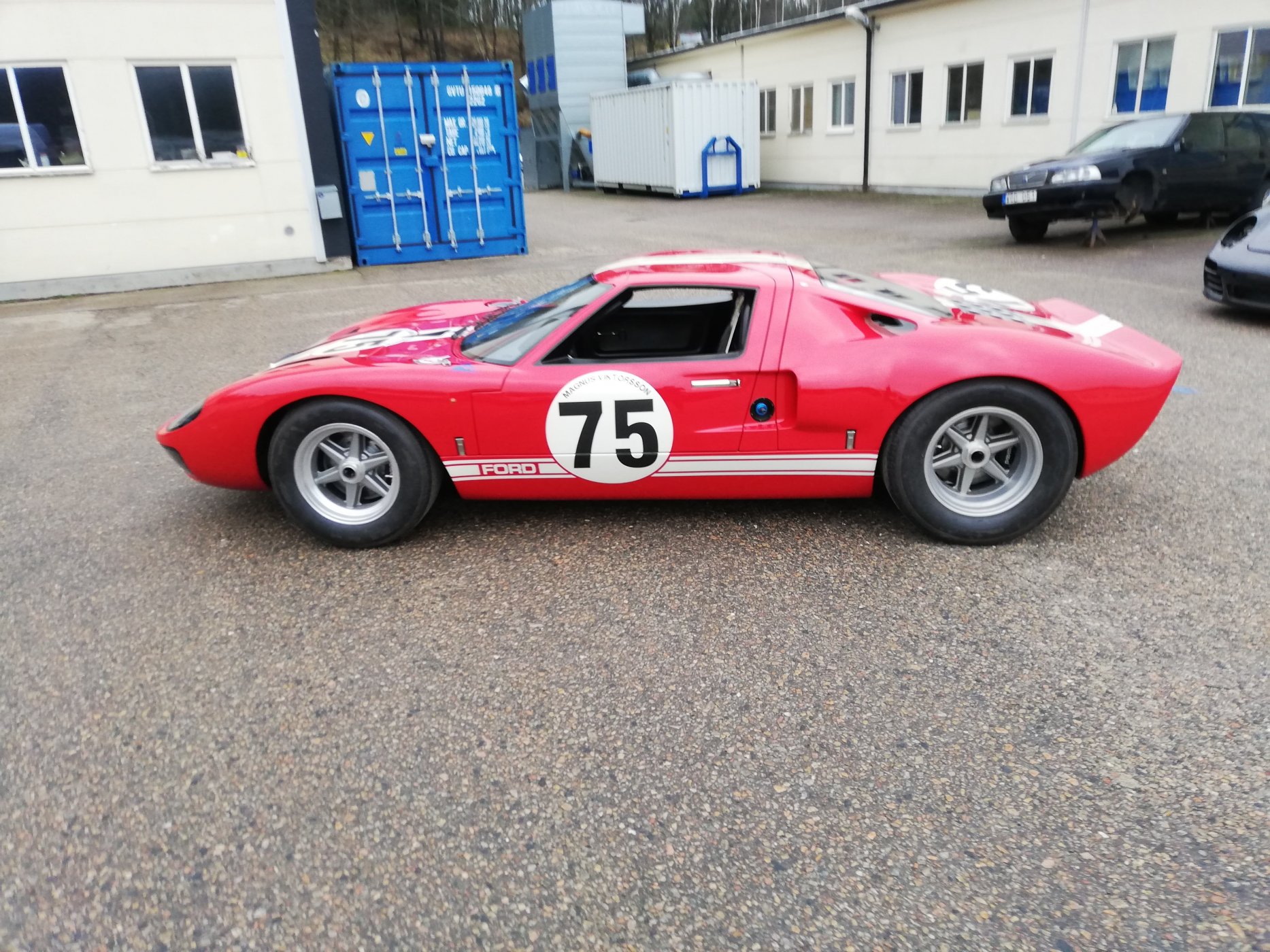

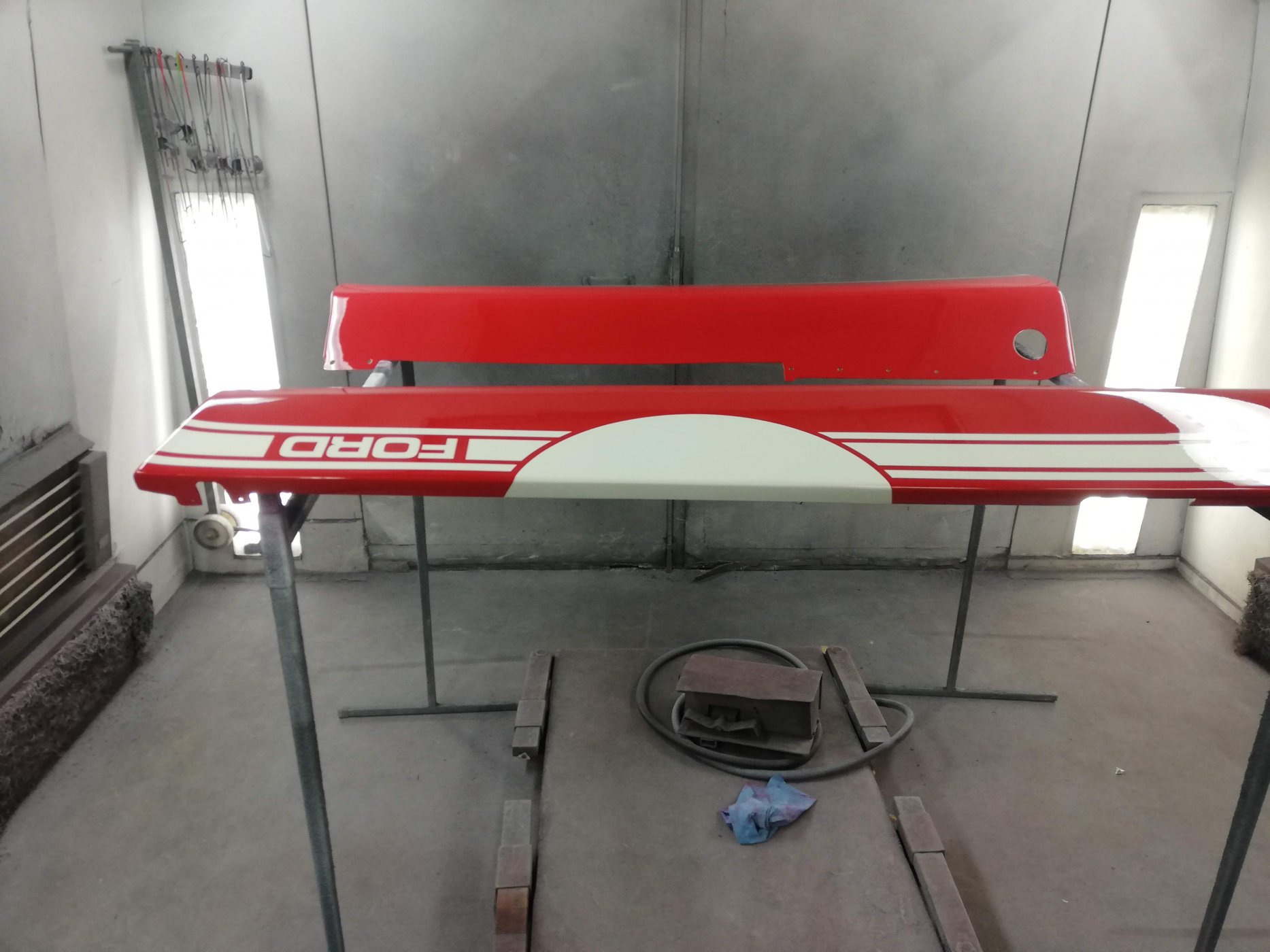

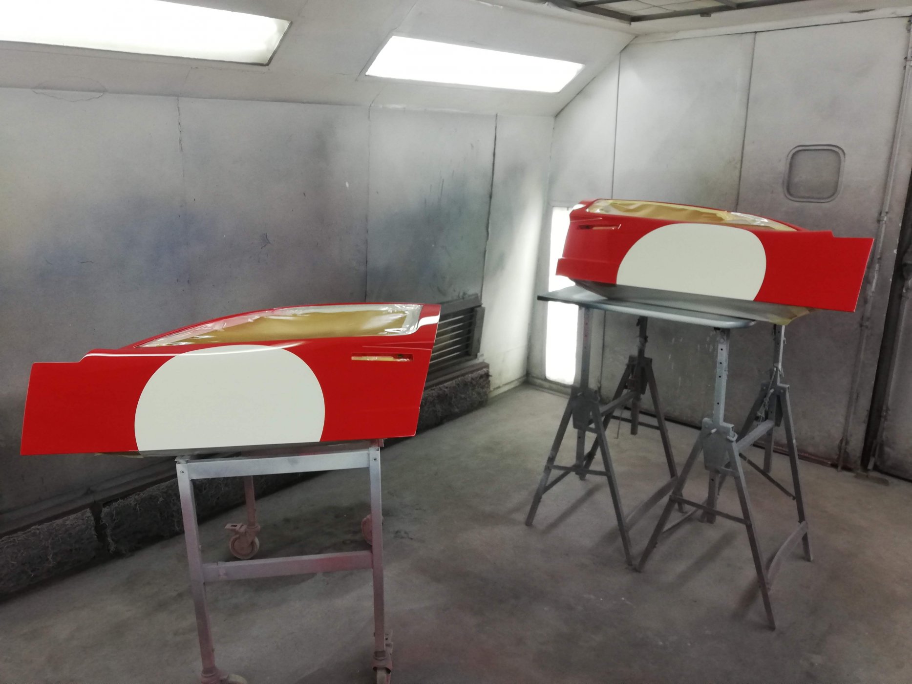

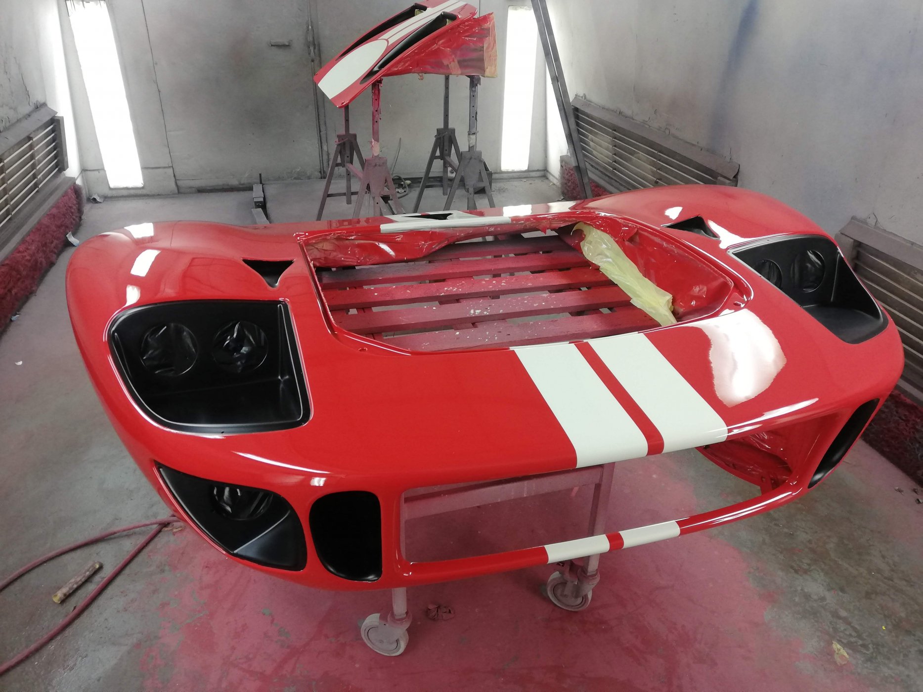

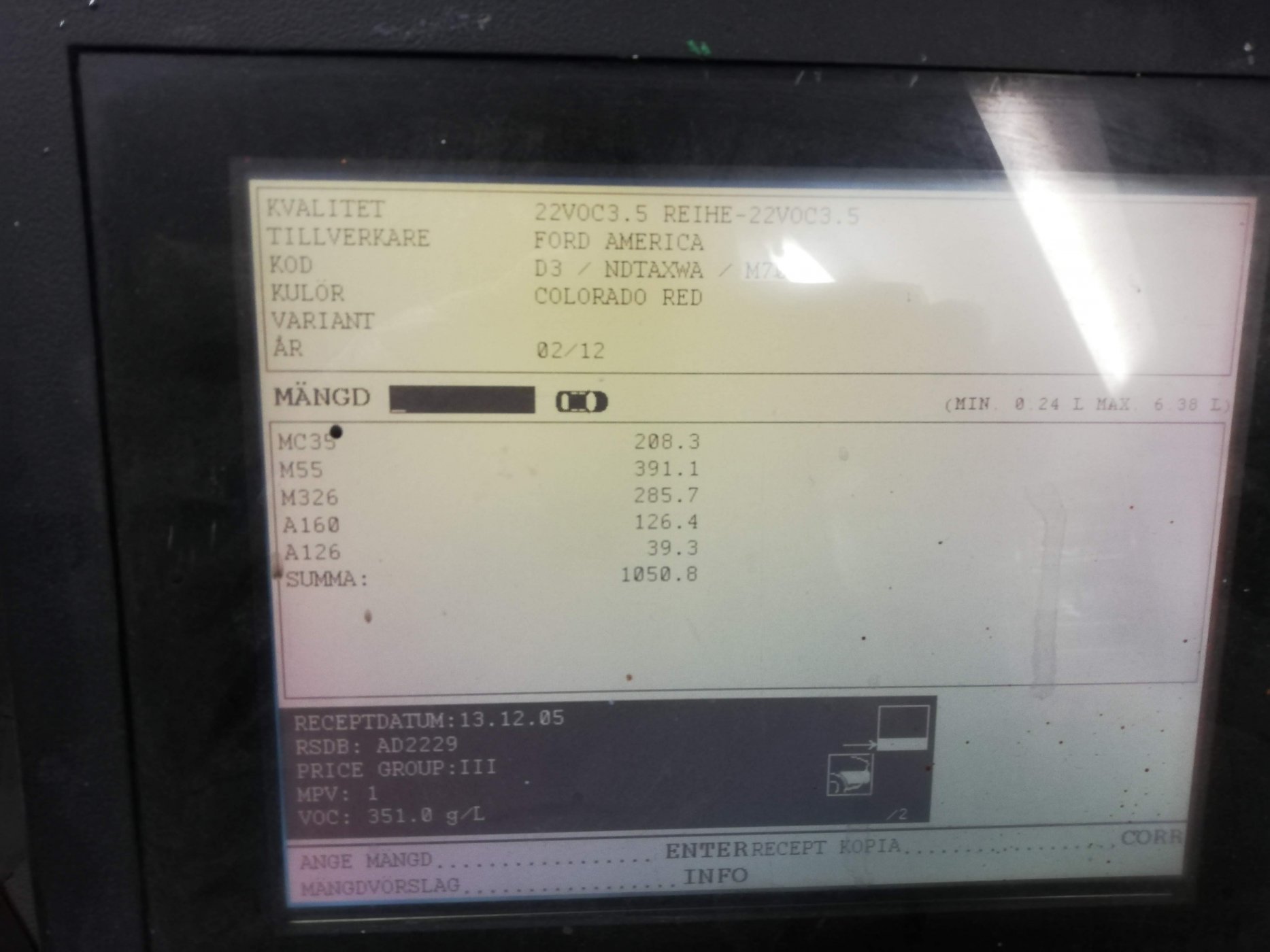

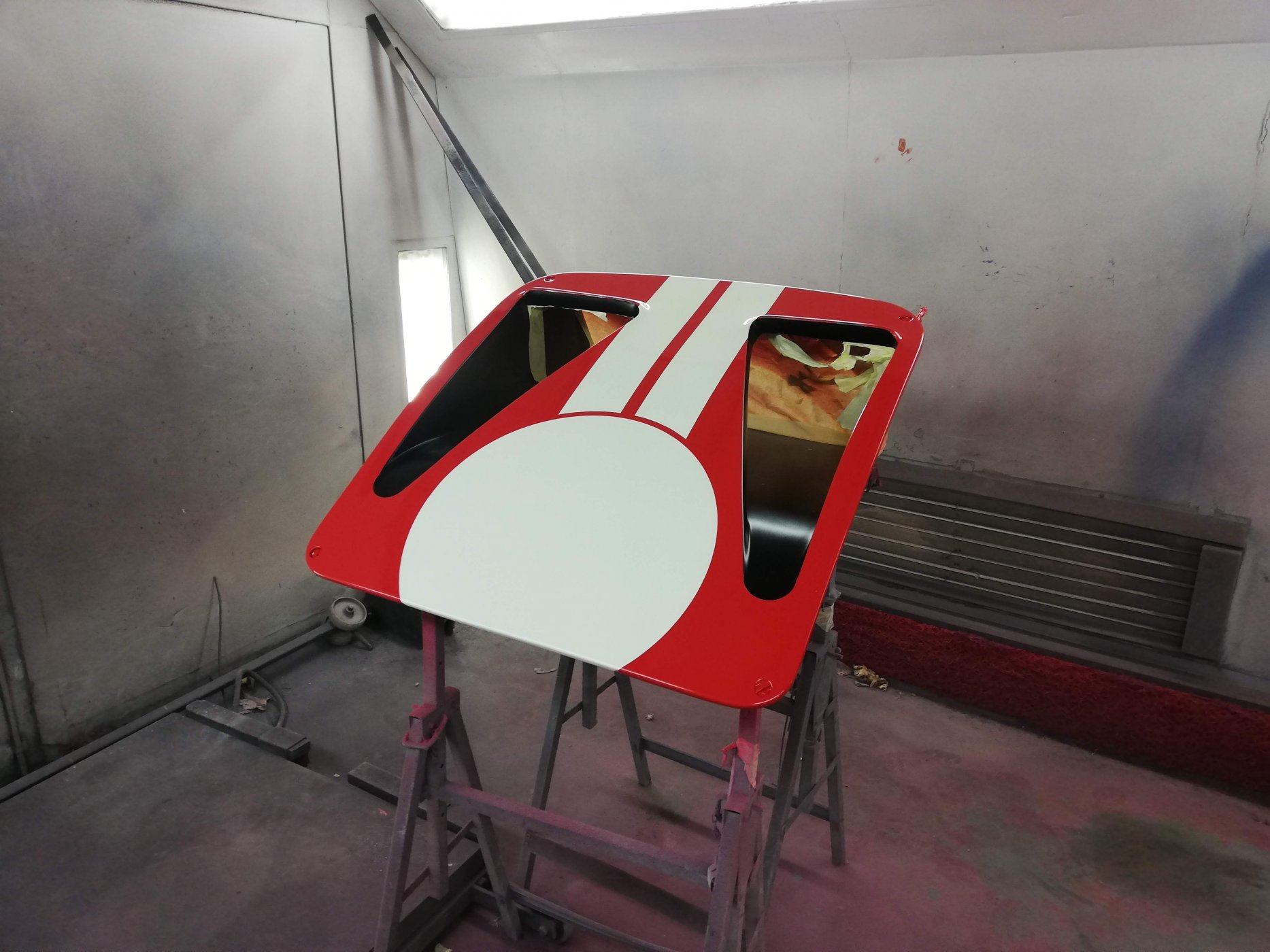

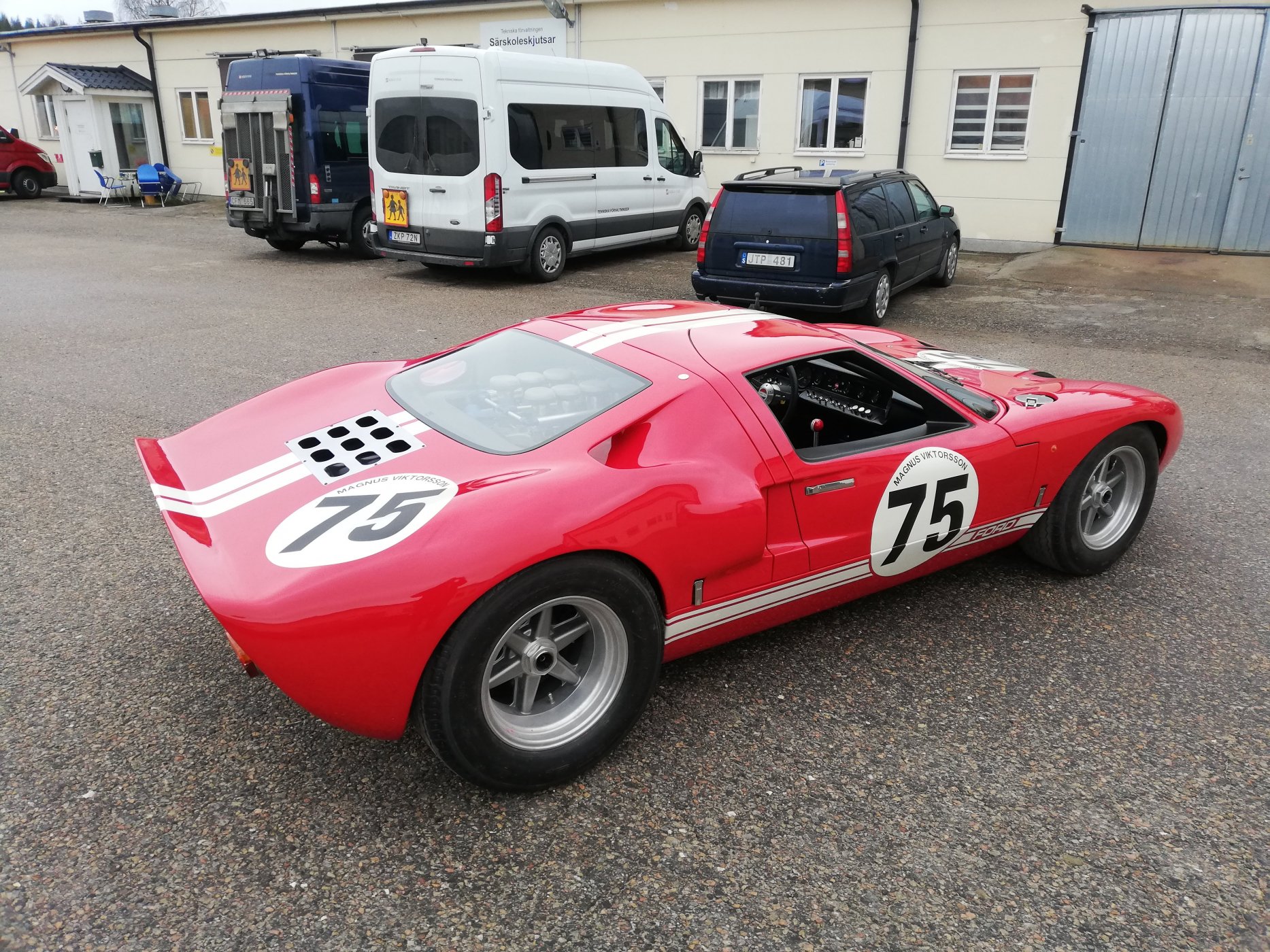

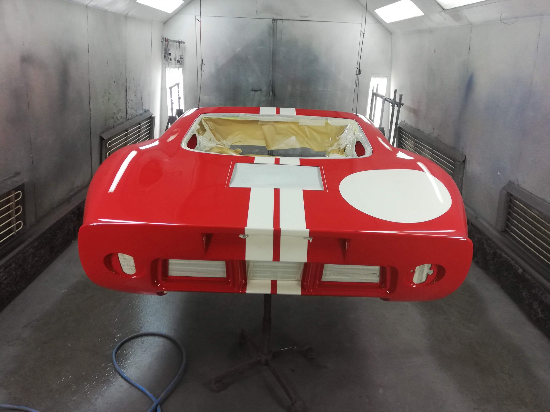

Hello
I painted my GT40 in Colorado red, color code D3
Here is some photos for inspiration.
I only find one Carnival red in Ford Europe color code D and helpcode XSC913A in my Glasurit paint code database. I couldt find any painted test for that Carnival red color.
