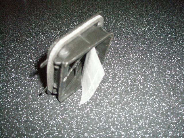

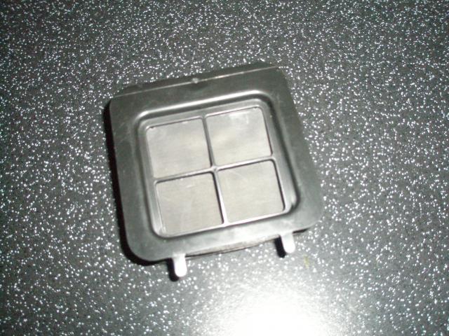

what you want are the one-way flap valves used to vent a conventional passenger car. The following photos are of a GM one and are normally fitted in the side of boot area behind the trim panel.
Regards
Andy

This is exactly what i thought of. I just would have to make a rectangular Tube adapted to the back side of the access panel in order to give the flap valve the correct inclination to close the flap by gravity.
