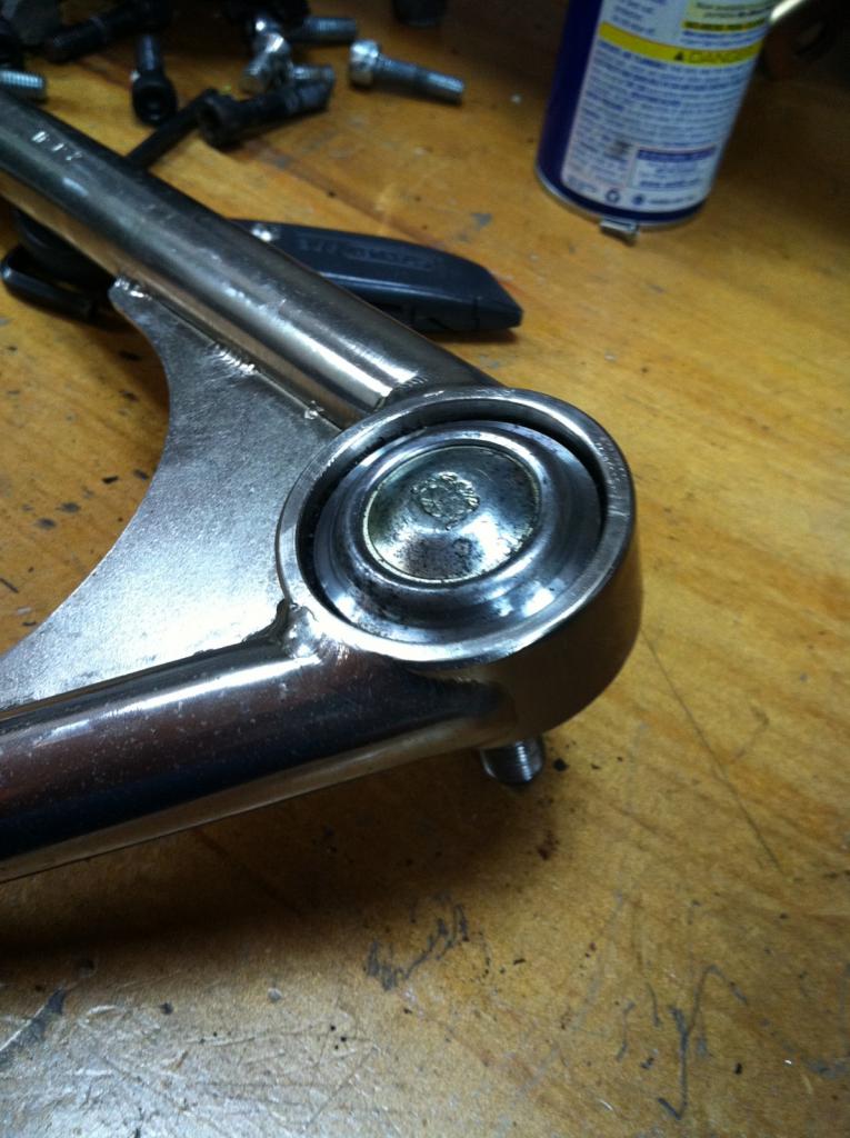

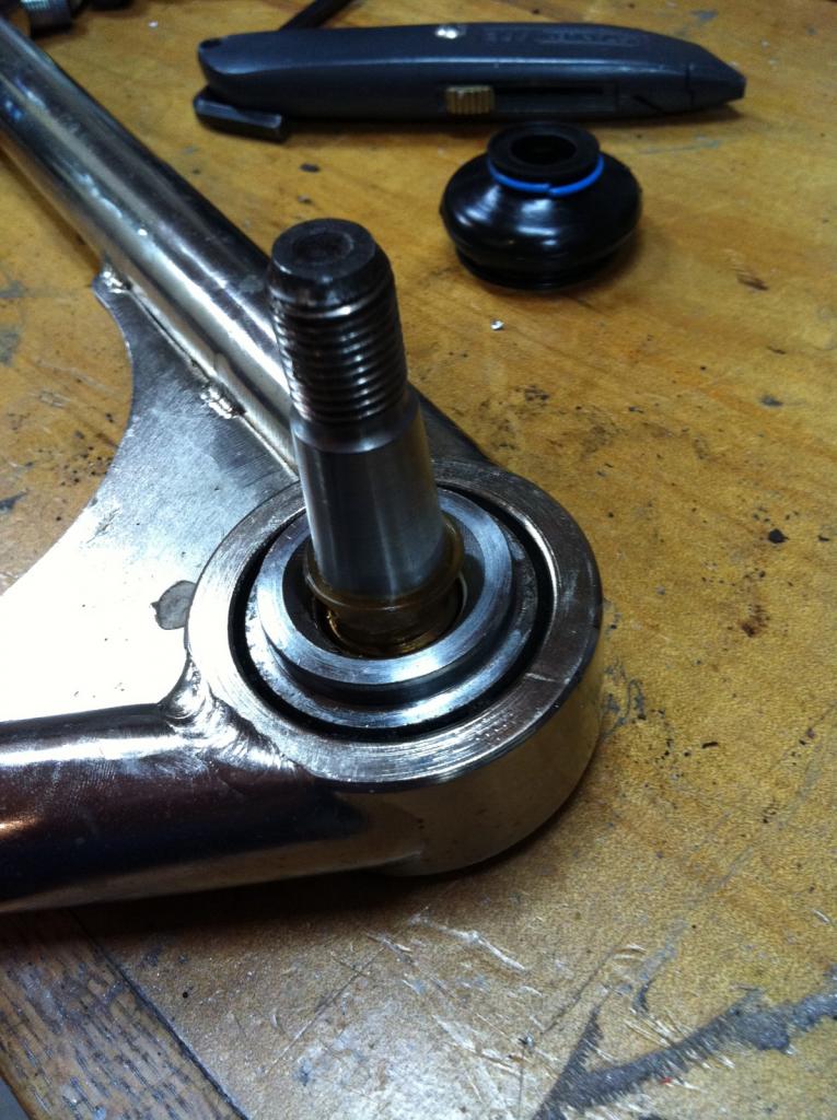

The A arms are very, very beefy, I'll say that for them. Not going to win any awards for lightness. I don't know exactly what's the wall thickness, but it feels like it's about 1/2 inch!
On a related note, does anybody know how the ball joints come out? I'm guessing they're pressed in from one direction or another. Anybody know if they're pressed in/out, and what direction they come out?
Thanks.

Hi Jim,
If you look at the thickness of the boss, that the Ball Joints are pressed into, you will be able to tell which side they were pressed in from.
As the boss in thinner at the bottom,, it is that side they were pressed into.So I would push them down, and out......Maybe someone else can confirm this

I was assuming they were bottom "A" arms, but they may be top ones, eitherway push towards the thin part of the boss, to push them out
Sorry for the confusion

Thank you Mich. You're very observant...more observant than me obviously! What you say makes total sense and no doubt that's how they go in and come out.

Cliff: Those ball joint sleeves look like the ones we use for the threaded lower ball joints. I can't see enough detail but they might just thread out.
If not, on the lower arm they will press out to the bottom as the upright pulls up on the lower joint. You need to set up a little fixture to push those joints out, taking care not to push on the bolt, but the body of the joint.

Thanks Phil, turns out (no pun intended...haha) that they're the press-in variety, but thank you for the suggestion. I stared at them long and hard before putting the squeeze on 'em. All four ball joints came out OK.
