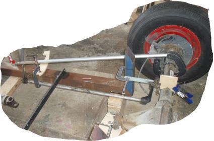

To be able for the body work to look more authentic at the rear halve , I cut off the existing leaf springs. Now installing torsion bars at the rear similar to the original.

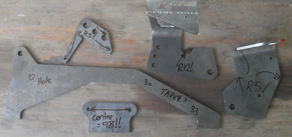

For the brackets mounting the torsion bars and Panhard rod I had a few parts lazer cut.
What a disappointment when I received them and more than 50% of the parts were out of spec. So I thought :"before I pay for them, the company will just have to do them again".

Sorry about the suspension brackets, it appears the holes were drilled before the items were bent. Soldier on my friend.

Jack well spotted, the critical holes that got reamed later on were only small pilot drilled before bending.

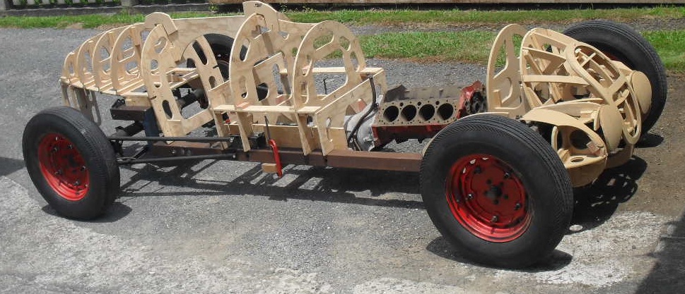

I have a rolling chassis again, however the wooden buck needs a bit of attention now, since the new steel brackets are in the way.
The eagle-eyed would spot the number 8 wire rod ends.

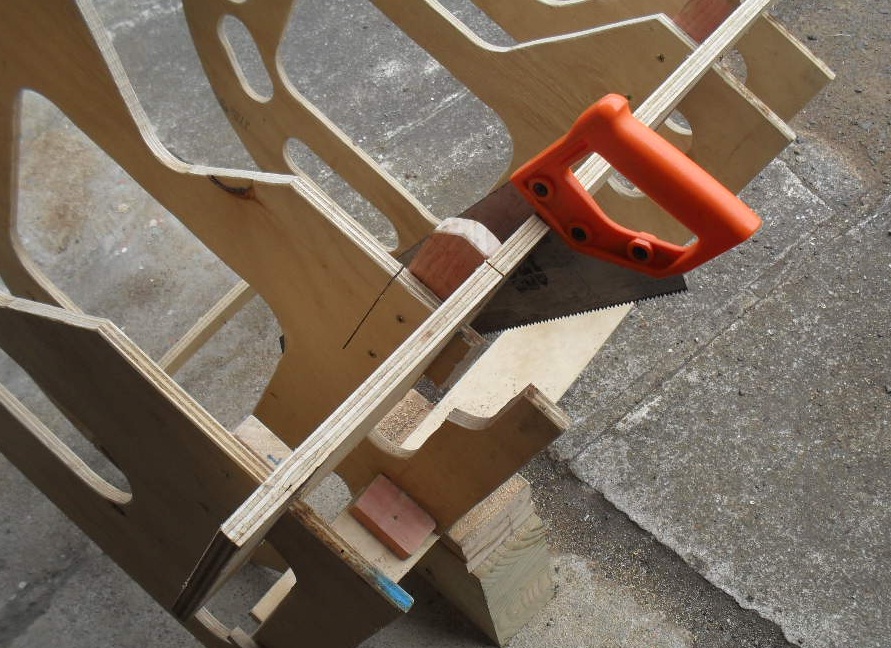

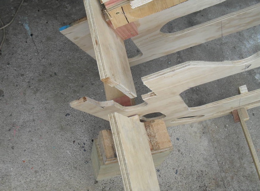

Mr. Bahco Saw came over for a visit to Miss. Wooden Buck. He gave her some of his attention and consequently left her with a gaping hole.
Now she fits correctly once again.

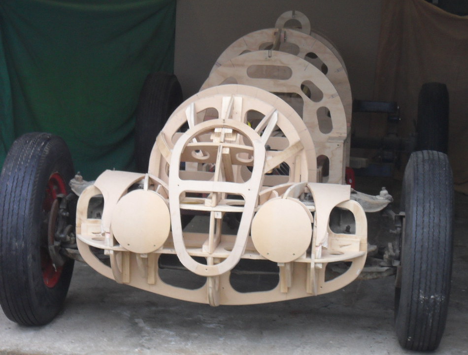

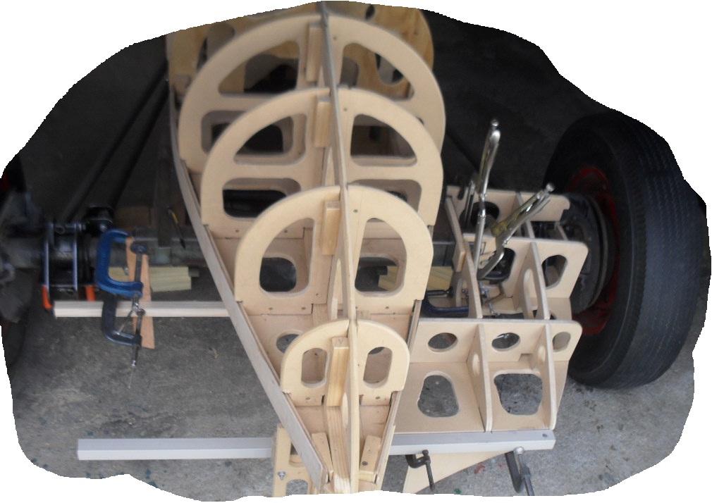

Now that the leaf springs are out of the way I am trying to get a more accurate look of the wings at the rear. The right hand buck is taking shape , though not glued yet.

I have to say, I'm extremely impressed with the wood work skills you are showing and we already know you have the alloy fab skills so can't wait for the alloy part to start taking shape. Keep it coming.

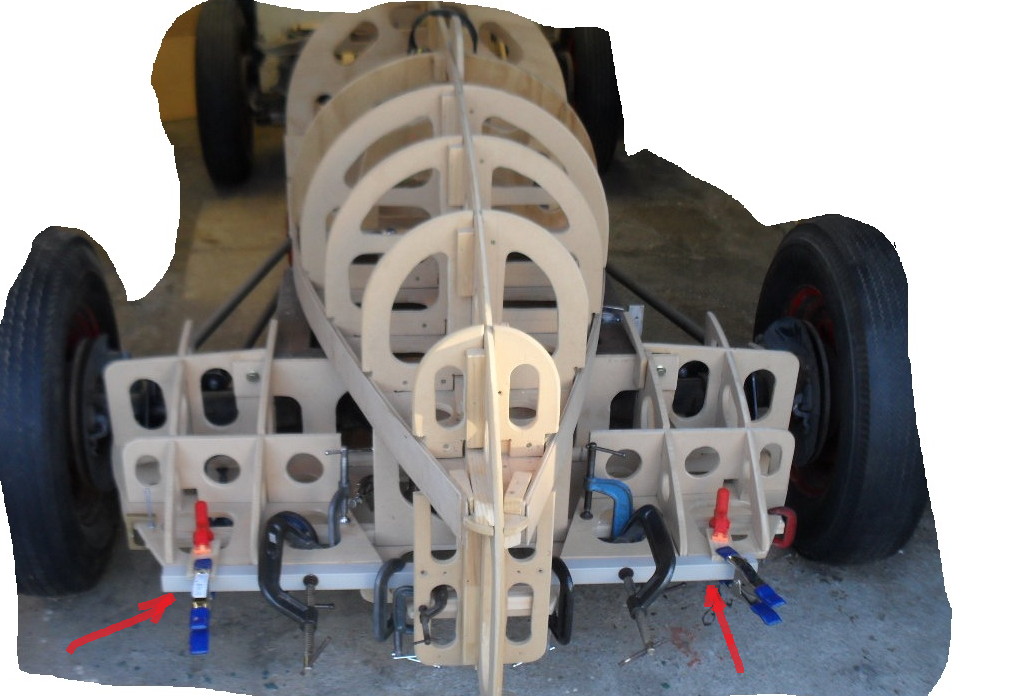

Hi guys , thank you for showing support with this project.

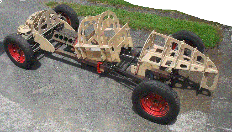

The tail buck took a lot of time, glue and patience. Those holes in the stations gives easy access to the clamps and line of sight.
The grey steel ( red arrows) is temporarily to align the left with the right hand.

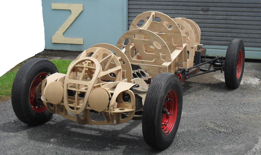

Started with the side pod.
The batten gives a reference line for a smooth curve.

Clamps, I never seem to have enough of them, long screws and PVA are my thing.
Do you have some kind of profile cutter or are you doing this all with a Band/Jig saw. your cutting seems to be exceptionaly precise. Keep up the posts, love this project.
