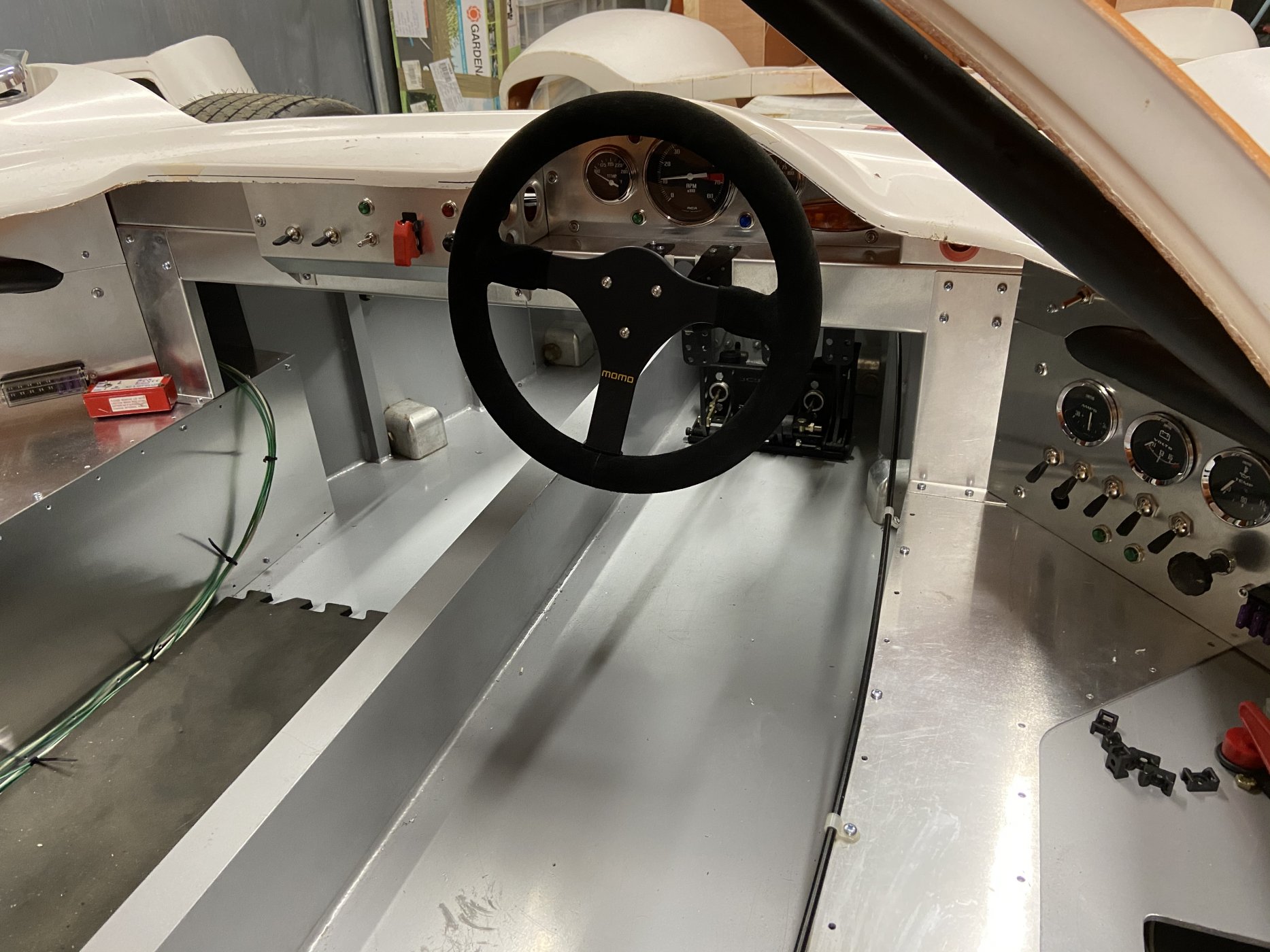

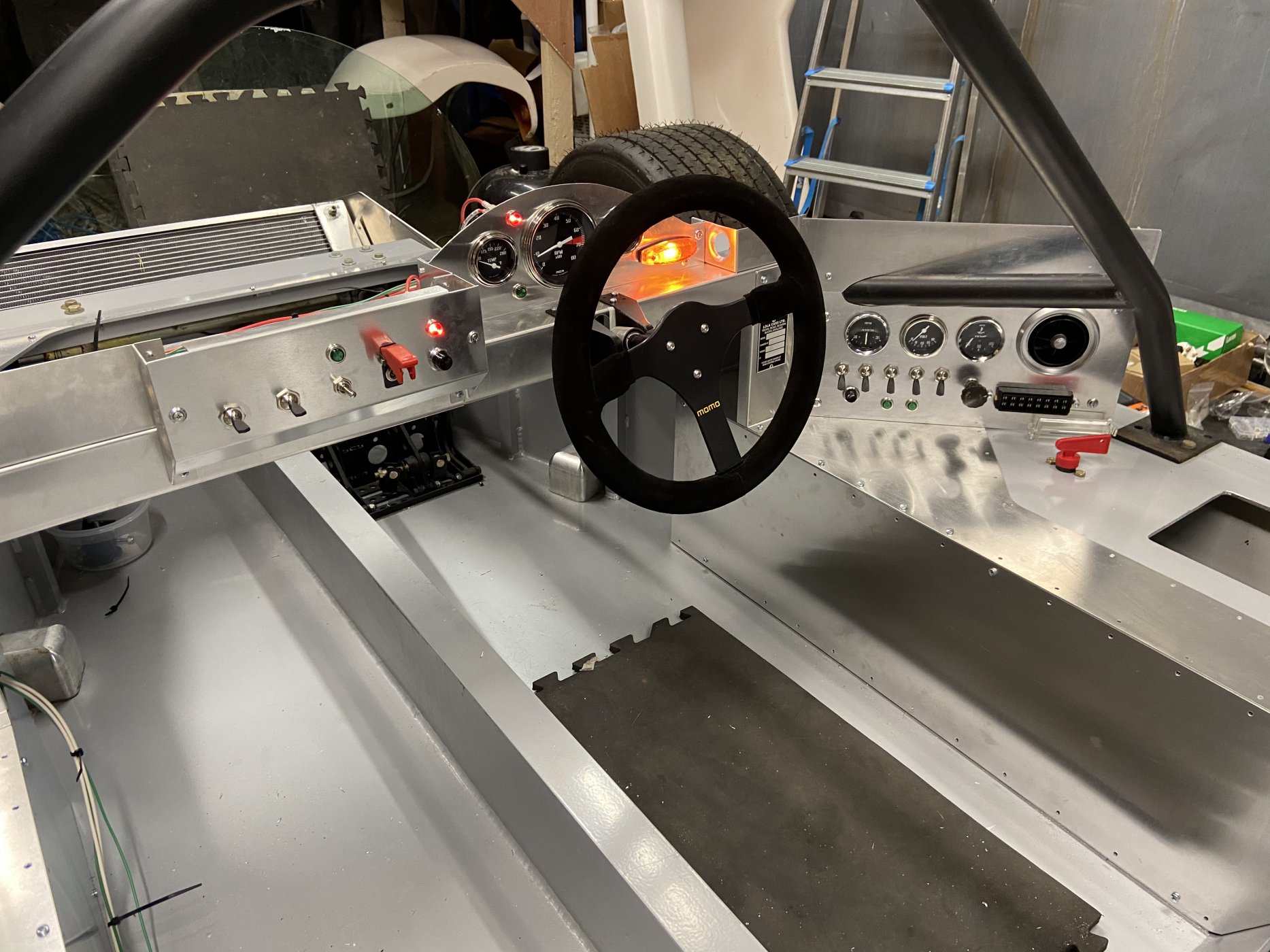

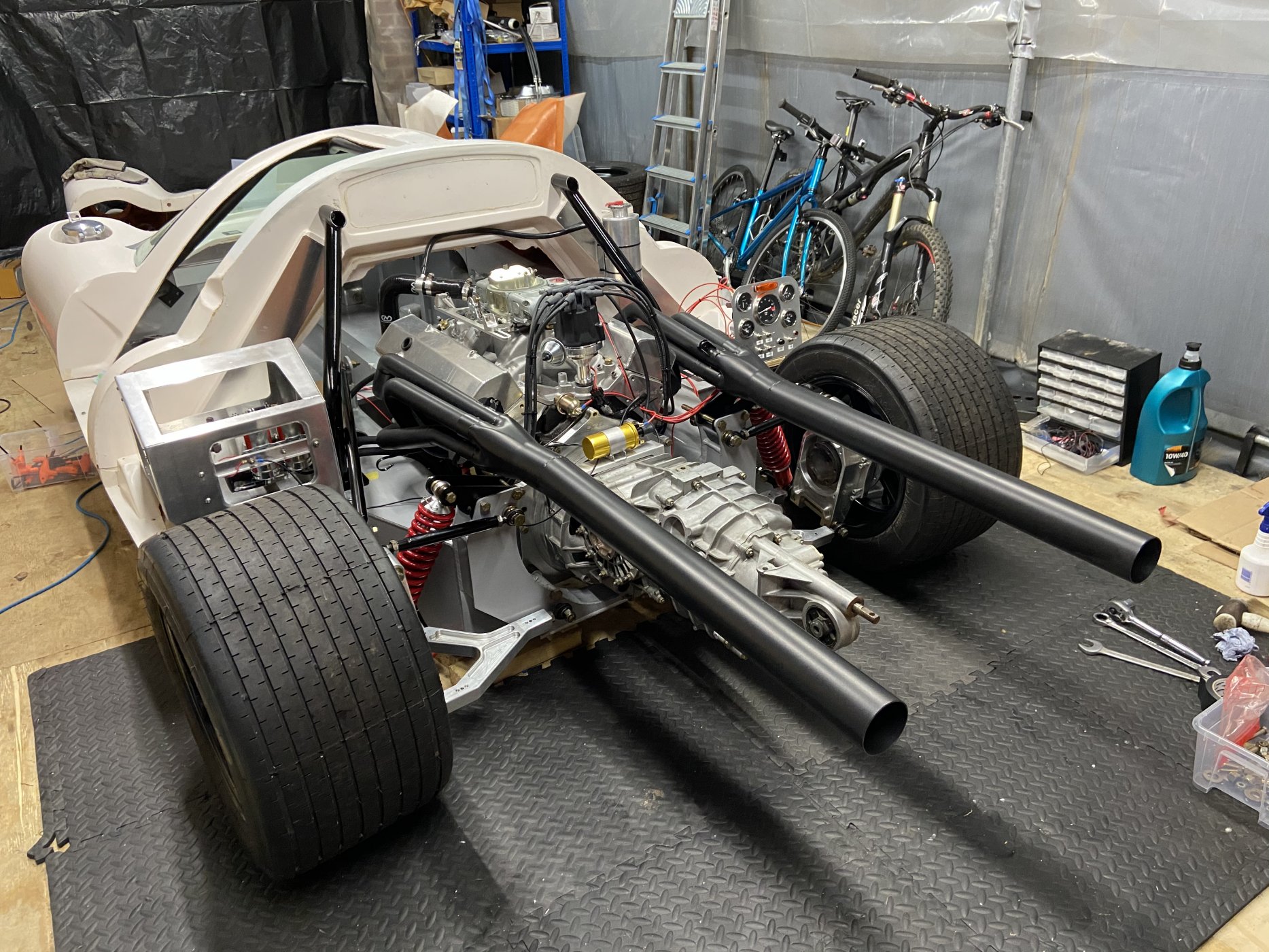

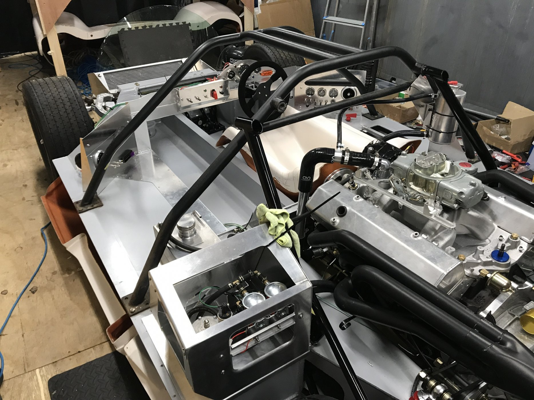

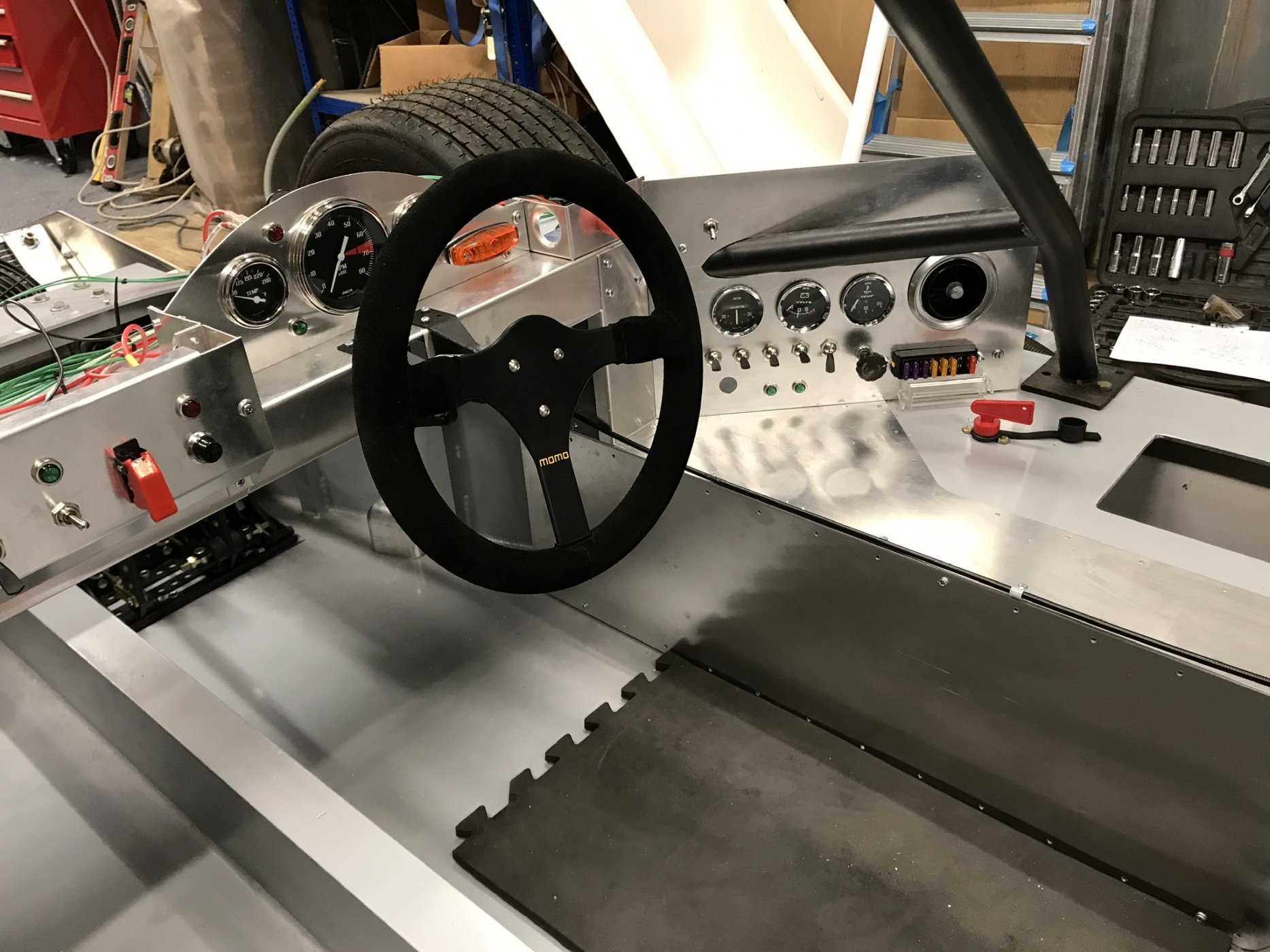

Some progress made on my build... started with the engine and ancillaries, now moving to dash and interior.
Lovely car and build Chris. You may already know, those toggle switches won't pass IVA if you are intending to put it through the test. Unless of course you have an extra extremely large steering wheel to go on :)
Regards
Nick

Really? What is their objection to toggle switches?
Regards
Nick
Thanks for the tip off Nick... 1st priority is getting it built for the track, but I did have half an eye on getting it road legal. What is the issue with toggle switches?

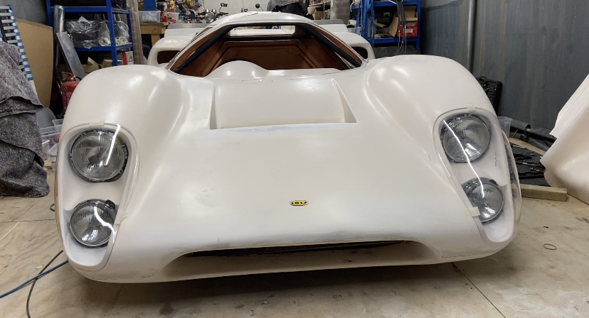

Chris, great job. Might I inquire where you got the Lola emblem from on the nose. At one time, Lola spares were going to distribute them. But it appears they are no longer trading.

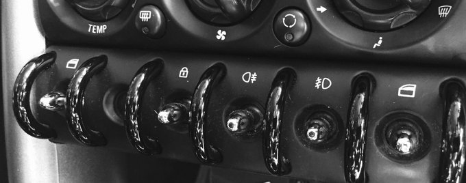

Hi Chris,
Problem is unless in the exempt area (certain distance from the steering wheel edge) they have to meet the radius requirements. For toggles some modern manufacturers such as Mini have fitted guards to overcome this, as shown in the picture.
