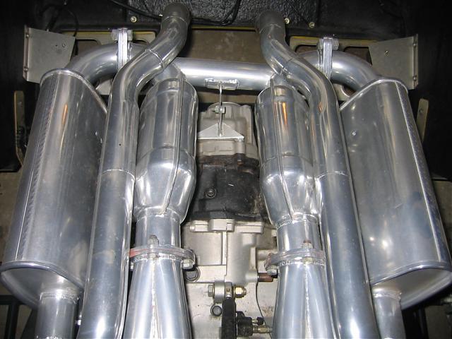

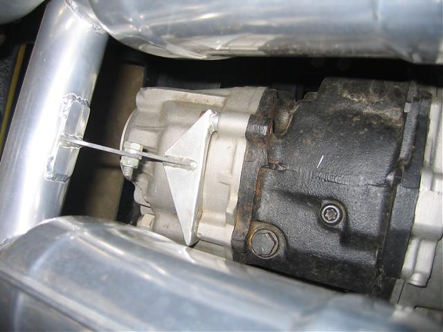

Here is my set up - done in the factory.

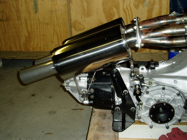

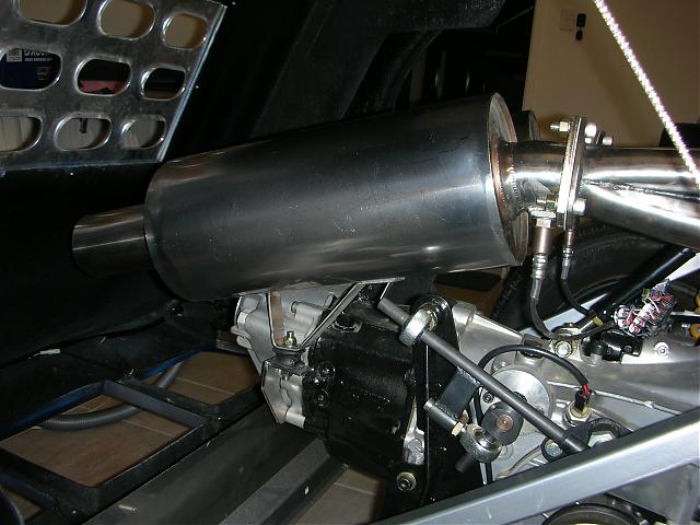

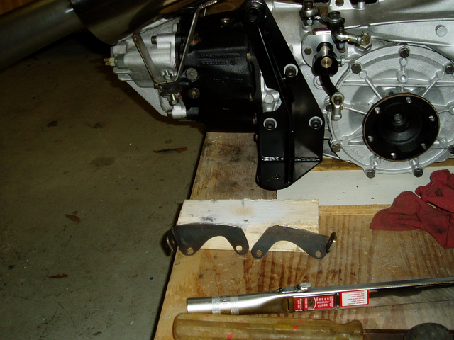

Thanks Kym, My configuration is different. Here are some pics of my system and the 2 brackets that won't fit.

For some reason the standard RF brackets place the isolation mounting points at different heights and the brackets on the mufflers are also different lengths to match. From memory I think that the drivers side mount sits lower. I manufactured new SS brackets that made the mounting points level and shortened the muffler mounting bracket to suit. I have attached the drawings that I made the brackets from. One shows the new bracket detail and the other shows the conparison between new and old. I still had some minor mods after fabrication but they were reasonably close. Hope it is of some use.

Thanks Peter, From the looks of your brackets I will need to fabricate. My brackets are made to hang from the top and interfere with the muffler support. I appreciate the photo. Someone was on the wrong page (again) at RF when they made mine. Jim
