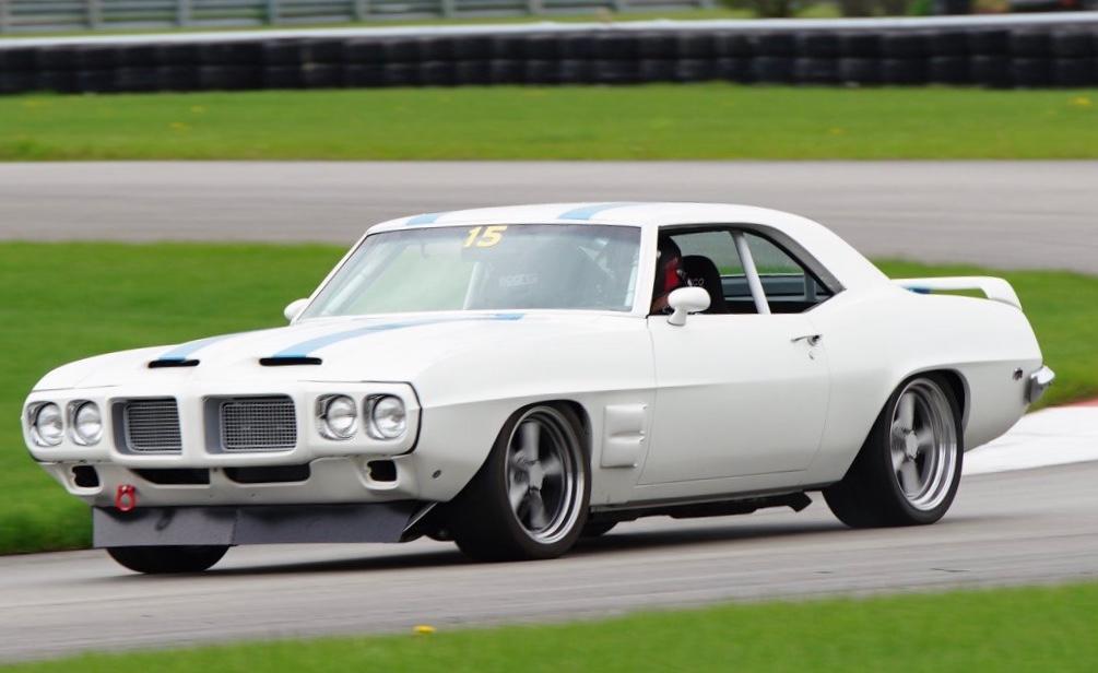

I wear one when I take my 69 Firebird to the track. I guess I'm looking more at the benefit of having a front hoop in case of a roll over accident....as opposed to relying on a fiberglass a-pillar and windshield to hold the corner of the car up and away from the occupants.

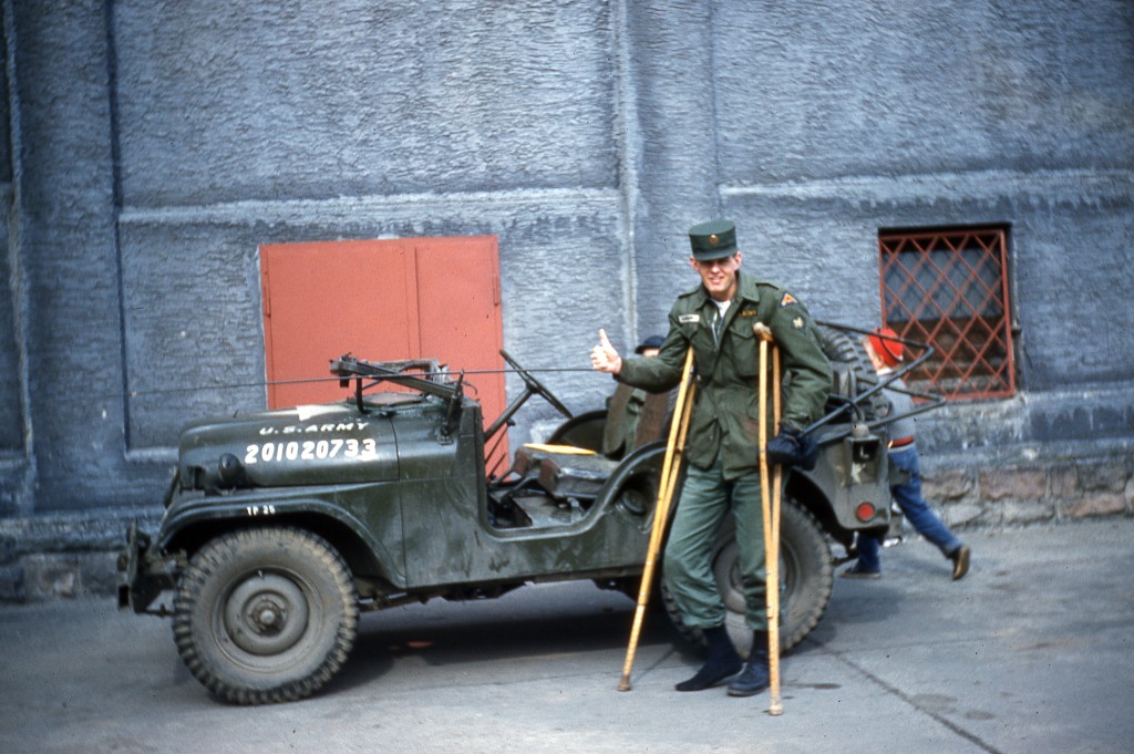

Your fiberglass A-pillar will be as much help to you as it was to me when this M38A-1 Jeep rolled over on top of me and its driver, Joe Pinto. The support for its canvas top collapsed and the Jeep was supported at the rear by a large military radio and spare tire. We were underneath it. Not fun.

Joe, go back to the beginning and rear my earlier posts. There have been several severe injuries where the steelwork stayed undamaged, but the egg inside got smashed , some fatal.

I think the bottom line is no helmet = no A pillar hoop.
