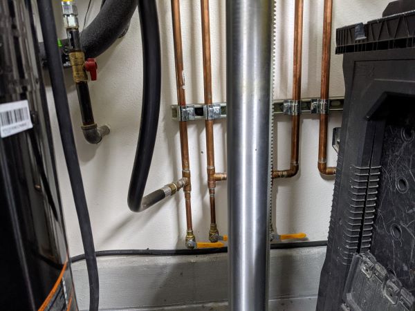

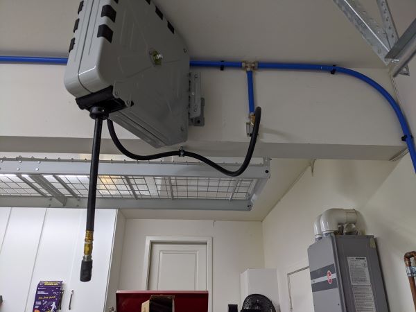

Also a little more on shop setup/compressors. I drain A LOT of water from my system and I'm glad I setup the way I did. I get like a half gallon in a week if I'm using a lot of air, and I'm in CA. The copper cooling manifold works great and I get little to no water by the time its gets to the Regulator/filter. My system goes from 3/4" proair to 1/2" hoses with high flow fittings. It took a day to do (minus accumulating things).

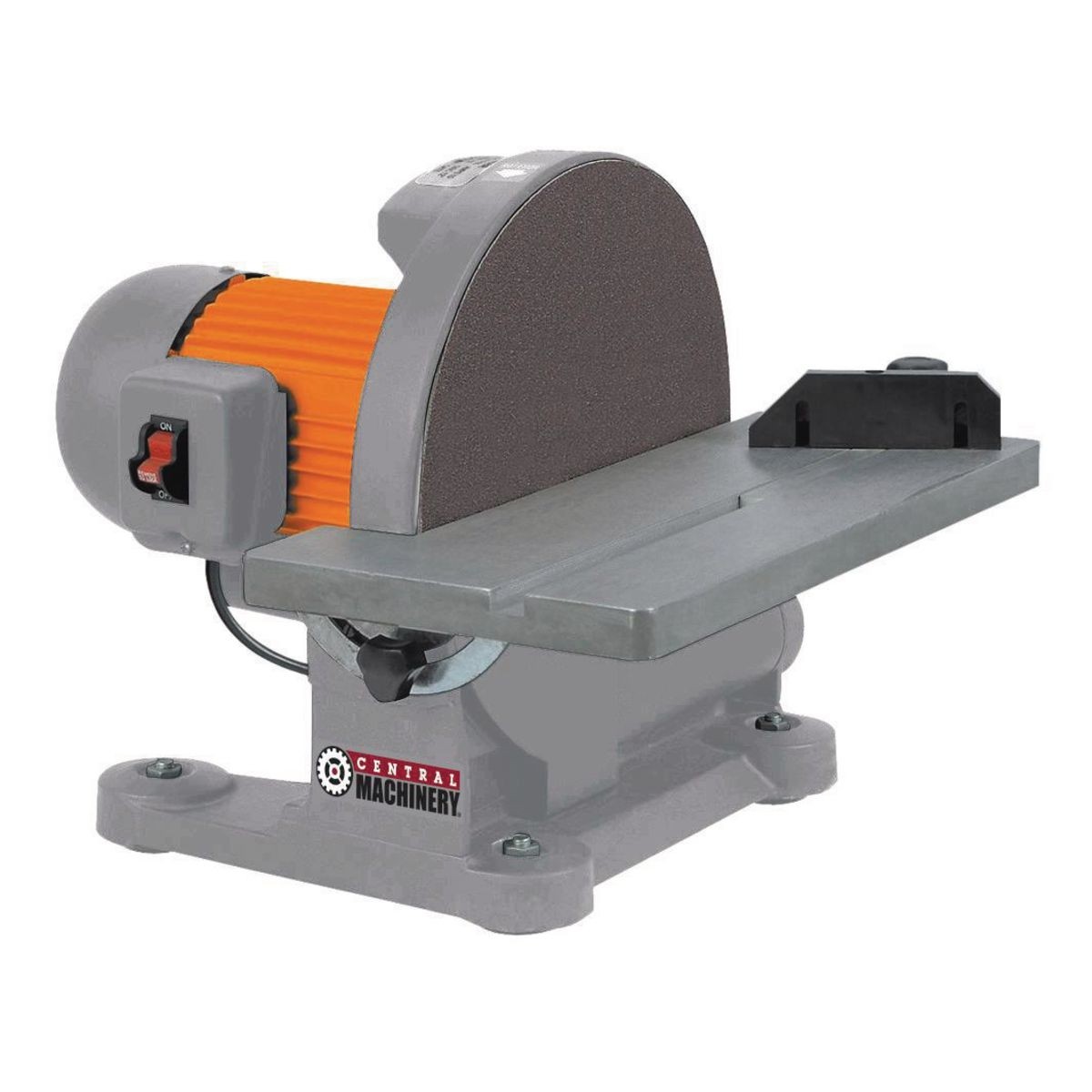

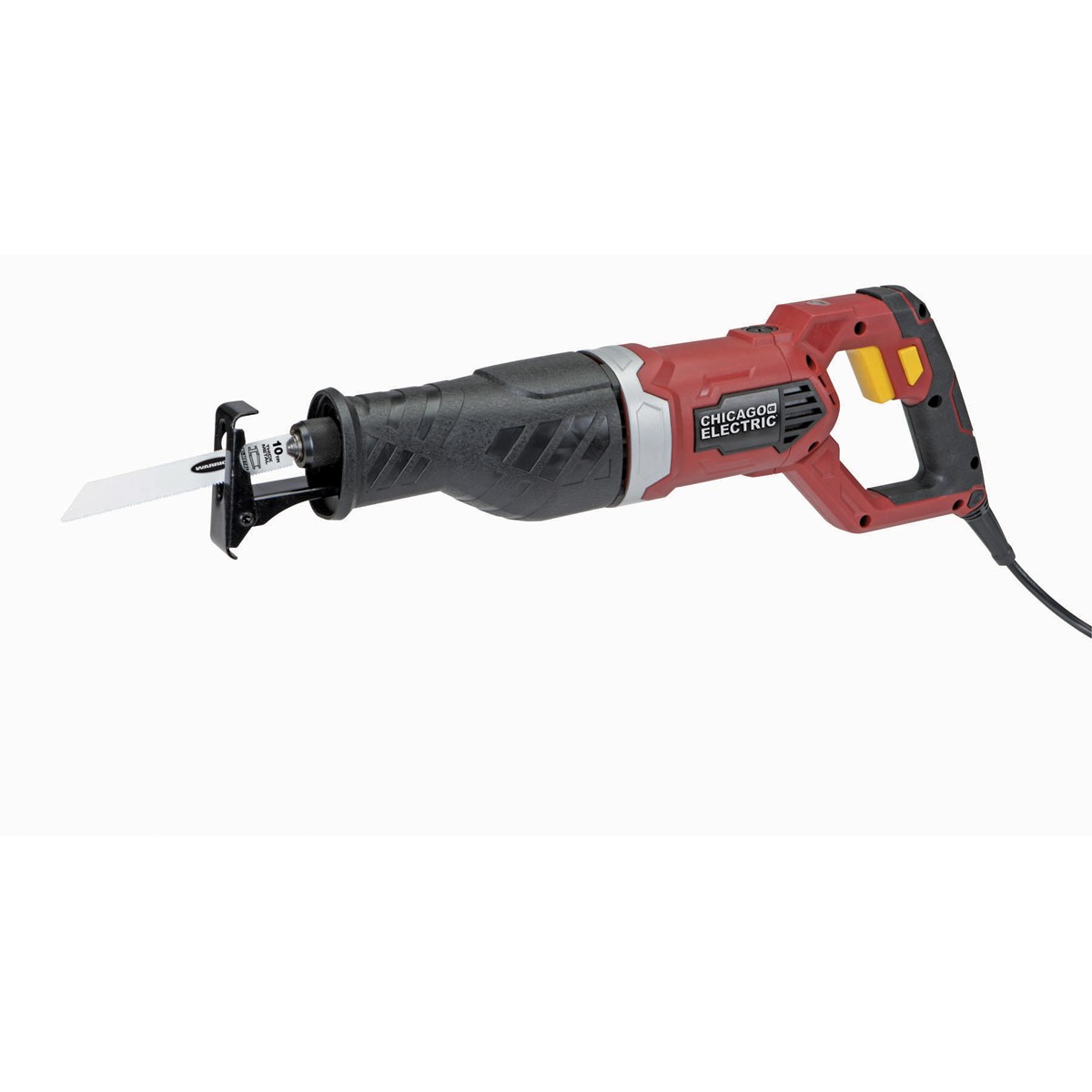

and get a disk sander and a sawzall and one of these low-profile jacks. This jack is the only jack that is less than 3 inch ground clearance (2 3/4). There are many sellers under their own name but they are all the same:

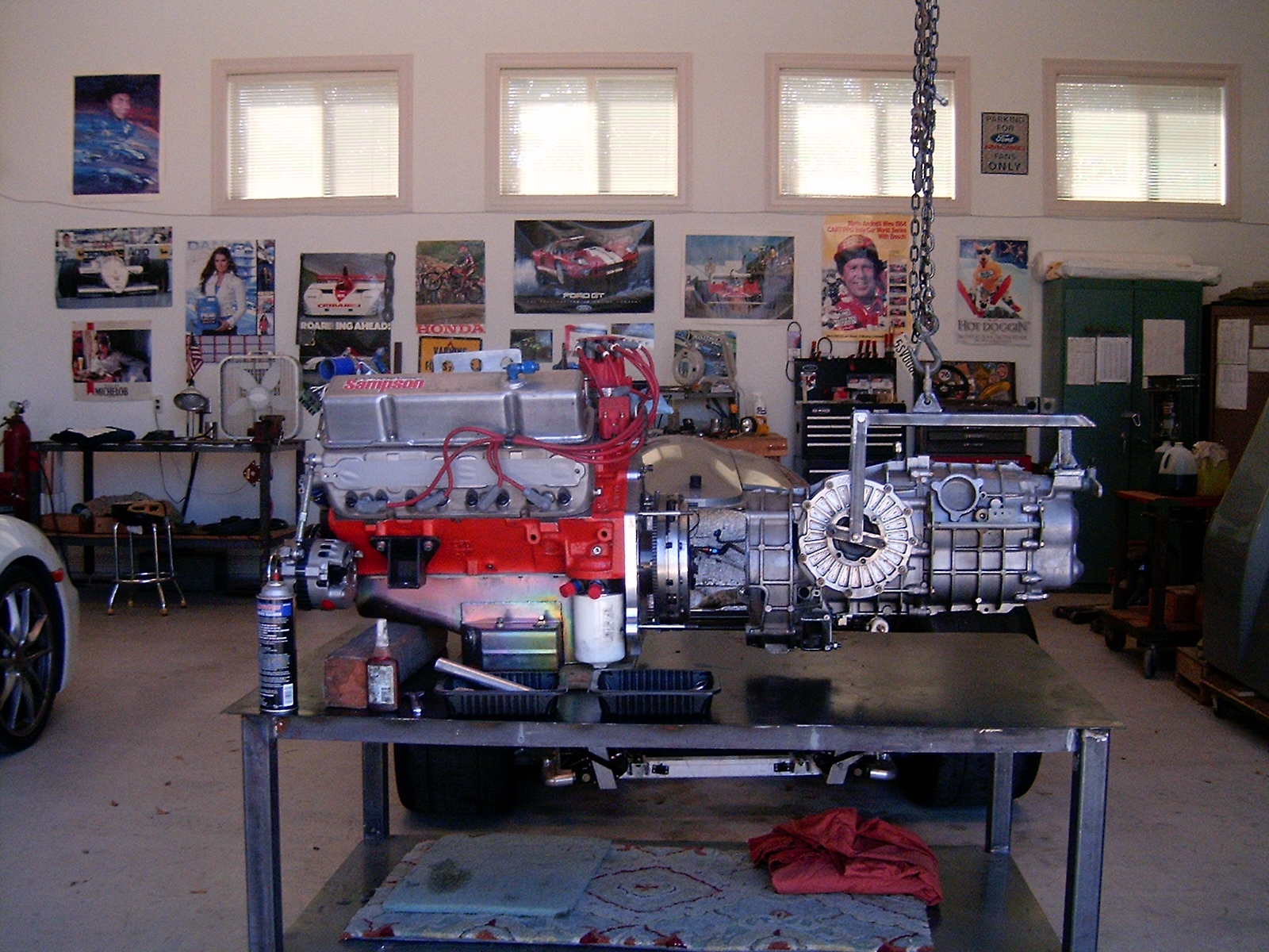

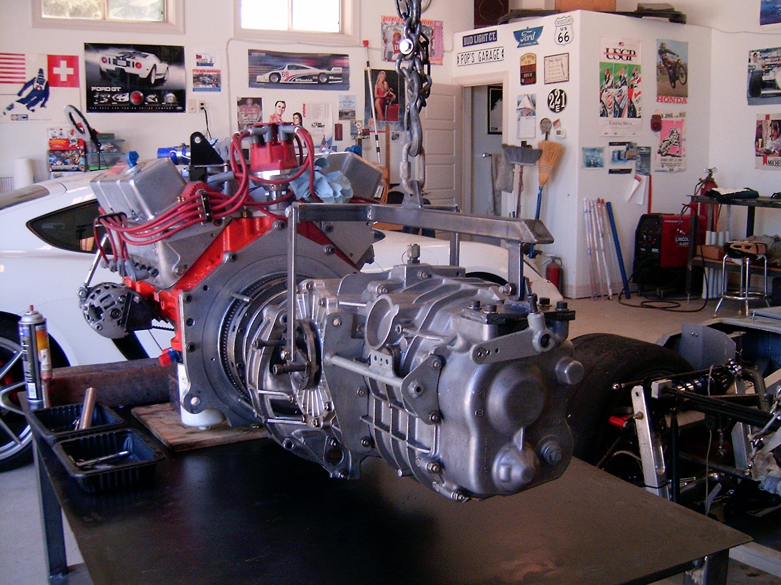

Otherwise, I really like a chain hoist to pull powertrains instead of an engine hoist as well as a bespoke table to work on said powertrain instead of on the floor. Make a transaxle mounting gig like mine now instead of later. Use harbor freight for use once things (except tubing flare tools) and buy quality tools that you intend to use for your lifetime.
is that cooling manifold just soldered together with plumbing fittings?
Steven Lobel
Question: What is PSI rating of copper pipe soldered? Love the idea.
Probably safe to 200 psi. There's a good number of variables there, so don't quote me on that. You would want to look at the copper and fitting properties in an annealed state though, as well as the quality of your soldering job. Lot's of debate on the "proper" way...I heat from the bottom rotating heat around the bottom 60% of the pipe fitting and apply solder from the top. I bend the solder at @ 3/4" for 3/4" tube to give me an indication of about how much to apply.
