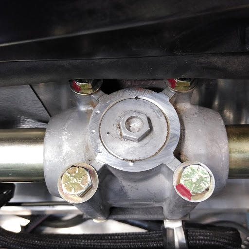

This is my second track day out with the SLC. After going off coarse at :45 seconds, every time I turn right I get this ticking sound. It is very evident at 2:07 and 2:15. When I shake the right side steering arm can I can hear some movement inside the main gold colored steering tube. The picture shows the steering box with a 14mm nut that looks like some kind of an adjustment knob. What does that adjust? What would cause that ticking sound? I am planning on racing again this weekend but I am a little concerned. Any thoughts? Sorry about creating the post "Ticking sound...". I meant to post it to my build log.
Here is the pic of steering box.

I'd lean toward pebbles/rocks jammed somewhere. I've seen where a rock is wedged near the backing plate and rotor...only makes a sound when you turn the wheel one direction and the wheel bearing slop (slight) allows contact.
That off didn't appear to be very violent - you didn't hit a curb, etc.

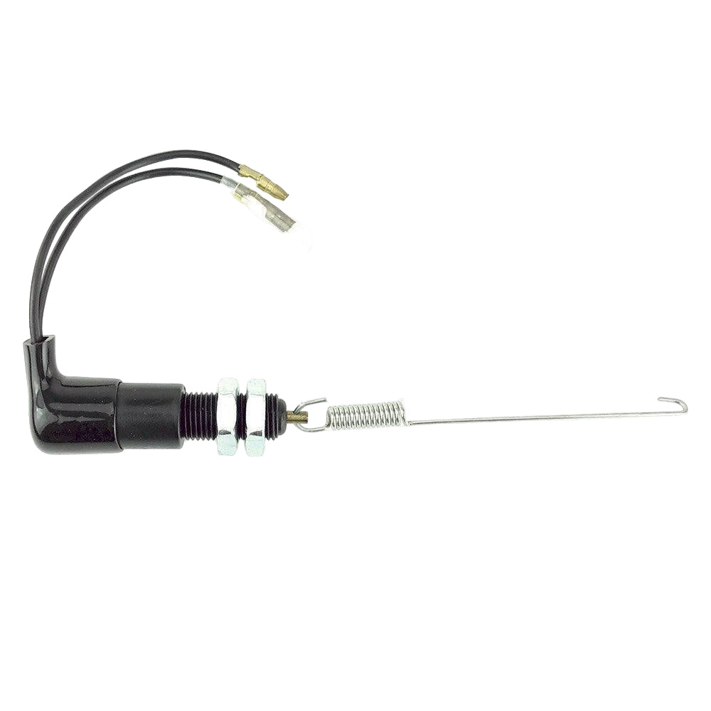

Well I have 900 miles and 3 track days on my SLC and finally had my first failure. Yesterday as I was walking out to my car to go home I noticed my brake lights had been stuck on all day. It dragged my battery voltage down so low I couldn't even jump start it. Has anyone had this problem? I assume it is the "Brake light pressure switch." If so, does anyone have a replacement part #? Will this work?https://www.summitracing.com/parts/...Tdspe0WCtgz3vQjDXgQIuEA2O4rcdKmYaAtwzEALw_wcB

Weird. I have the Painless Performance one (I think), should not be prone to failure.

Mine went out, like most everyone else's, not long ago. This is what was recommended I replace it with it, no issues.
Ian Anderson
I had two “go” on the GT40, first one sprung a leak and the fluid exited through the the electrics side
The second stopped working.
I went purely mechanical, on my pedal box I mounted a micro switch which, as soon as the pedal was pressed made the circuit, but could just of easily had it so it pulled the switch on via a spring, (mounting the firet one was easier so I went that route)
Or
Also saves having to seal and rebelled the brakes
