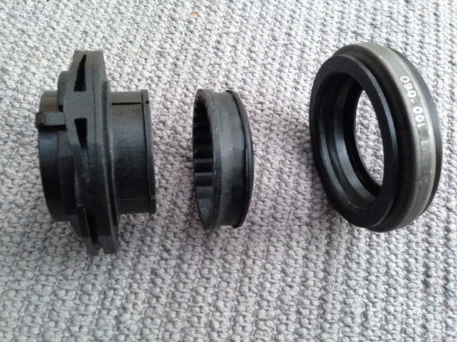

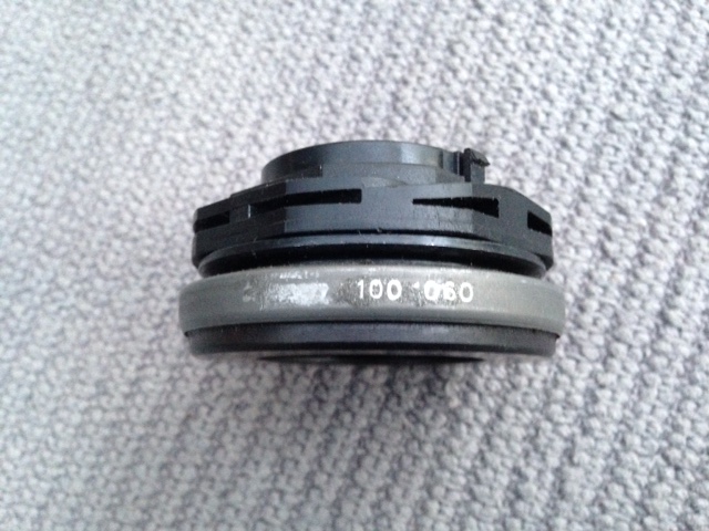

Need some help from forumites (me and Chris)
Chris ordered a 01E1411165D, which he thought he had been sent and based the drawing on the one he received.
It appears it is the one that is attached, though part of the part number has been worn off. Can anyone help in trying to
a/ Identify the full number
b/ Identify the audi/VAG vehicle it came from
c/ Even better find me one!!
currently the adaptor isn't fitting either of the two TOBs that I have sitting on my desk :(

My O1E is using AE0721237 thrust race.
I cant give you any specs on it as I dont have a spare.
If this info confuses things more then discard.
Jim
Thanks Jim :) Yes, my other TOB is 012141165E. It appears that Audi/VAG have more variations (and I thought they were meant to be the masters of commonality :rolleyes: )
If I can't source, I think I will now go down your route and stick an extender on the front.
