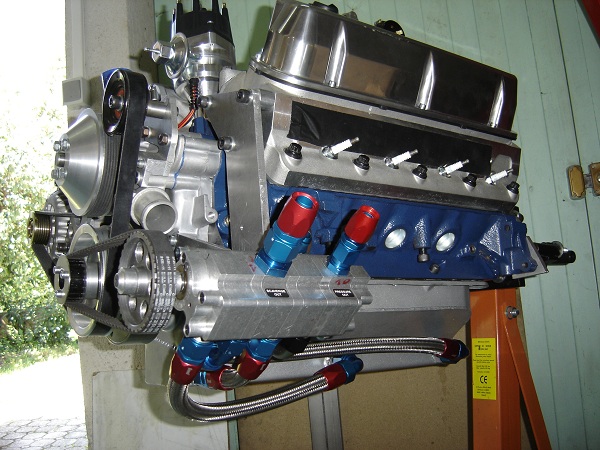

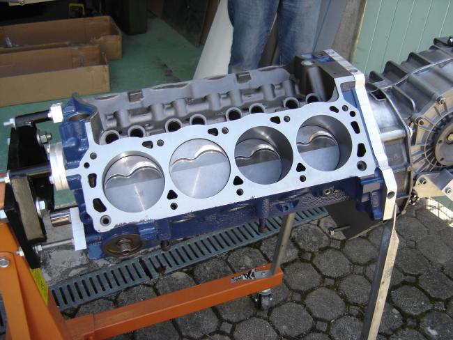

I had a good experience with FORDSTROCKERS ( Jim Wood - SBFTECH animator) for a 302/331 short block to install in my scratchbuilt GT40, 2 years ago.
From the short block , I finalized the engine with Summit parts ; Edel RPM Performer heads etc ....
Specific internal balance made on my request, fair price, delivery on time from Illinois to France and good communication during the order process.
As you will see on their site, they have of course the 347 short block version ...
Good luck for your project...
