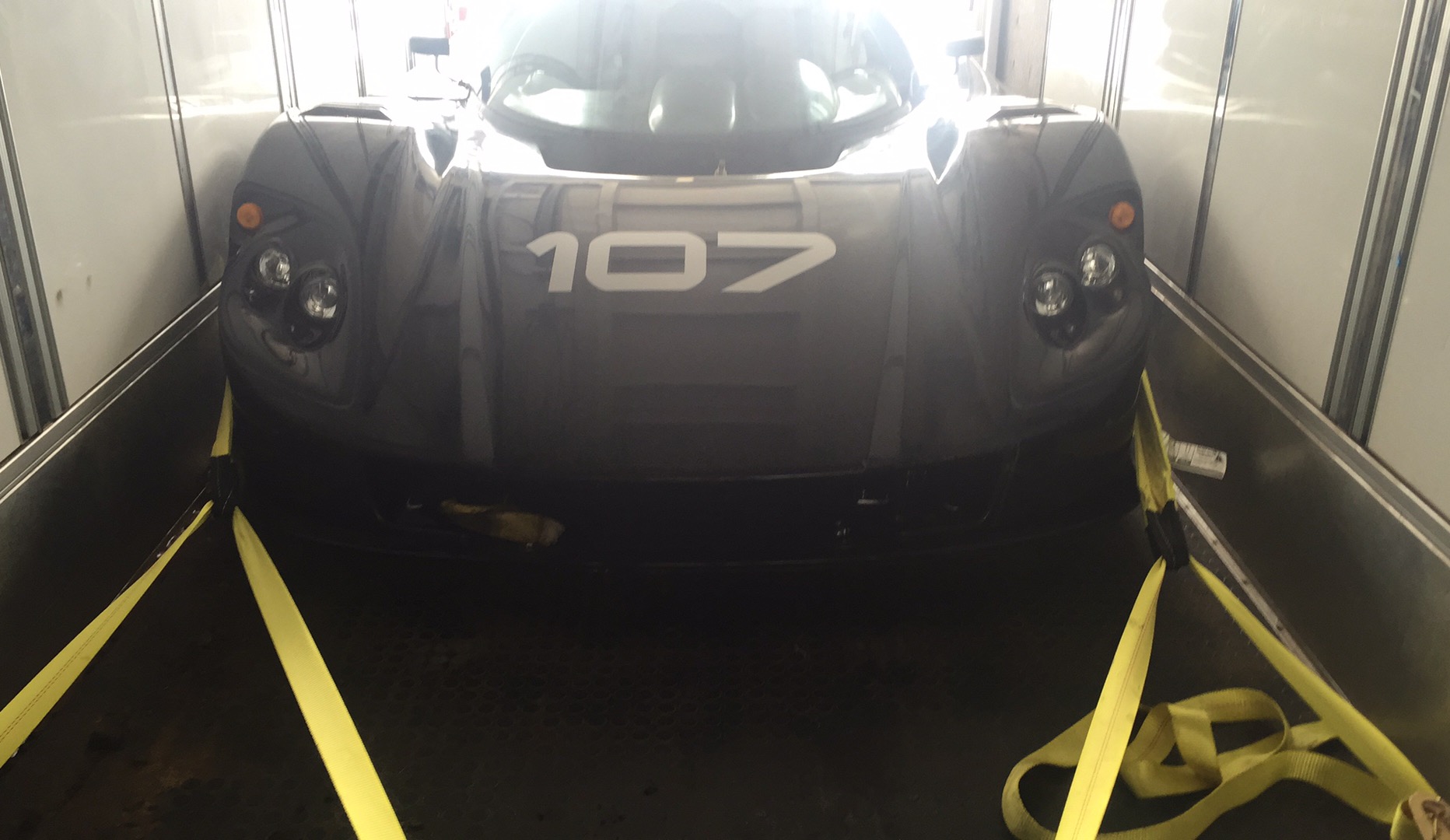

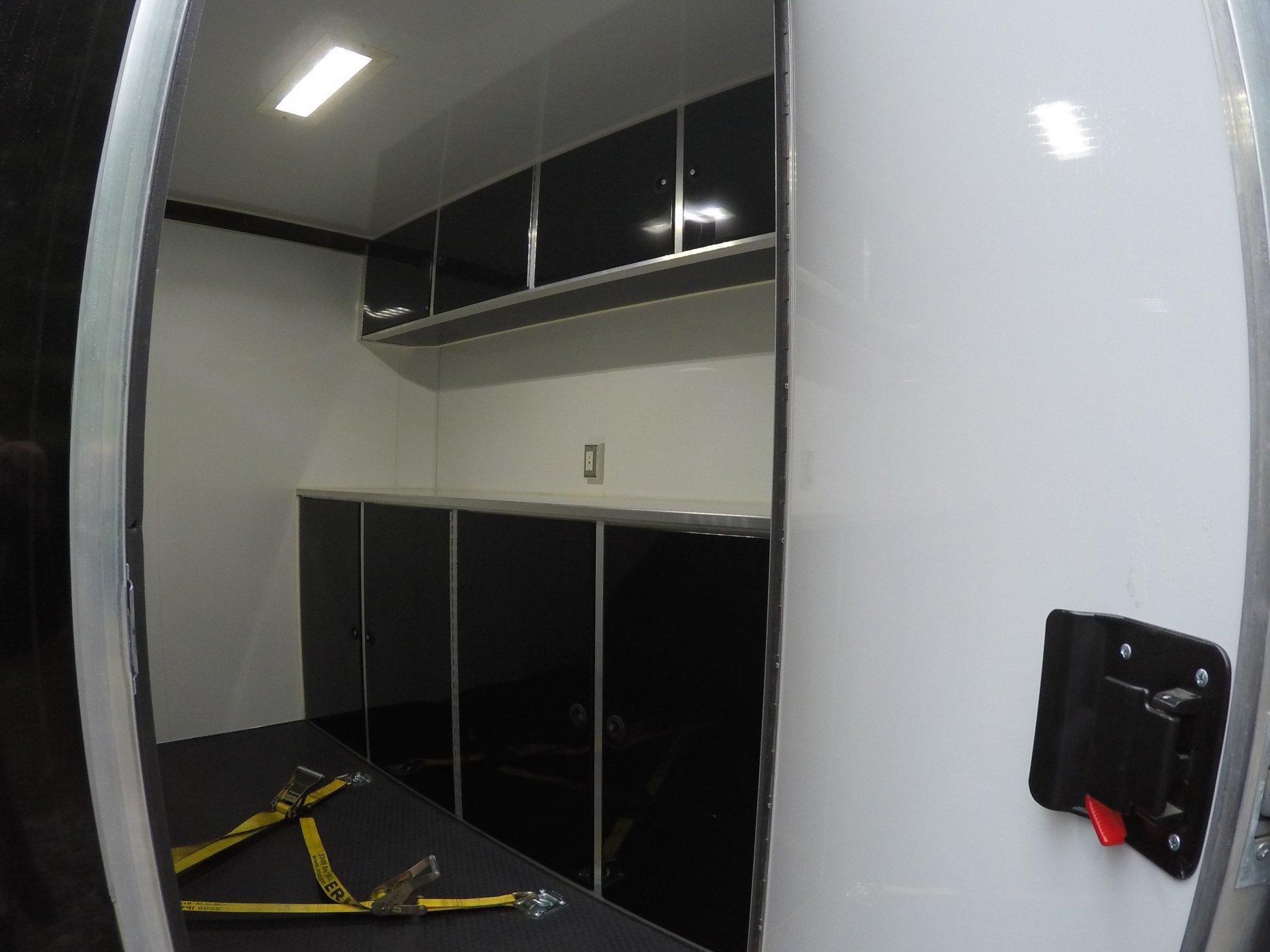

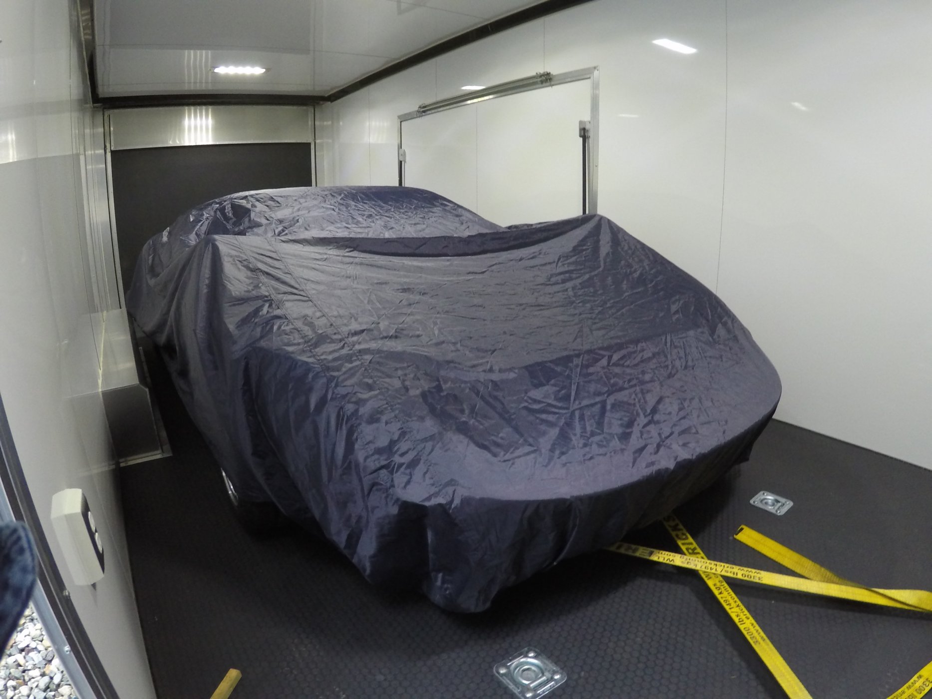

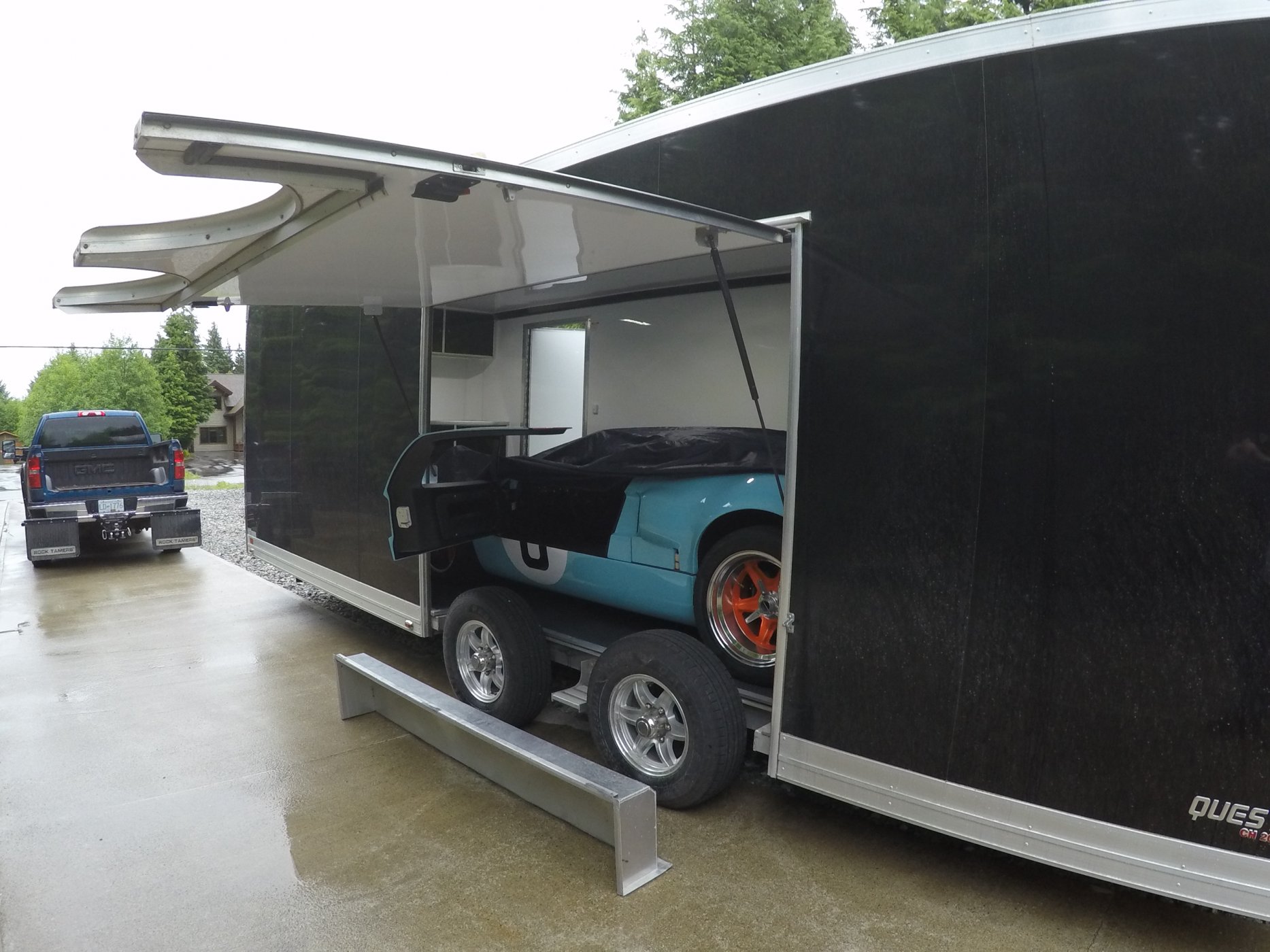

Have a look at one of these, ATC all aluminum.
If you get an open trailer, make sure that the bottom of the doors will clear the top of the fenders.
If you're looking at a closed trailer, make sure there's enough room to open the doors (some trailers have a hatch that will open to make room for the doors (like in the second photo Bill just posted as I wrote this))

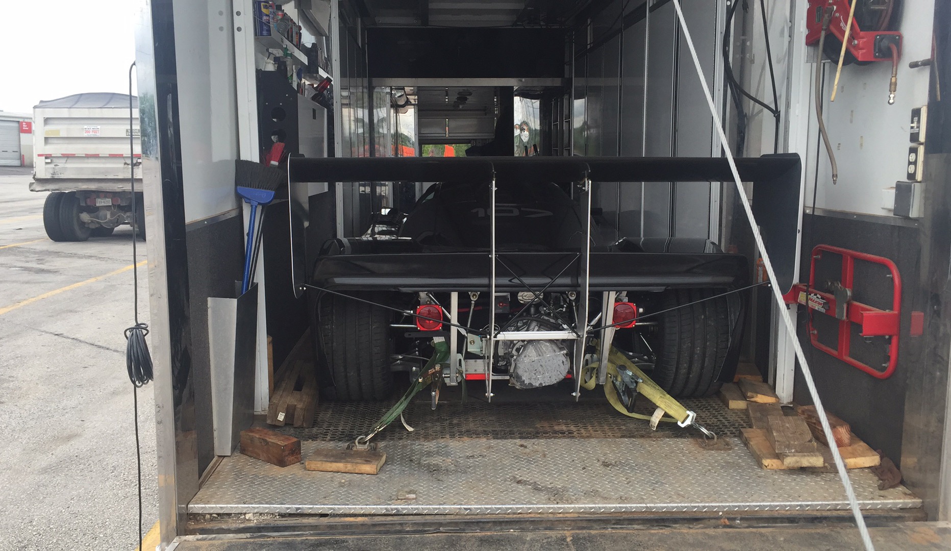

I trailer mine regularly so I'll chime in.
With an enclosed trailer, any normal person will not be able to drive it in unless you have the big opening door like in Bill's post above.
A trailer with a winch makes it much easier to load and if it's got a wireless or long corded remote it makes is a pretty easy one man job.
With any trailer you will need long ramps. Higher the deck, longer the ramps. I have the front lift - I'd never get it on a trailer without at what I run as a "normal" ride height.
The doors will clear most car hauler fenders - much better chance than the average sports car.

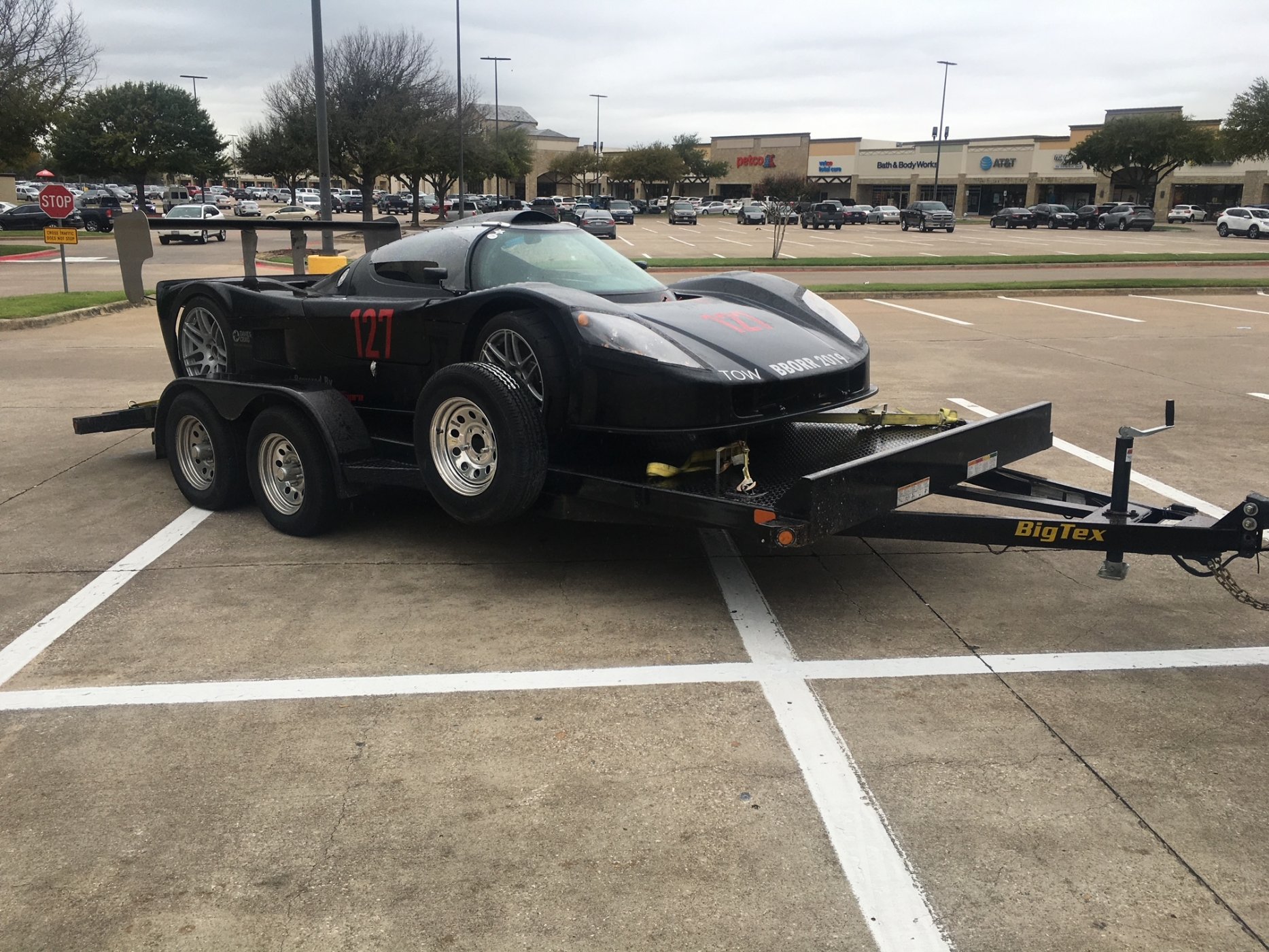

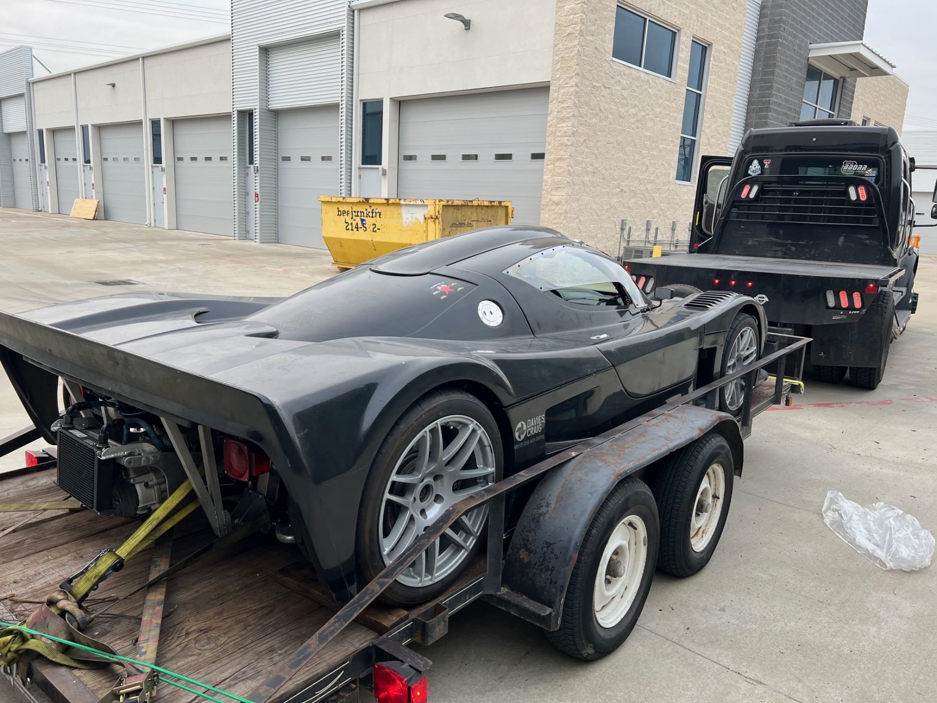

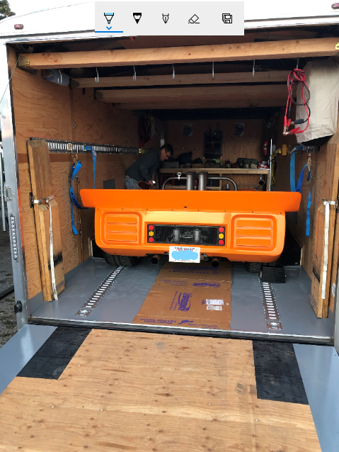

I'll attach some pictures with a few trailers. The utility trailer is HIGHLY DISCOURAGED. It fit with about 3/4" to spare on each side - no winch so drove it up. The white trailer is my Stacker/Sprint Car hauler (hence tight at the front and lots of room at the back). The back of that trailer gives you an idea of how much room you could have with a max width enclosed trailer.
I am actually looking to buy a car hauler similar to the one I rented - it would supplement my stacker for those times I don't need to take the kitchen sink with me. The rented car hauler is from a small local company (advertises on FB). $100/day, $350/week. I rented it for a week to haul the SLC to West Texas - saved more on fuel than the rental cost.
Sprint Car/Stacker:

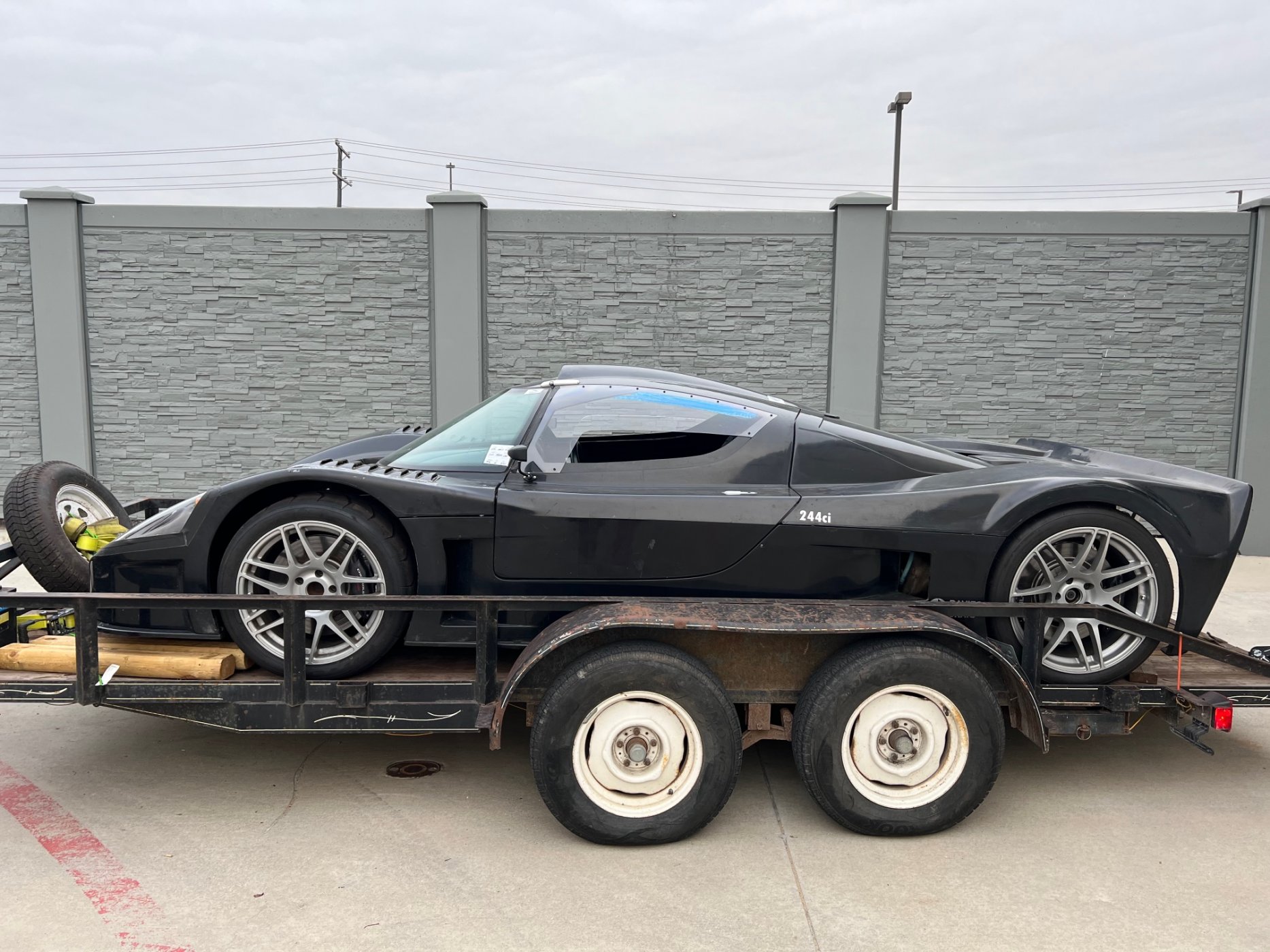

Utility Trailer:
Rented car hauler:

I'm in the same situation, Jeff. I don't do any multi-day trips (except when I hauled the car across country when I moved). I went with an Eagle aluminum 16 foot bed trailer with a wood deck. The deck is relatively high at about 2 feet or so, so I had to buy a set of the longest race ramps to get the car on (trailer came with 4 foot ramps). I also later welded up a winch bracket since I'm usually loading it on my own. It was only about $5K new, but you can find similar sized trailers in steel new or used for a lot less. Non-removable fenders, but for the SLC, door to fender clearance is great, but a corvette, Porsche, or something with normal, low doors may have a challenge.
The other thing to keep in mind is tongue weight with a mid-engine car. I have to pull the car forward as far as possible to get enough weight on the tongue since the car is so rear-weight biased. On mine, I have to get the rear intake ducts basically centered over the trailer wheels which on a shorter trailer would be impossible.
