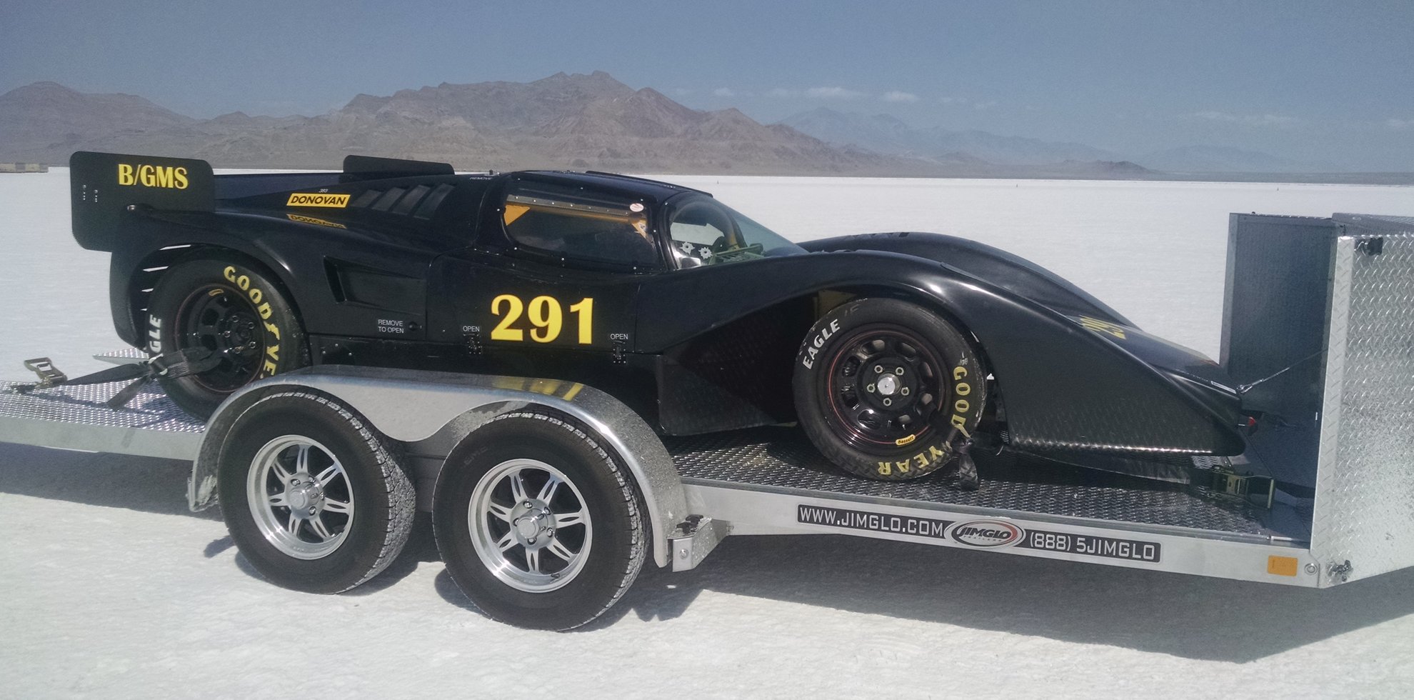

After renting open trailers and struggling with the heavy steel ramps, blocks of wood to get the loading angle lower, etc., I broke down and bought an all-aluminum 18 foot tilt bed EGO trailer from Jimglo. It is light weight and well constructed. It is so much easier to tow than my old 24 foot enclosed Haulmark trailer that I finally sold the Haulmark. I have been very pleased with this trailer. The options I wanted were a "standard build" for Jimglo so that saved a few dollars. Main options were a built-in winch and battery, 7,000 lb axles, a wind deflector and storage box (including spare tire), and LED bed lighting. The 18 foot trailer has an 8.4 degree ramp angle. They also offer a 16 foot version with an 11 degree ramp angle. If that is enough clearance for the nose of your GT40, it would be less cost than a longer one. In my case, my car has a 3.5" front ride height but the 4.5" rear ride height gives the car a downward slant so its nose is probably lower than a GT40. Here is a link to the specs page:
https://www.jimglo.com/ego-specs
BTW, Jimglo builds the trailers that Ford used for its Ford GT concierge service- a pretty good recommendation.
Regards, Neil Tucson, AZ

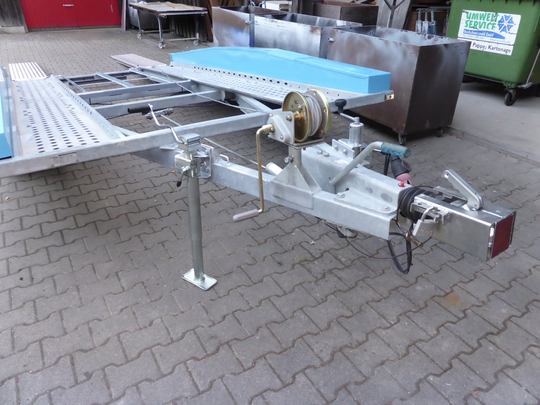

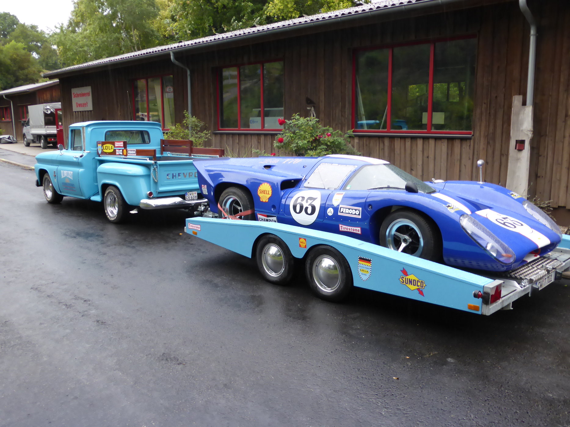

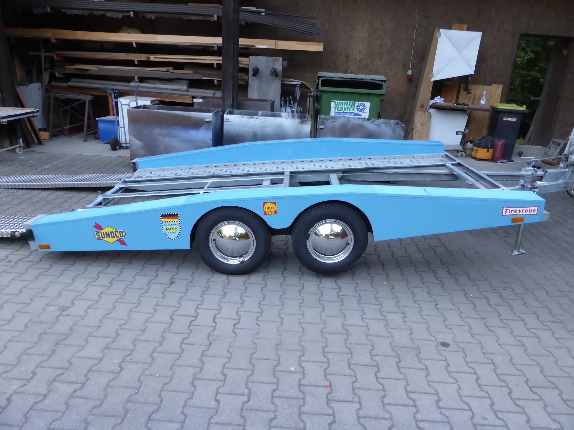

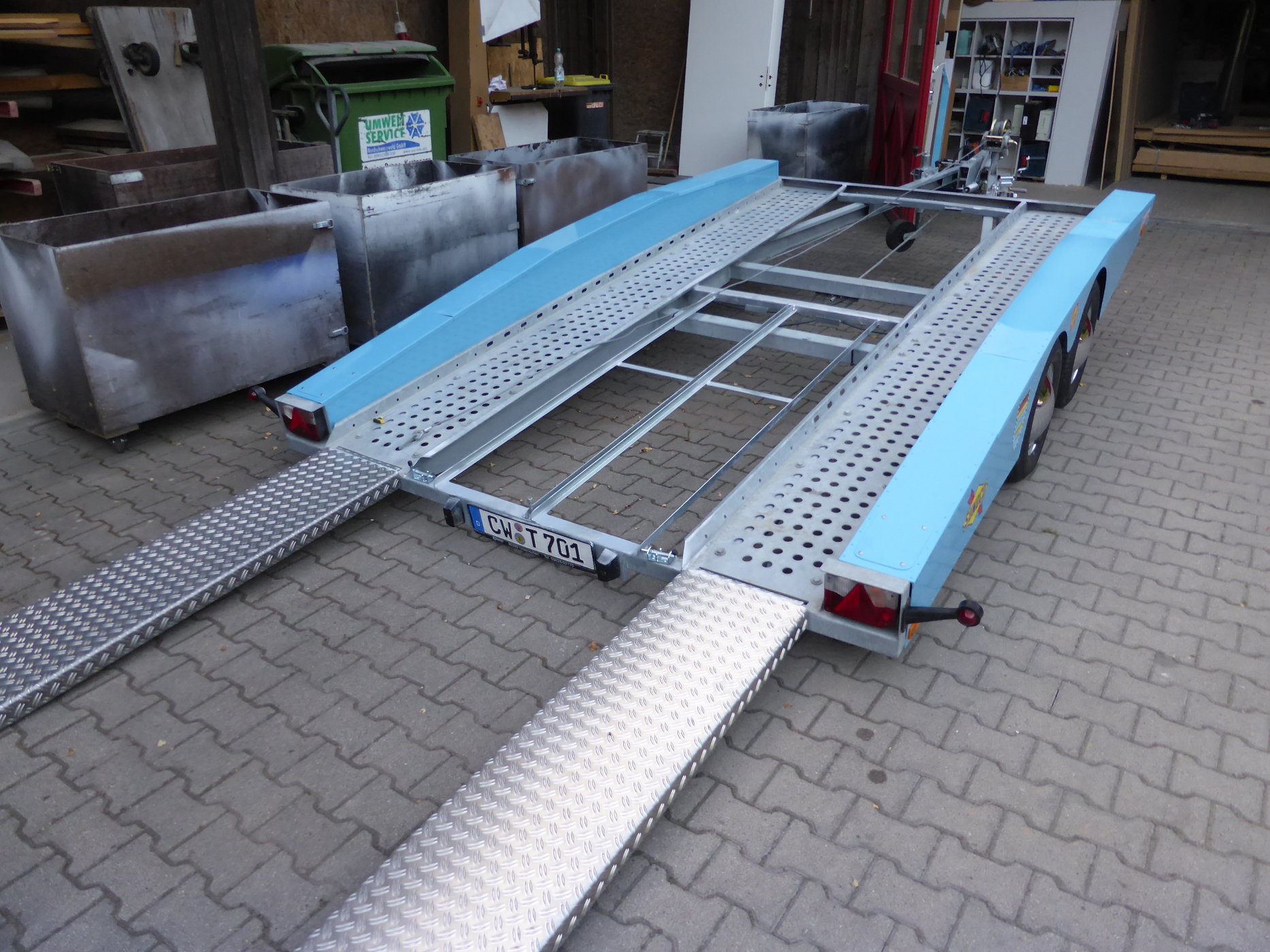

hire my self made trailer to bigest racecars
gruß meinolf
