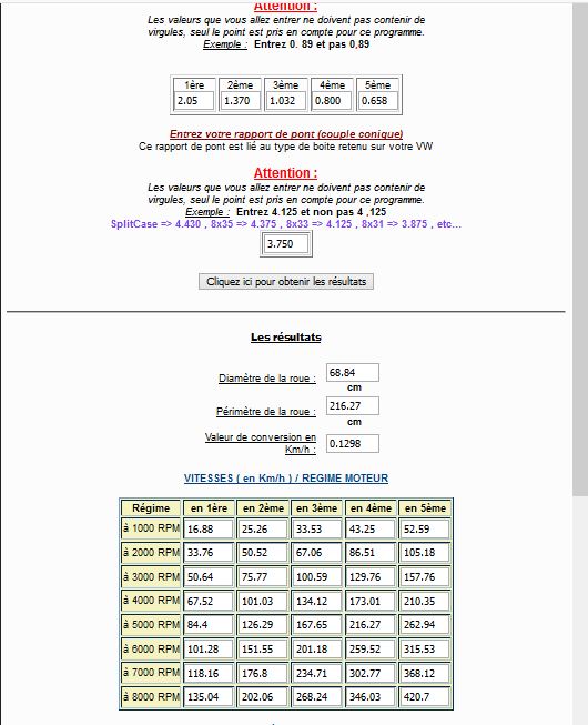

Hi all,
I just build a simple road going car, no fancy motor or things like that... juste a car that can idle in traffic jam, not overheat, gets me where I want & back...
for many ( some times crazy) reasons I use 16 inch wire wheels and tires an Audi gvd gearbox , and with à practically standard iron lump in my back I aimed 80mp/h (130km/h) what is the maximum legal speed in this country the engine runs 2450rpm ...
when you see my theoretical sheet at 7000tm..... I should overtake the Bugattis ....
if you dee my sheet the Audi box is gvd 6speed whit vey long ratio , and a to short 1 gear which I would not use , perhaps only parking moves etc.... that's why you see only 5speed ratios . sheet is in km/h and centimeters for sizes

By my calculations
At 7,000rpm (if 100kph at 2,250 rpm is correct) the speed would be 311kph which is 193mph.
