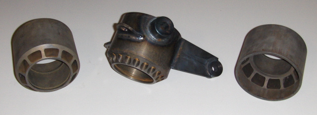

Ian Clark
Wow, thanks for jumping in on the uprights guys! The parts perform on all counts and the peace of mind is priceless.
What motivated the new parts developement in the first place was performance - reduced unsprung weight, improved geometry and control of the contact patch, dial-in alignment instead of shims, reduced heat soak in the bearings and CV joints, plus the parts just look "right".
The safety aspect arose from cars experiencing cracked or broken castings (can happen to any make of car), bent or broken lower clevis pins, binding in the rubber bushes causing the rear in particular to be twichty when pushed. Doesn't matter if the part breaks and you're off the road or you loose it to unpredictable handling, changes had to be made.
Our steel uprights are lighter AND stronger than the aluminum parts they replace. All verticle loads have been removed from the lower clevis pins as well. Some of my previous postings discuss the design advantages in more detail.
Certainly in the post 100 cars Autofutura has made tremendous improvements in the strength of the uprights. As the original CAV company was wound down, they did not have the opportunity to address the issues which only became apparent as more cars were completed, particularily with more motor and rubber than intended.
There's 48 uprights out the door so far, zero failures and 100% delivery on performance expectations. Even Dave Briggs car which went into a tree at 55mph did not break our upright even though it was in the line of fire.
Thanks again guys, developing parts for a niche market has it's challenges but it's really rewarding to have the customer feedback on how well the parts worked.
