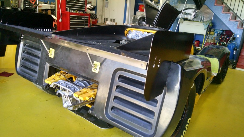

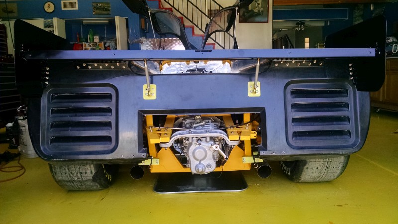

Will need to look for the pictures. Use a sling that threads through the rear extension by the quick-jacks and hook the fairlead to the the eyes of the sling. You will need a sling about 5 feet long to do this.
Neil
My Porsche G50 has a cast aluminum transverse rear mount that I use as an anchor for my tilt trailer winch. It requires only about a 3 foot sling. Winching a mid-engine car on to the trailer bed from the rear places its center of gravity forward on the trailer, producing more favorable tongue weight on the hitch.

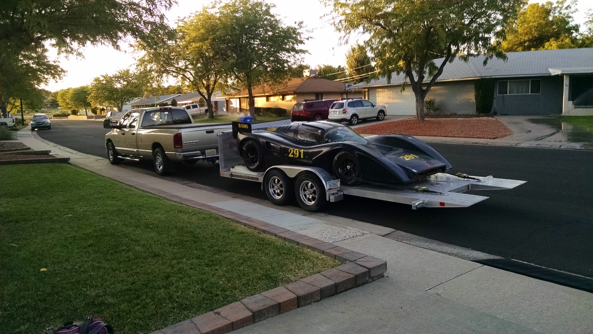

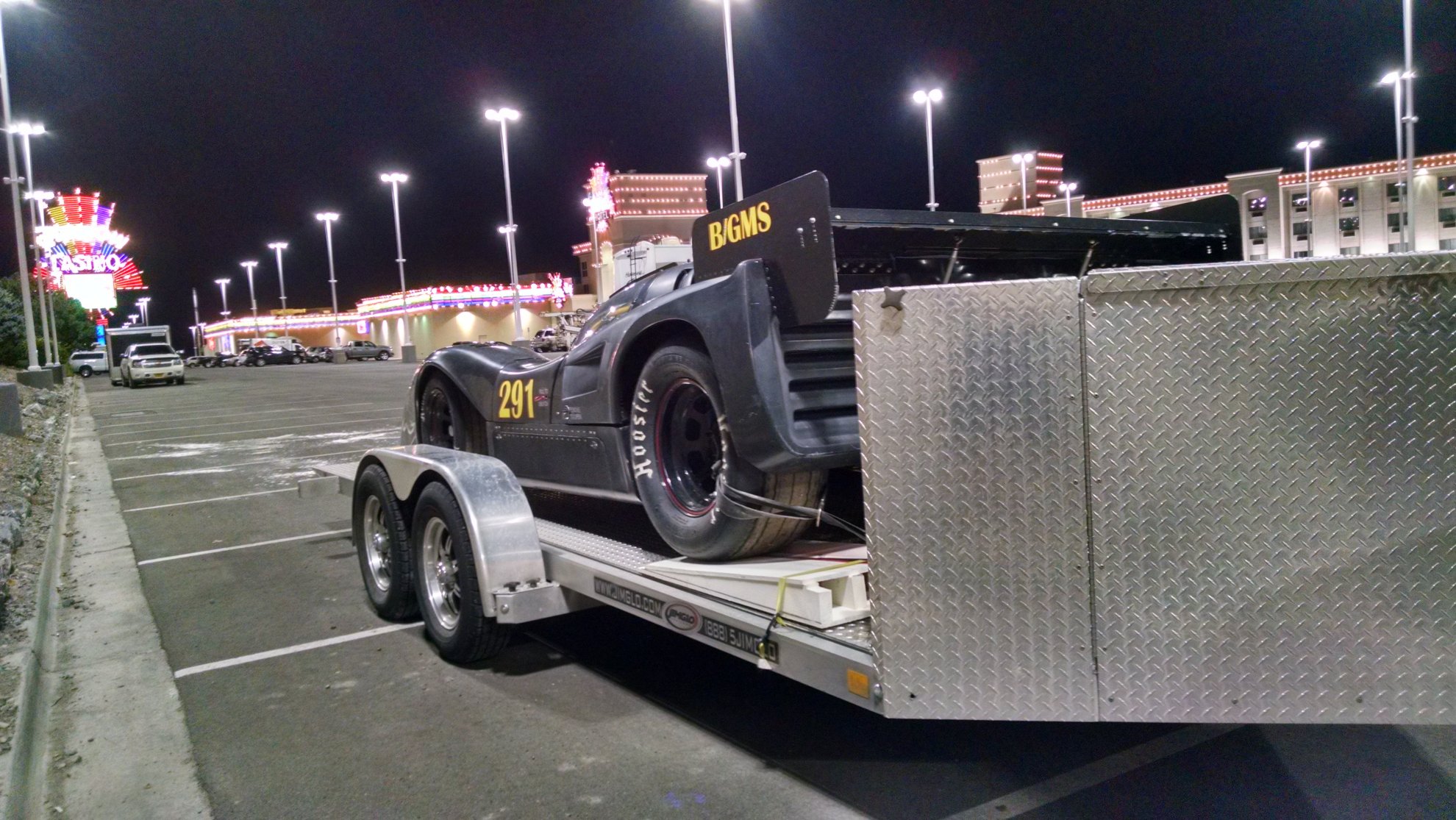

Eric;
Due to its long nose and low ride height, I had to use a pair of short ramps to get my car onto my 18" Jimglo tilt trailer without scraping its nose on the ground. I made a pair of ramps using a few pine 2x4s and 1/2" plywood. I cut the 2x4s diagonally on a small bandsaw and glued & screwed the plywood on to both sides. To transport them, I run my rear tires about 1/3 of the way on the ramps which secure them. You can see a little of the white ramps in this photo that I took in Wendover, NV two weeks ago. The second picture shows how long and low the nose is on my car- probably more of a problem than on a GT40. Ramps are not that hard to make.
