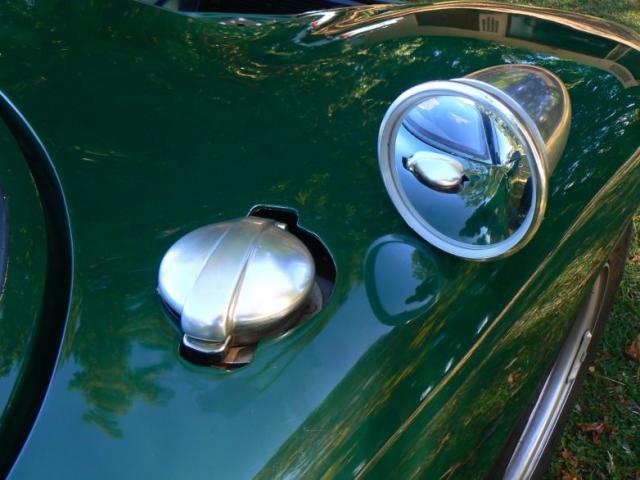

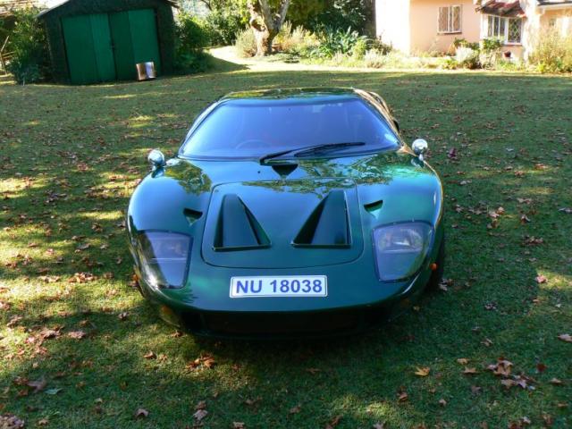

this is what I did, using only existing window mount holes. After all the body work didn't feel like drilling new holes in the body
used the bullets in aluminum, most of the originals had bullets in chromed steel.
I have two bullets, but replaced the curved convex mirror with a flat mirror, improved visibility and judging distances a lot. I will also install the incar blindspot mirrors, great idea!

Hendrik,
Those won't pass IVA for size or radius compliance and also external force impact.Period correct maybe... current rules to get car on the road.
