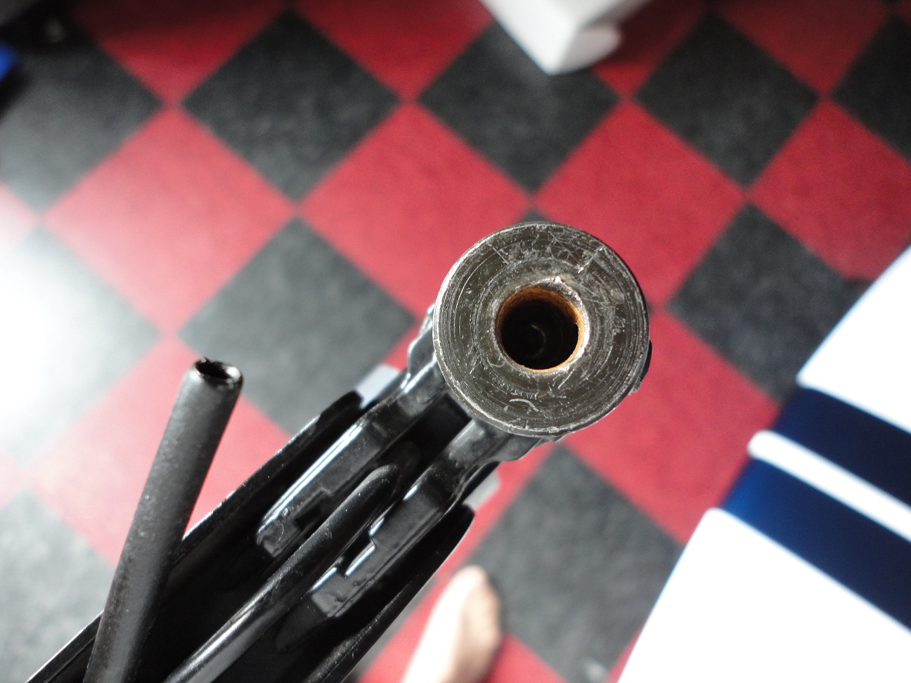

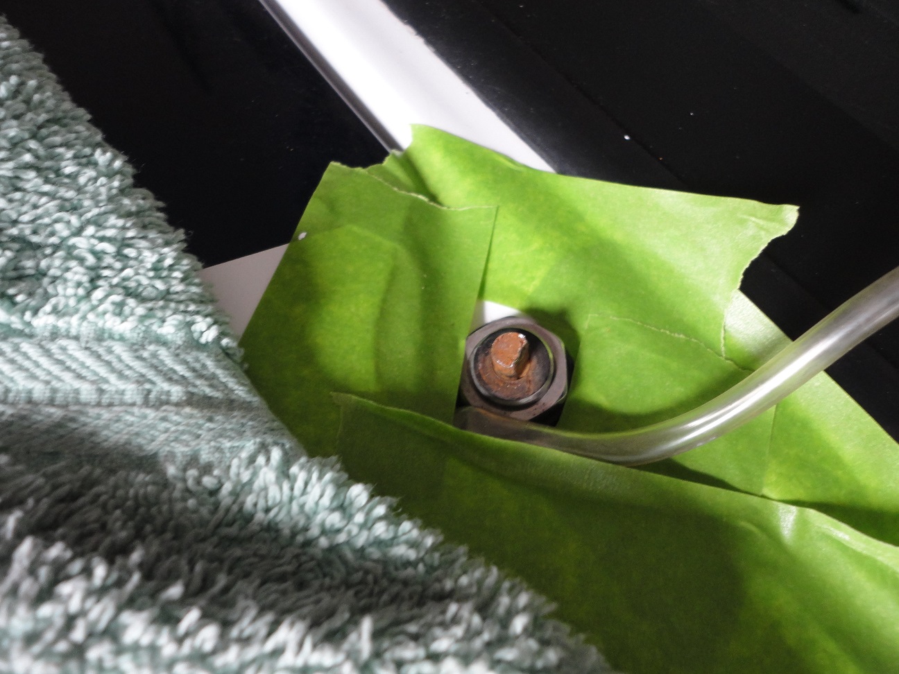

My wiper assembly appears to have too much slop in the attachment points and wants to come off. Curious if there is another part I'm missing.
The allen screw attachment needs more depth to fully seat.

PS Update on the Wiper fix: received a call from Randy Thomas who is part of the Superformance.org owners group. Easy fix he performed was to drill and tap another allen set screw 90 degrees from the other and closer to the edge, working on that now.
