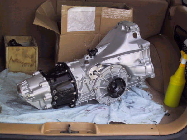

Certainly is a tease... /ubbthreads/images/graemlins/wink.gif, sorry about that.... Actually doesn't belong to me, it's a photo I took of an 016 box that was lying around in the RF workshop about 2 years ago being fitted with an LSD and is probably now in one of the RF cars sent to the States...
Bill.
