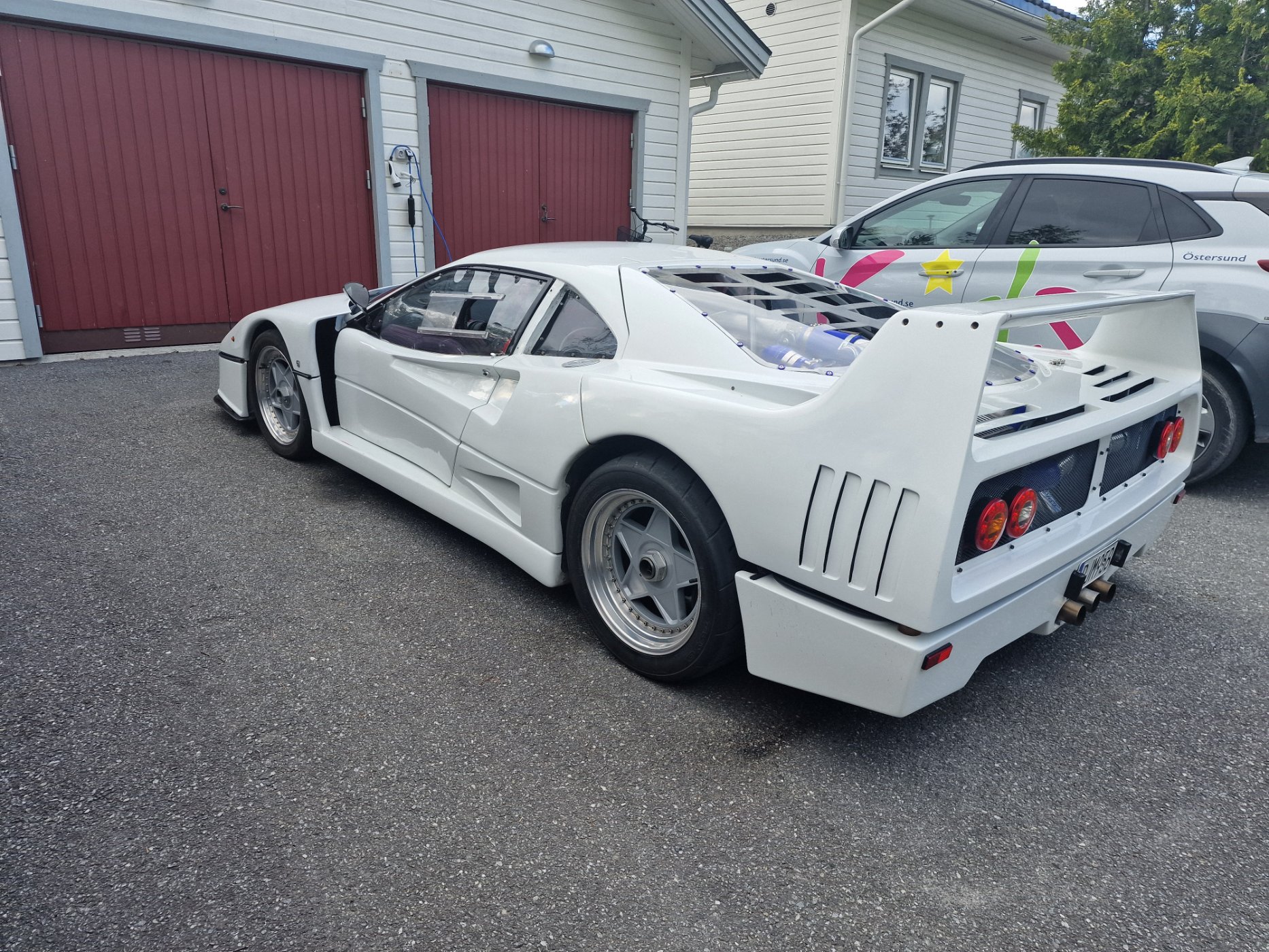

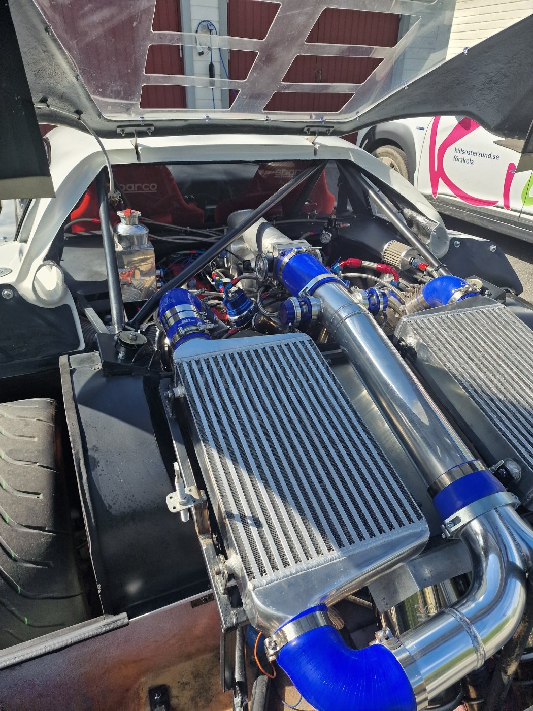

Anyway my Ferrari F40 replica has a excat copy of the F40 chassie but the engine is a Toyota 1uzfe, 4.0l 32 valve engine that has dualturbo and 540whp 1250kg car
it drives very very hard, and everytime a push the throttle im amaced that the 016 doesent blow up?, so my question is what hp figures has ppl on this transmission?
what hp/torgue can it handle?, it looks so tiny..... my 016 has also quife lsd mounted, and it has not broken yet, but im thinking of swap it for something sturduer, but what transmission should i then go for, any ideas?, or do you guys think im fine with my 016?

What i've heard is it is usually the cast iron section that breaks. Some have added a steel reinforcement plate to help prevent that. The link below is a thread discussing it with installation instructions. There's also an IGES file in the thread for the plate itself.
forgot the engine spec, i have 540whp and 660nm, and it has not brake yet, i dont do full blast with spinning tires, but from second gear and upp, full throttle, it happens a lot and no problem yet.
