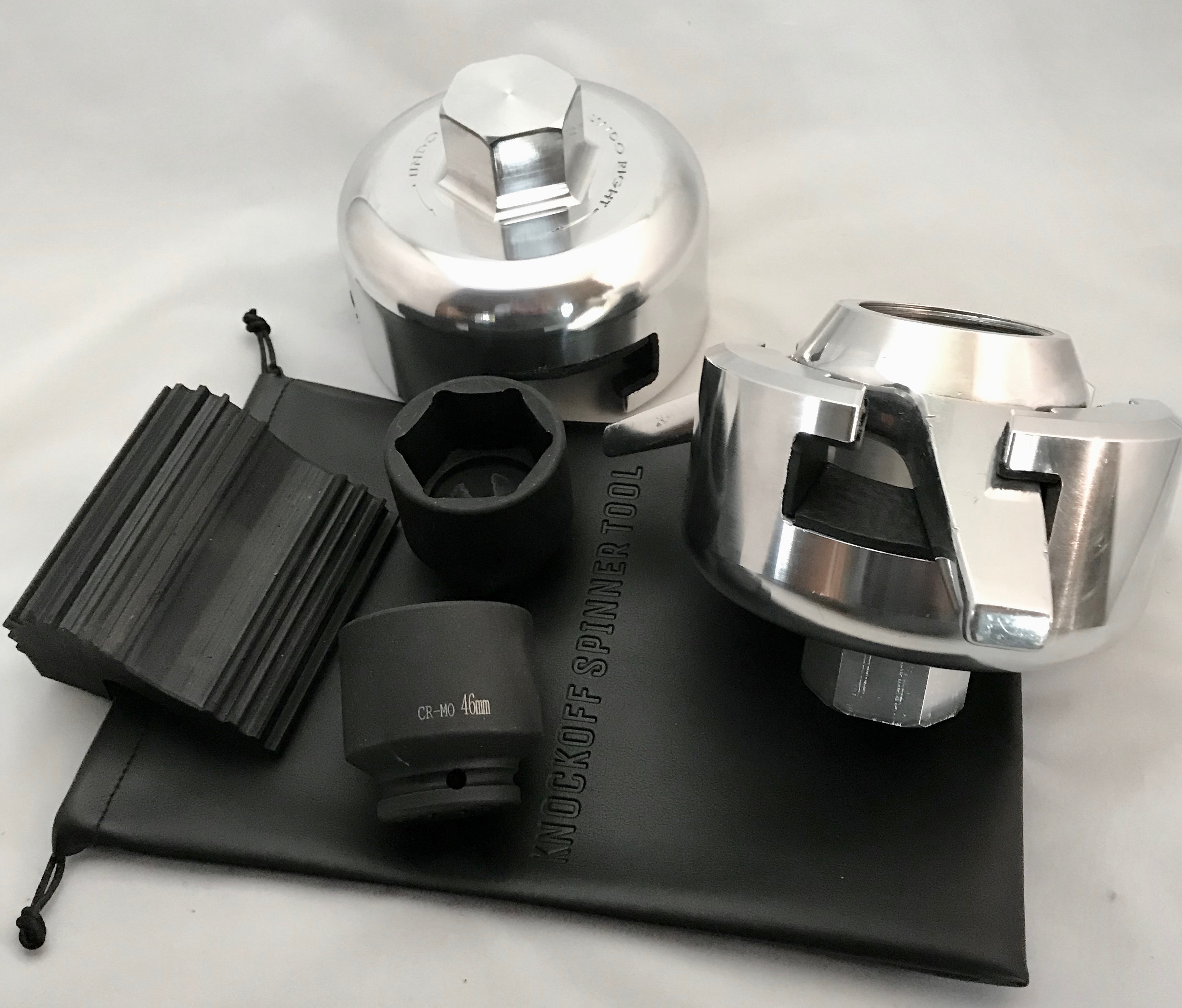

A simpler method is to use a wheel chock by just jacking the car up so the tire just turns and place the chock on one side of the tire to loosen and move the chock to the sides of the tire to tighten, then let the jack down for a perfectly seated spinner to the wheel.
