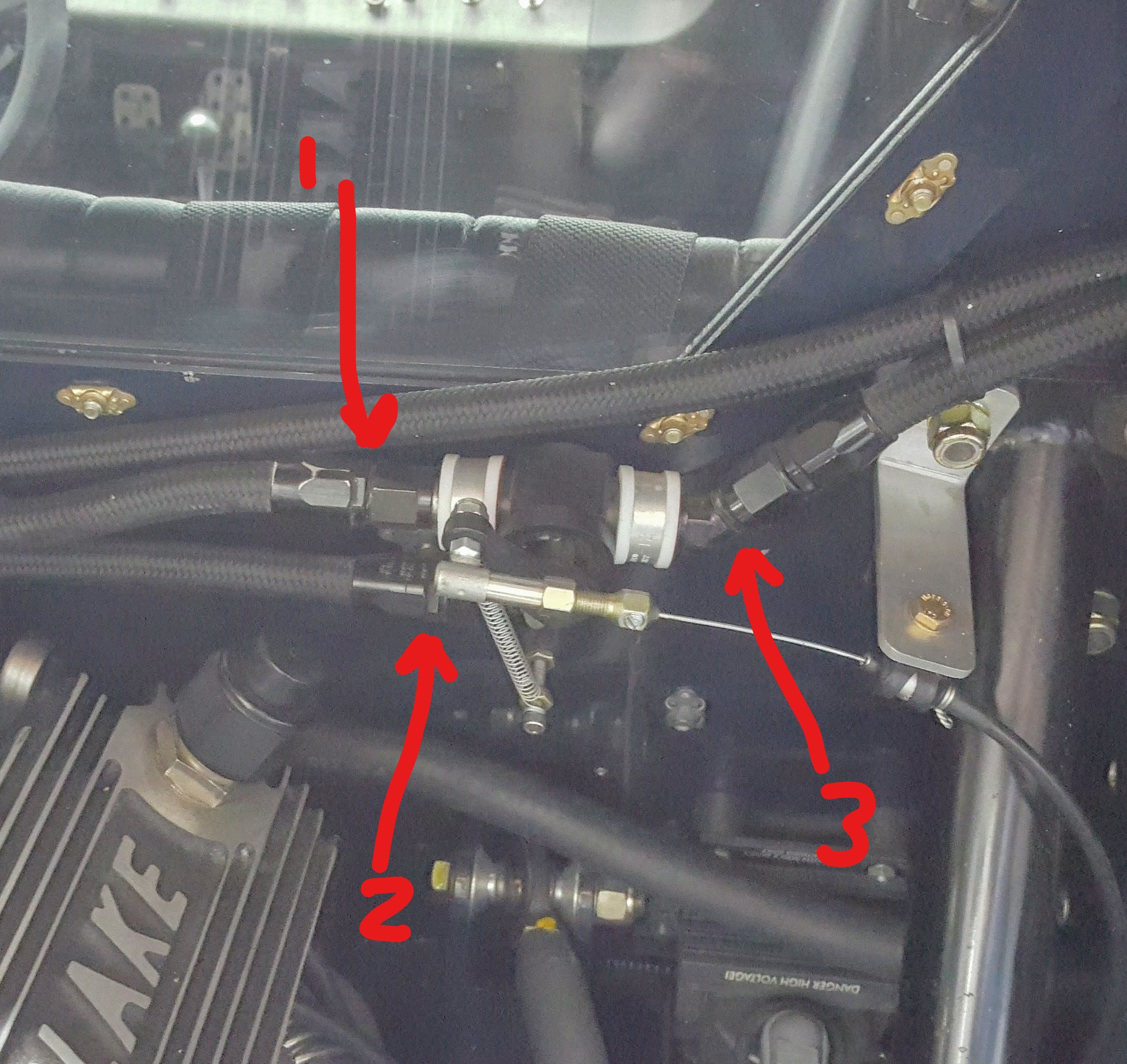

Enderle Fuel return valve
Enderle fuel injection shutoff valve re-purposed as return fuel tank selector valve. 1 = From fuel rail return/regulator, 2 = to left tank return, 3 = to right tank return. A simple choke cable routed to the cockpit allows transfer of fuel to selected tank. Over center spring is used to hold valve selector in position.
