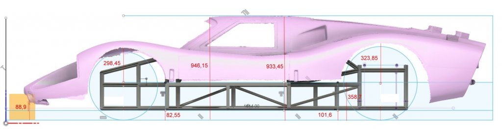

Don Nye May 26, 2021 The 298.45 should be from the ground to the center of the wheel as should the 323.85 in the rear. Not noted on your sketch, the front sill is 339.7 and you have the back correct at 358.7.
