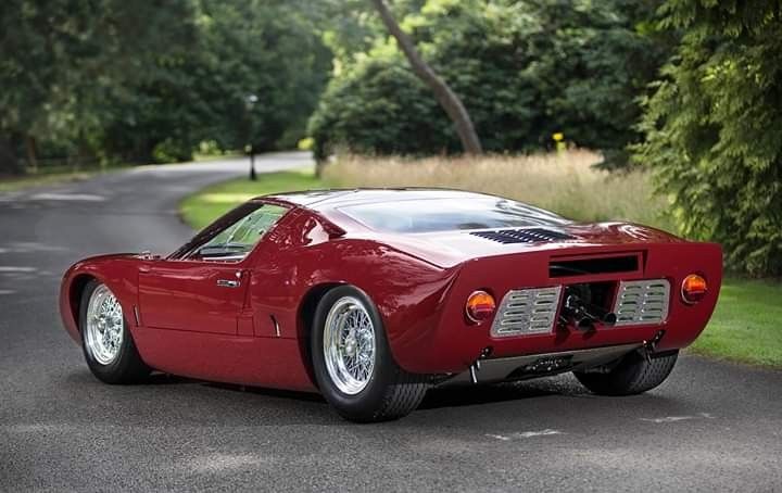

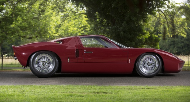

Was wondering what 15” wheel widths are typically run on GT40s I’m seeing 10” rear and 8” front. And the street car had Borrani wire-spokes
Front - 6.5 x 15 in.
Rear - 8.00 x 15 in.
Was thinking going somewhere in the middle.
im building a mk1 street car and want a less aggressive stance. Anyone here running a 15x9 rear and 15x7 front BRM wheel setup?

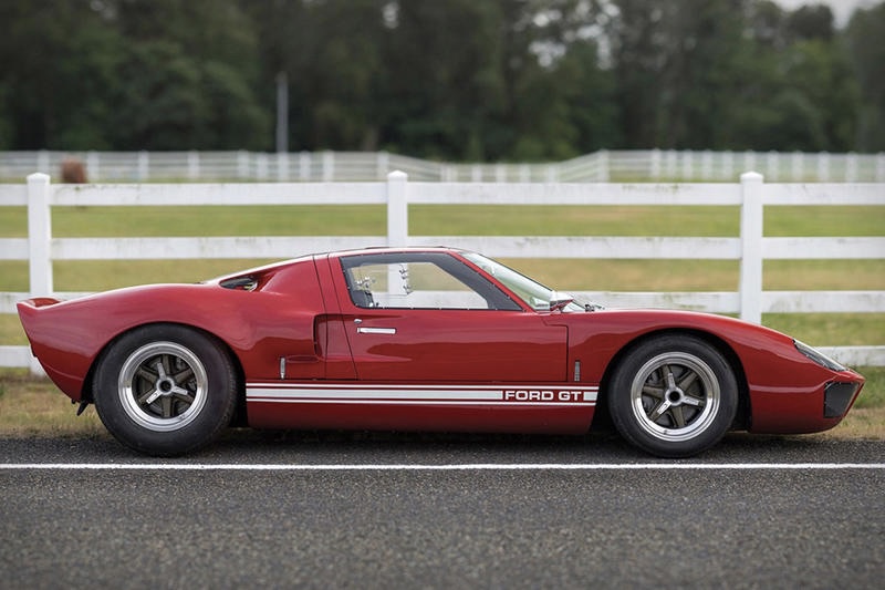

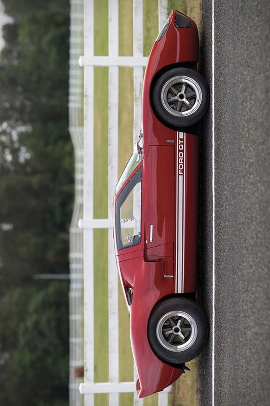

Choose the tyres first. For 15" use the Avon cr6zz. Usual is 8x15" front and 10" rear wheels with 215/60x15 front and 275/55x15 rear tyres.
This is what I have on my GTD.
Don’t really want to run a 10” rear but I’ll dig around and keep searching. Love the look of a slightly tucking tire on these cars.
