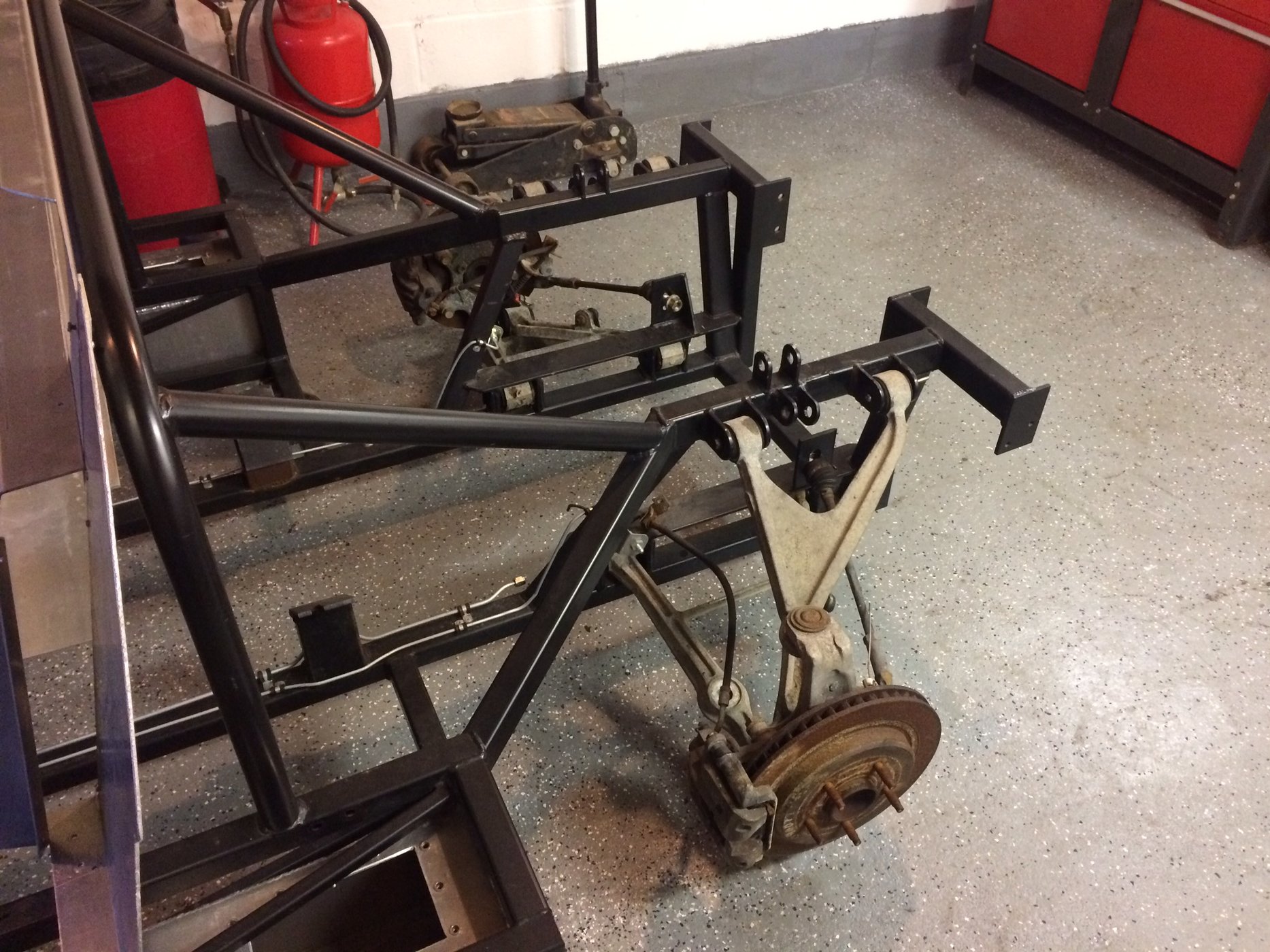

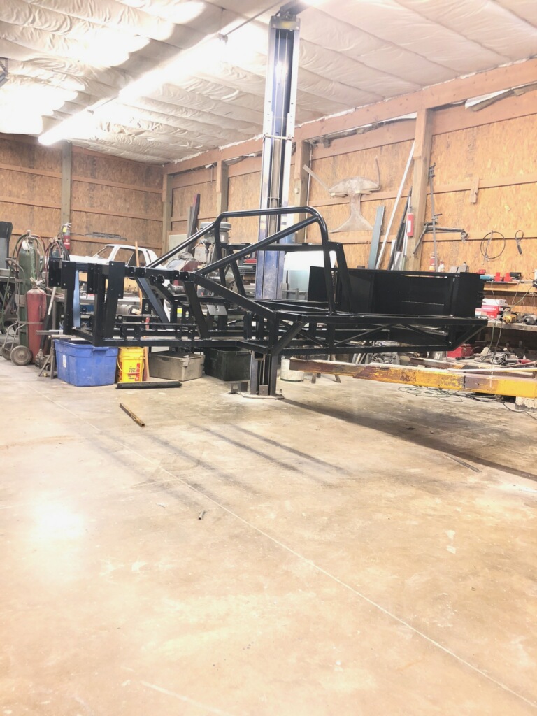

Hey lucky Active power gt40 owner/builders, I've been eyeing up your rear chassis C5 suspensions as I need direction with my Manta rear C5 conversion. It looks to me like the lower and upper control arm mounting points are both mounted level front to rear . Am I seeing things or is that how they actually are mounted?
2 x2 rear cradle is what my Manta has currently and replacing it with a similar 2 x 2 with level control arm mounting points will really simplify things. Thanks I appreciate any direction.
I apologize if my reposting these pics I've found on Active powers site ruffles any feathers-just posting them so others can eyeball what I'm talking about.
