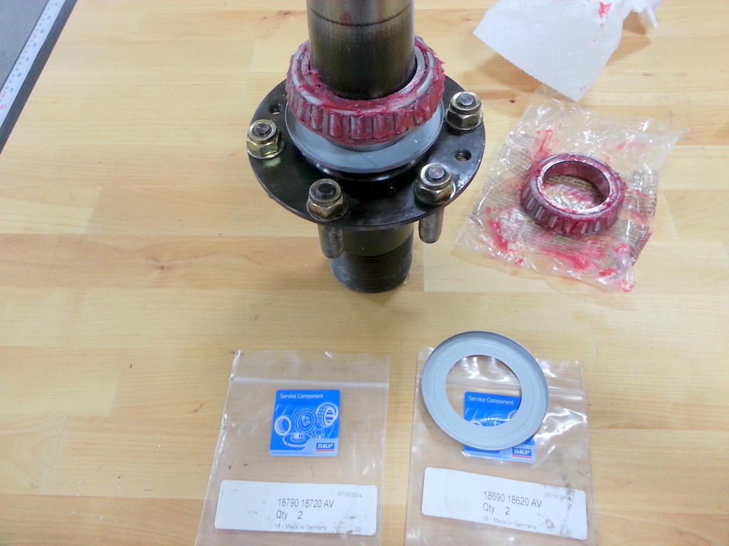

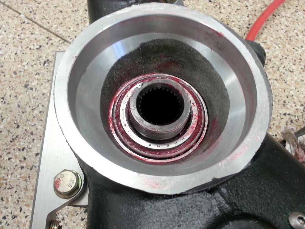

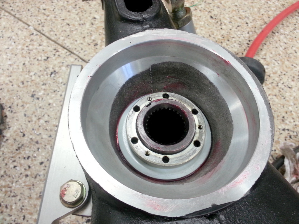

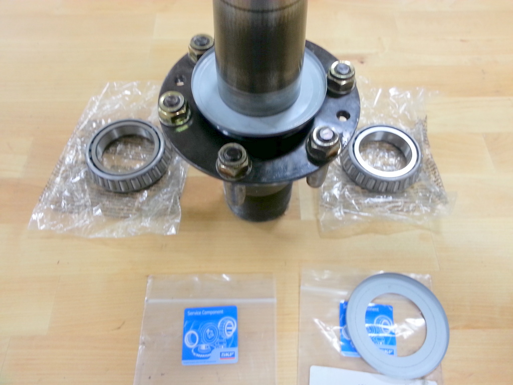

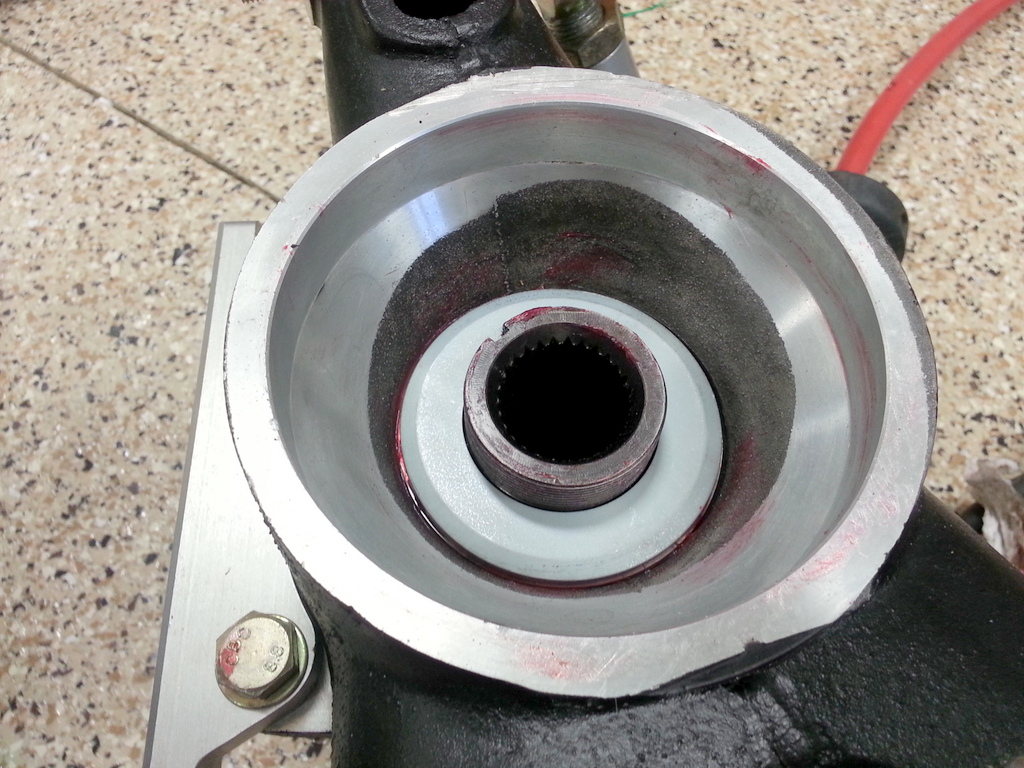

I do have a lath and can make the spacers if it comes down to the bearing preload issue. Jac Mac the seals are designed to wear a groove in the bearing race. As you can see from the pictures the seals get sandwiched in the stack of bearings etc. so they have to turn with the hub. Considering how hard the bearing cone material is I have to assume the seal material is very hard also seeing as how it wears a groove in the race. The groove isn't very deep maybe no more than maybe .010".

Yes, Im aware the seals are made to work with the dimensions of the bearings, therefore for the purpose of making and fitting a solid spacer to fit between the inner and outer bearing cones inner races the seals do not need to be in place while you fit and check the spacer length, gradually reducing that length until you arrive at the desired preload. ( this might be easier to do with a 'dummy' shaft with same dimensions as the hub, but machined for light push fit of bearings is used since it will take a few steps to arrive at correct length ). Once that has been done you can fit seals, bearings, & spacer to actual hub and tighten retaining nut to a suitable high torque figure knowing you have have suitable pre load regardless of extra load applied by seals.
