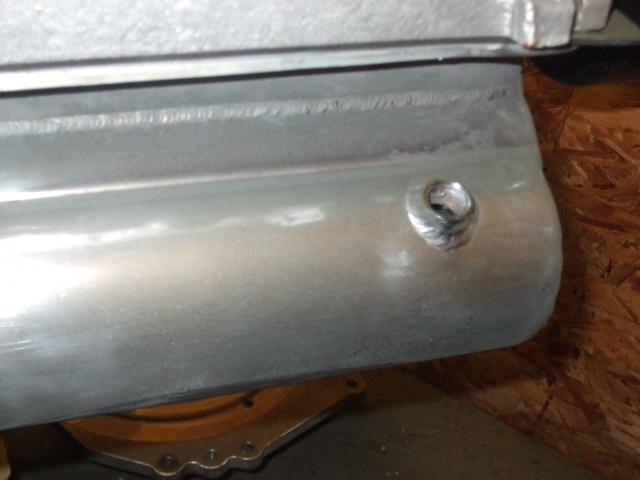

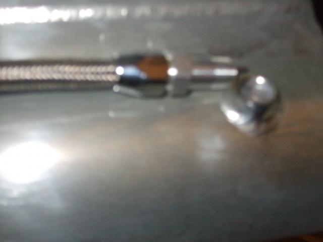

Hi,
I purchased an Armando's oil pan and a flexible dip stick from Summit which unfortunately does not fit the oilpan, as the connector is to small. Does anyone know if I can get a convertor, to enable it's use, where I can get one from and what size I need.

When you say "connector", are you refering to the bung on the pan, or the threaded (not sure about that because of the out-of-focus photo) tube that screws into the bung? Is there enough material that will allow new threads be cut on either piece?

I have one on a mustang pan that is at the shop so I can't take a look right now but from what I remember one side of it (top) was a compression fitting and ferrule but can't remember if the pan was a pipe thread or straight. It's hard to tell from the photo what it is as it is a bit out of focus as mentioned.

Hi,
Sorry about the photo taken rather quickly. The threaded tube that screws into the bung (which I believe is npt) is to small.

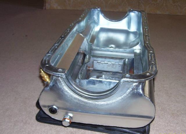

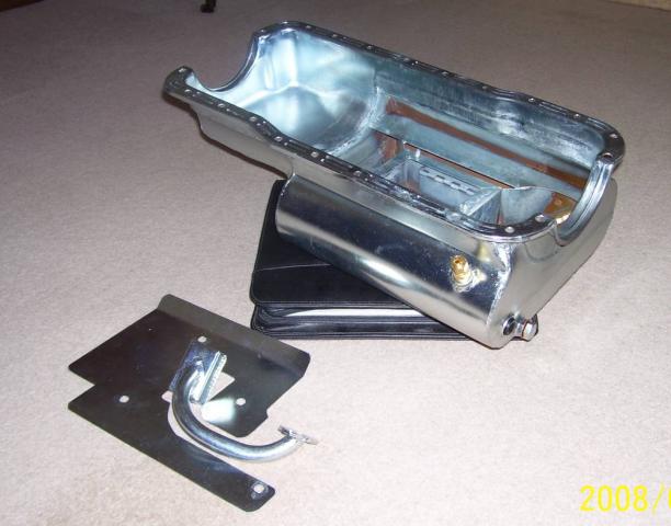

Here is a shot of my Amando sump showing the fitting supplied with the oil pan, I bought direct from the maker.
Regards
Steve

Sandy
Gulf GT40
You will not have any luck with email. Armondo and company (his wife) are not really internet savvy and the last time I spoke with them a few months before they moved to TX. His wife mentioned he also had a computer virus and were unsure what to do about it all, so site got messed up too to some extent. Didn't sound like thay had a handle on the computer side of things... Best way is to try the phone.
I think your right I recall the fitting was a pipe thread with a compression fitting with the brass ferrule something like what you might have for a plastic high pressure tubing, it didn't much make sense what or how it was to be used. BUT check out Aviaids site they may have the stuff you need as it is basically the same pan, Canton may also have the part as I recall one of my canton pans has a similar pipe thread bung.

I had a Canton sump with a dipstick to the left rear of the engine. The Canton dipstick and tube fitted directly to the Amando fitting. I would bet the fitting is identical.
Regards
Steve
