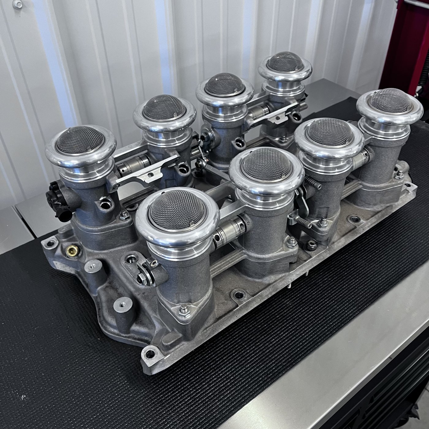

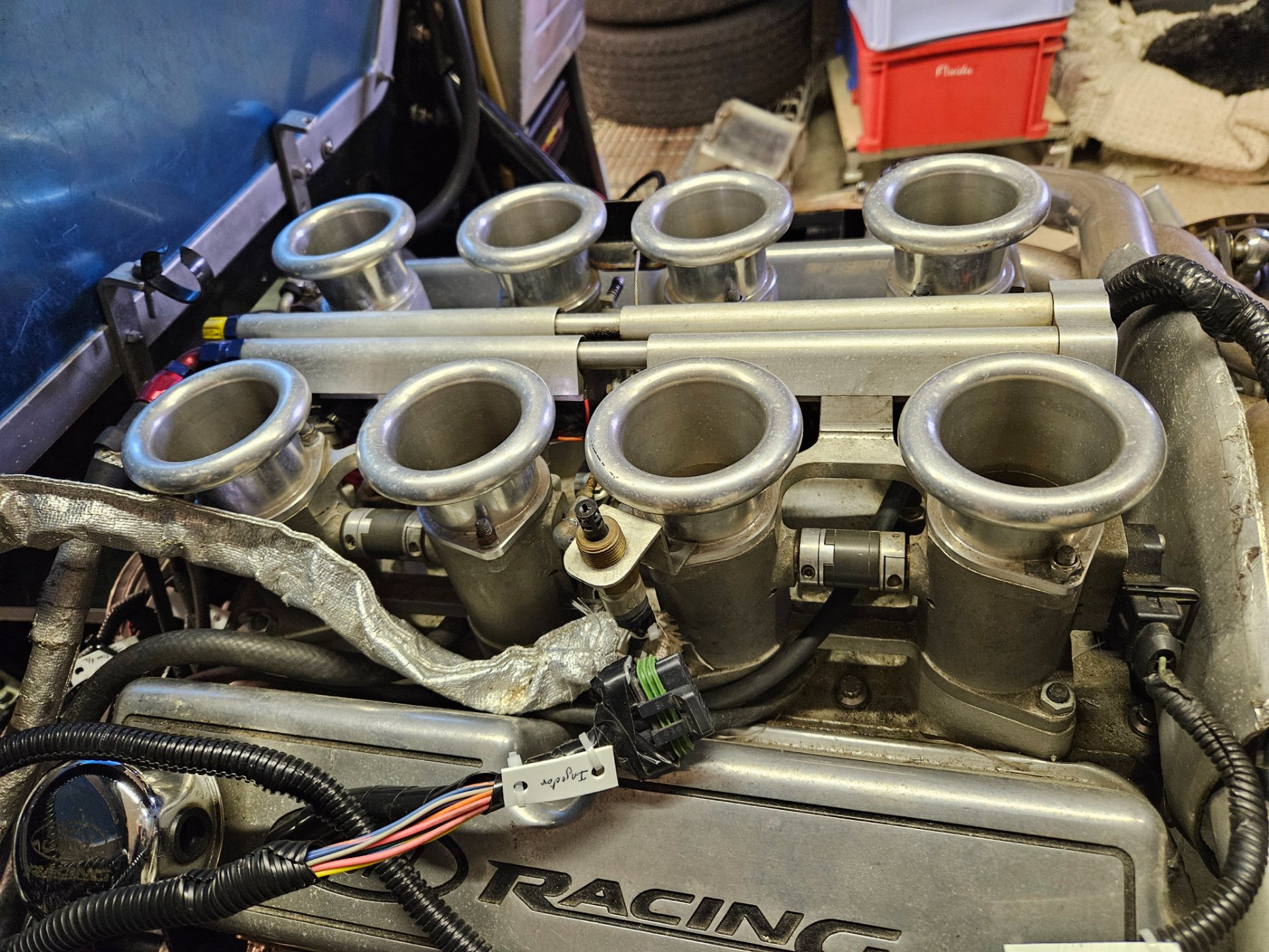

This was the supplied Borla Intake.

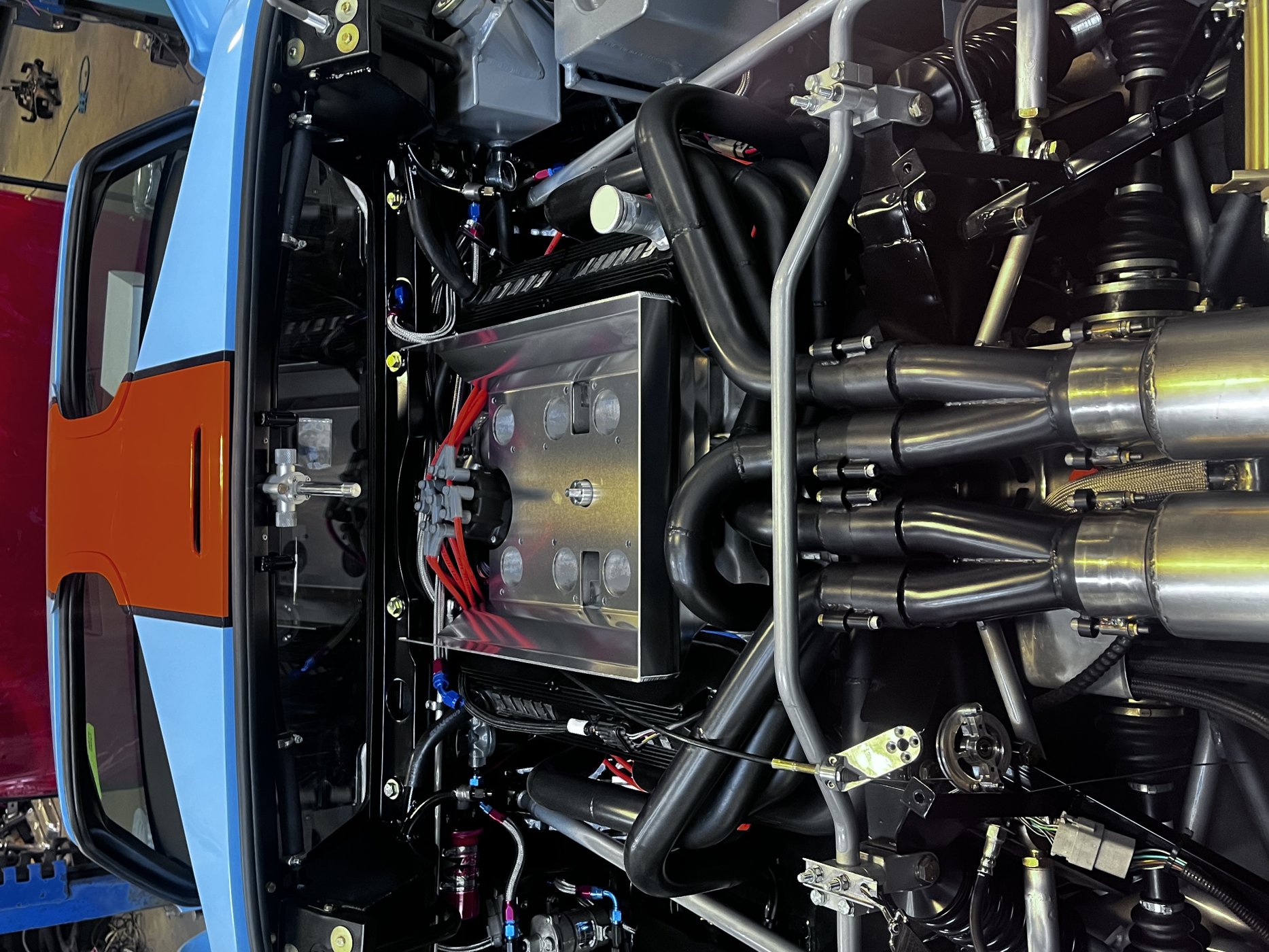

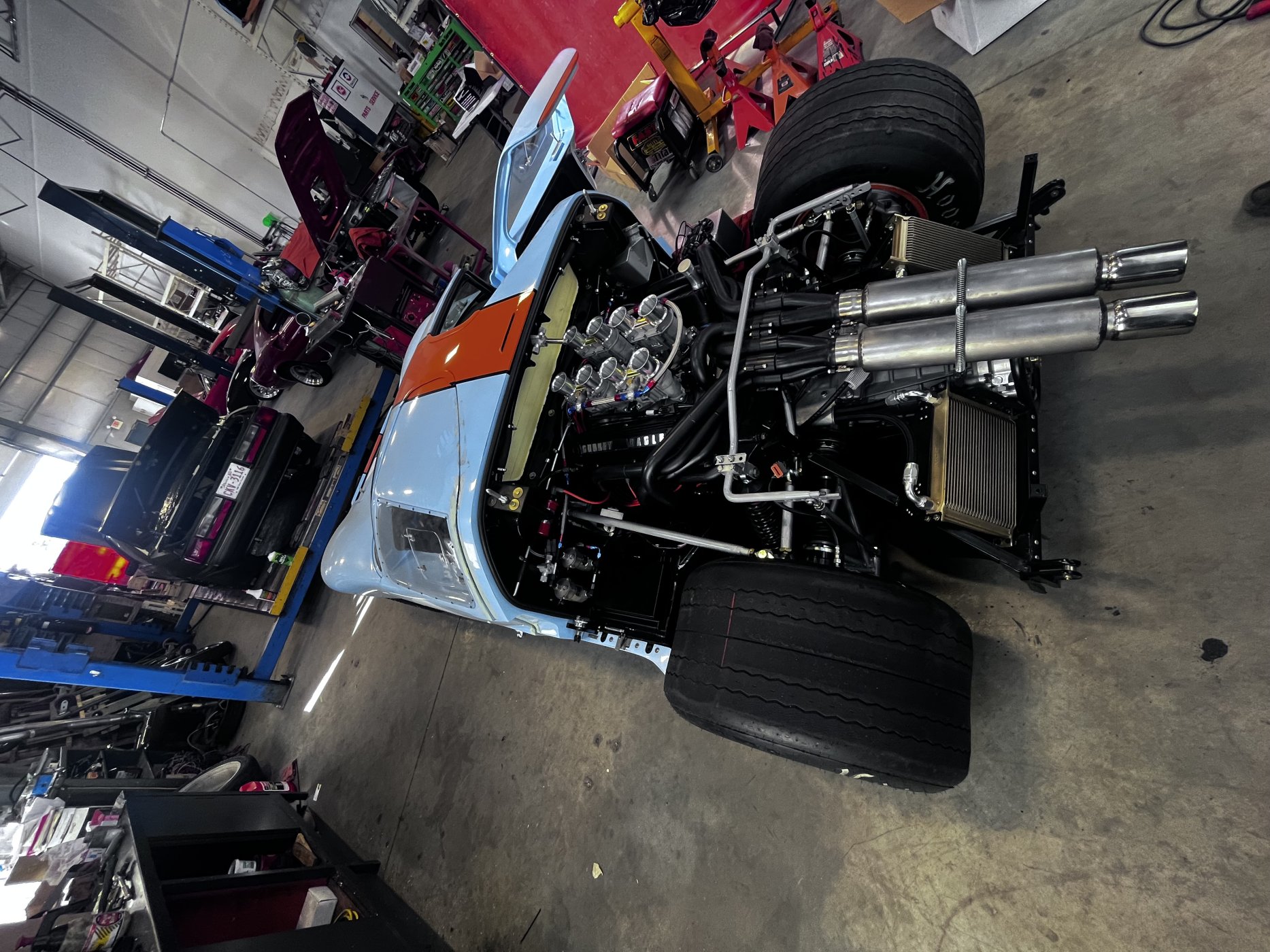

A couple pictures of the car.

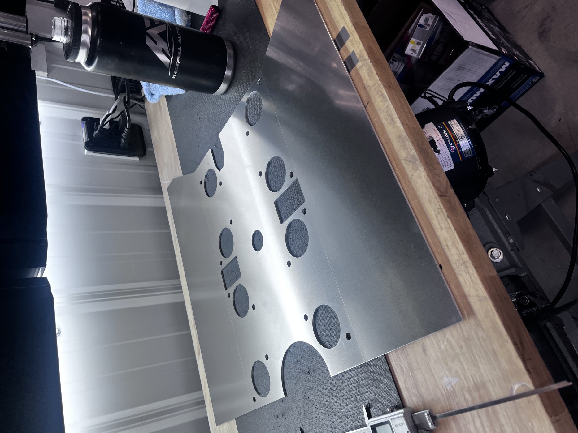

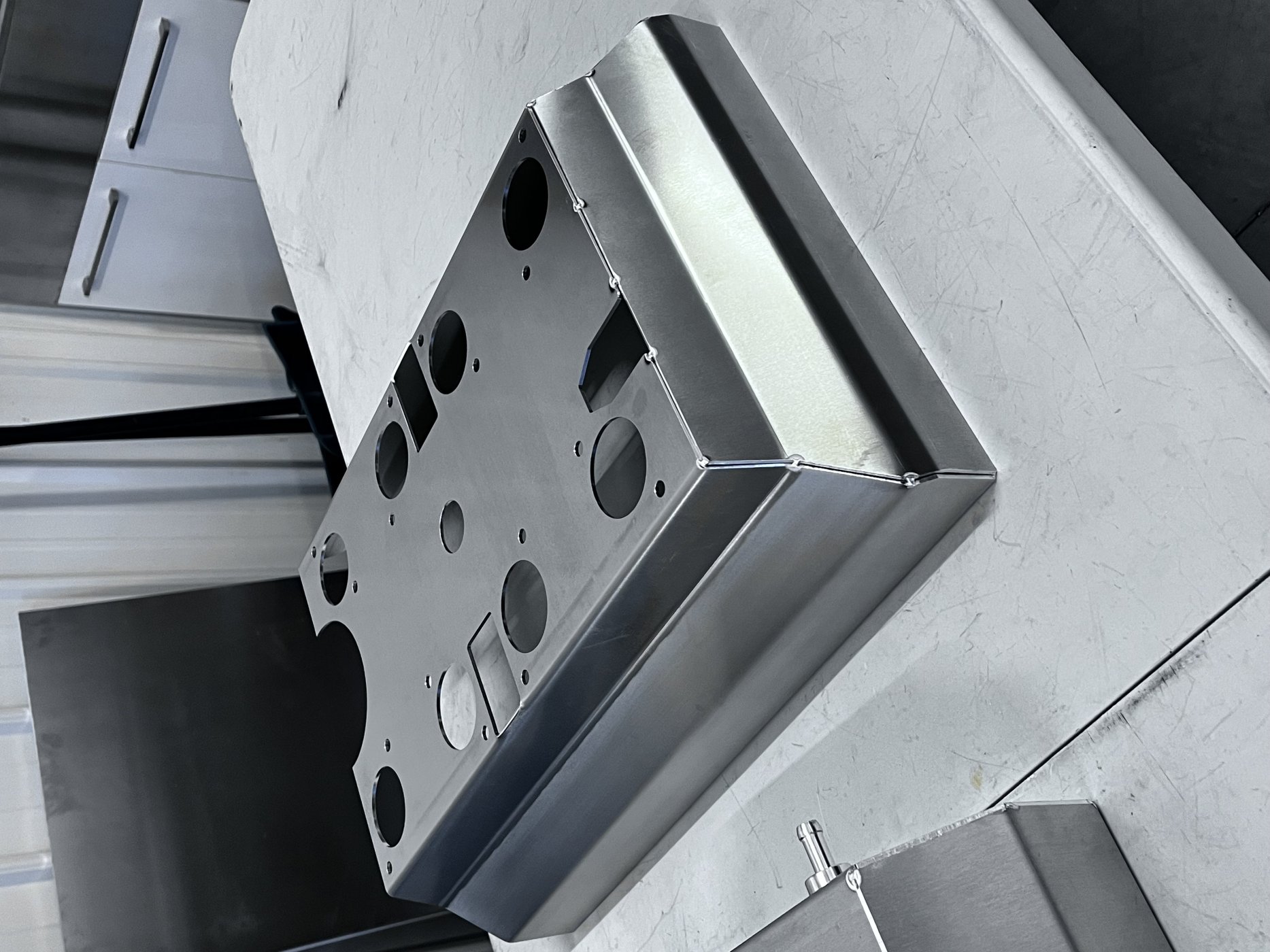

Now onto the pan itself. This is the flat pattern that was cut on a Haas CNC mill for maximum accuracy.

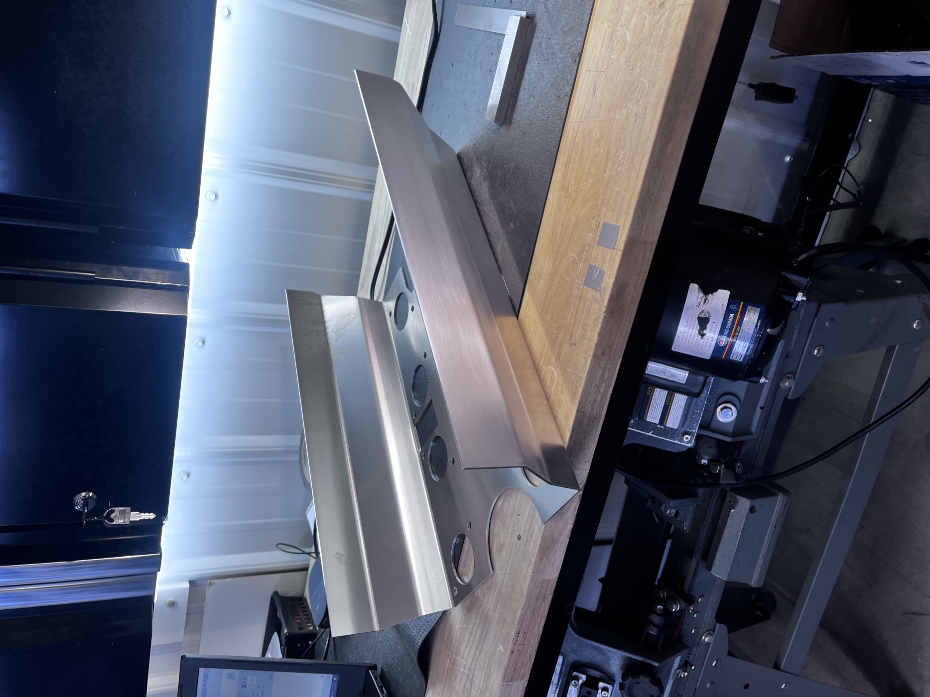

Now onto the forming..

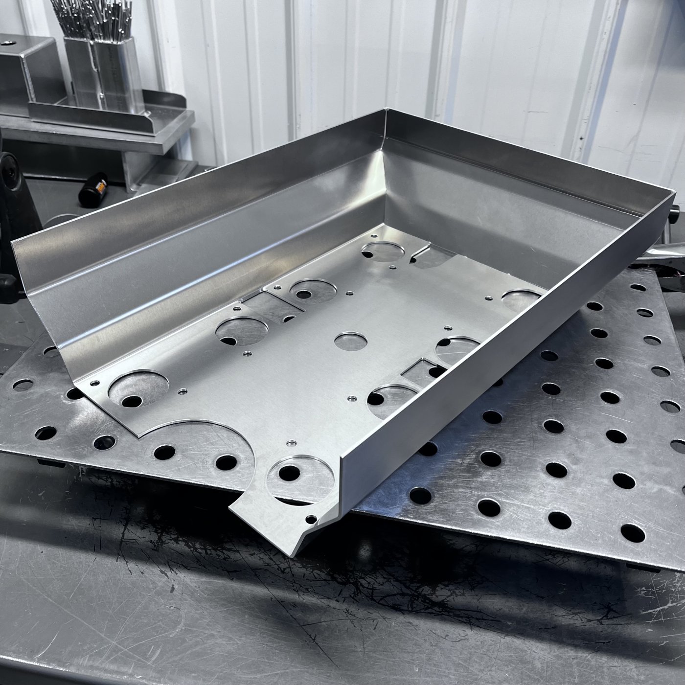

Here it is with the back piece tacked in place.

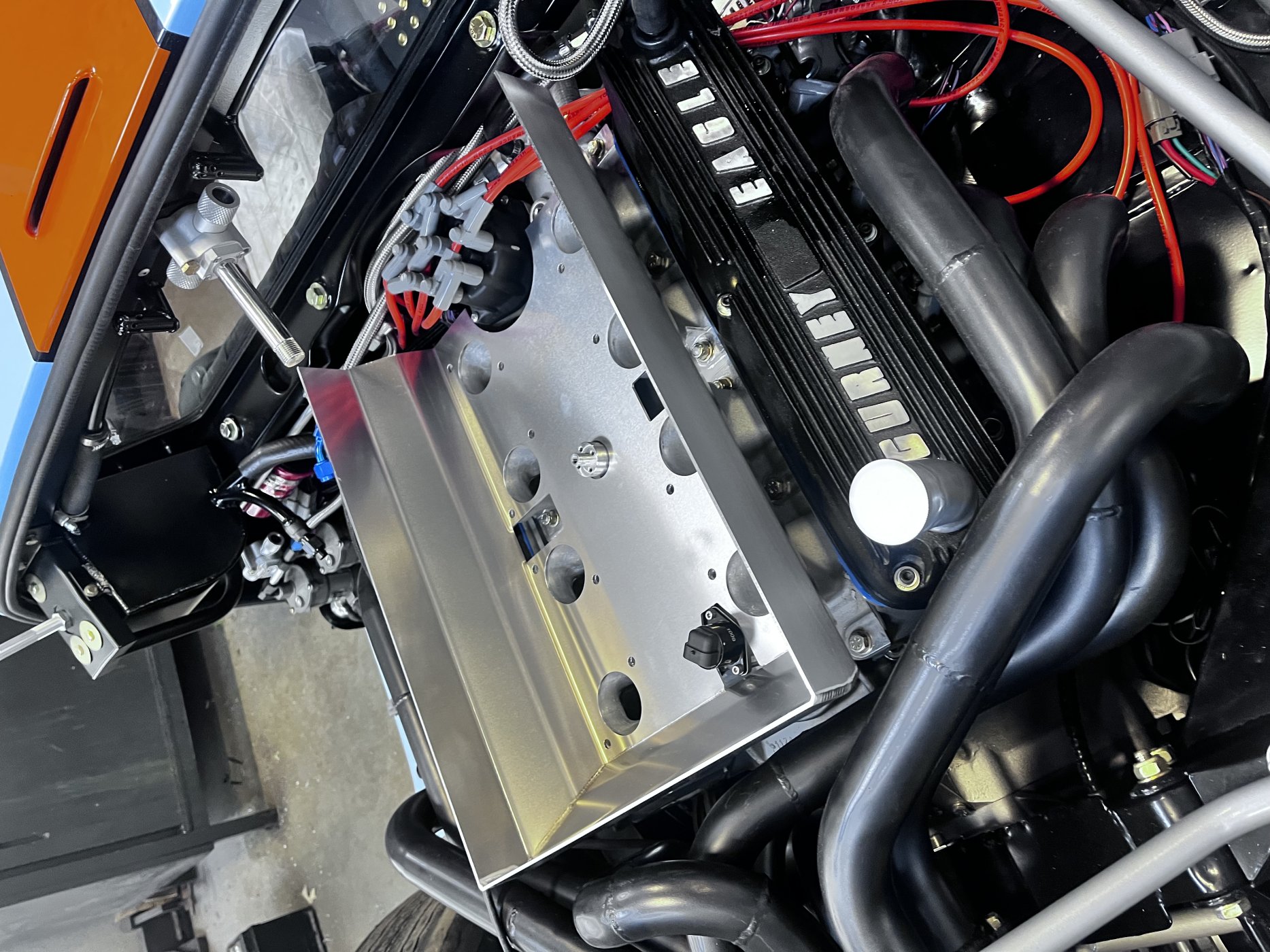

First test fit was successful!

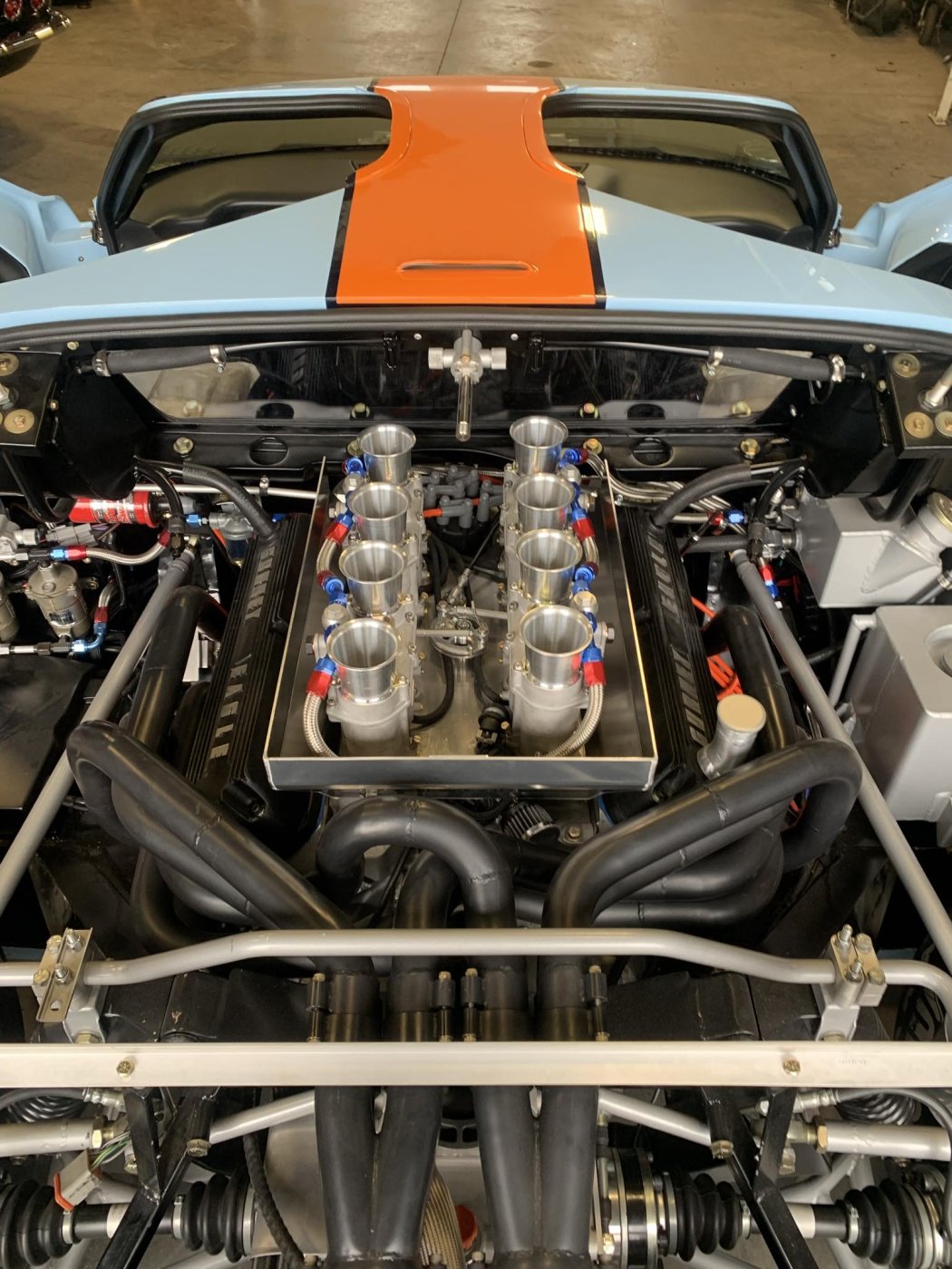

Installed with the ITB’s!
We then set the clam shell on and made sure it fit nice with no clearance issues. ( it won’t let me add anymore pictures but I’ll add more below when I get a chance)

Very beautiful work. A note - your Blaster 2 coil mounted horizontally - I have been told by some and MSD recommends that coil only be mounted vertically. I have read where they leak. Just and FYI as I have not "tried" mine yet.
Also, how did you convert your rear sway bar to that one?
thanks

Lee, The job is very nice, but I would be very intersted to see how you manage with the Borla device. On the picture of the Borla, a lot of parts are missing : the 2 gas supply rails are missing, the cable to drive the injectors, and the 3 tubes that go to the pressure sensors in the middle of the top. I have exactly the same Borla injection and I may tell you that the access to all the parts is very tricky already, for excample to adjust the cabstan. With the nice enclosure you propose it will be impossible.
See the photo before I "clean" the path of the cable.
I’m not sure on all of that. Eveything was functional with the turkey pan on the car after it was installed.

That is the "tool room" model bar, it is not a conversion.
