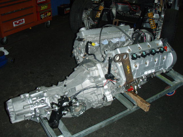

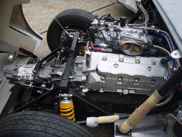

Hi Michael,
Here you go, a 4.6L Cobra to an Audi 01E six speed. The kit is from RF and the new design is second to none.
Bob.

rockonsmile way cool but do you have pics of the fly wheel and of the plate?
can see the stater? hole pls pls pls
i have been trying to get this done for 2 years!!!!:mad:
i might have to show up on your fornt door!!!
The kit is from RF who is that?
what starter did you use?
Hey Michael,
RF stands for Roaring Forties. They have a complete kit from starter to flywheel. They are members of this forom and they are the first to reply to your question. If your in Sydney you are more than wellcome to come and see.
Bob
