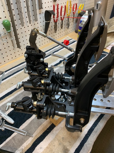

I took the pedal box out of the SLC to make some changes to the MC fittings to allow me to move the PB forward an extra inch. While I was at it I noticed the MCs were seeping a bit of fluid so took the opportunity to rebuild them. I see in some of the Tilton videos they recommend lengthening the front MC clevis an extra 1/4" to give the front brake some additional bias. I've got both the front and rear clevis set the same and the balance bar in the center of its adjustment and was wondering what other folks have theirs set at? Is anyone adding in the additional 1/4" as the Tilton video suggests or are you running the front/rear MC rods/clevis the same?
Thanks in advance for the help. Scott

Mine are equal length on the pushrods, and the bias maybe is a turn or so off of center. I guess I need to look at Tilton's video. I don't understand the purpose unless the assumption is that there is more piston stroke on the front, so a full pressure, the front started "behind" the rear, at mid-pressure, is even with the rear, and at full pressure, has passed by the rear. In my case, I have the exact same calipers and rotors front and rear, and am very close to a centered balance bar with that, so again, not sure why they suggest that.
You need to have enough clearance between the front and rear Clevis and the center section so that the bias bar can rotate the full extent. If you loose fluid on one side, you need to have the bar rotate all the way until it hits a stop. Then the other side can produce pressure. If you don’t have any clearance, then the front and rear master cylinders will have the same stroke and will not bias pressure. In order to bias pressure, the bar must be free to rotate to have different strokes of the master cylinders. You should check if the bias bar can rotate the full amount before you connect the push rods. The mentioned 1/4” might be about right. The length of the push rods is not what determines the brake pressure bias.

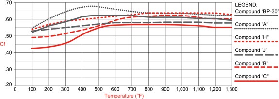

Lastly is the pad friction coefficient. Cheap street pads are about, .35, and the highest friction race pads I know of are about .675. There is a huge difference between the two. I am using the Wilwood B pads at about .625
My experience is with mid-engined cars at about 2500 total pounds and 60F/40R weight distribution 6 to 1 peddle ratio without power brakes and 4 to 1 with PB's.

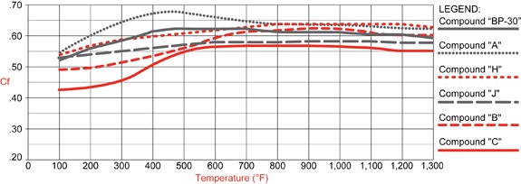

Lastly is pad friction coefficient. Cheap street pads are about, .35, and the highest I know of is about .675. There is a huge difference in the two. I am using the Wilwood B pads at about .625
For street use, the Performance Friction "CarbonMetallic" pads have an unusually high coefficient of friction and they are easy on your rotors.

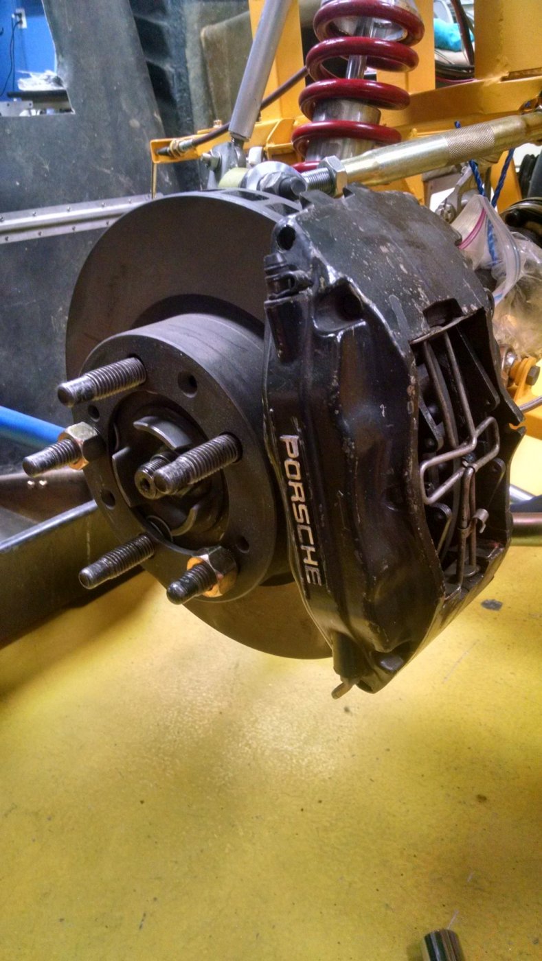

To illustrate the lengths some go to get the right mix of parts to give optimum performance, I'll give my rear brake setup as a harebrained example :). Since I used a Porsche G50/01 transaxle and Porsche 996 rear uprights & axles, the hubs had a standard Porsche metric bolt pattern. I spent some time researching possibilities for a brake system that did not cost an arm and a leg but one that would be really effective. It turned out that a Porsche rotor and Porsche (Brembo) aluminum caliper from a Porsche 928 S4 FRONT fit right on the 996 rear hub! With the right M/C and pad choice, it worked well with my Corvette front brakes. I do not use a balance bar, only a rear brake proportioning valve.
Let me stress that my setup is for a scratch-built "homebuilt" rather than a GT40. Your setup should probably start with what your kit provider recommends.
