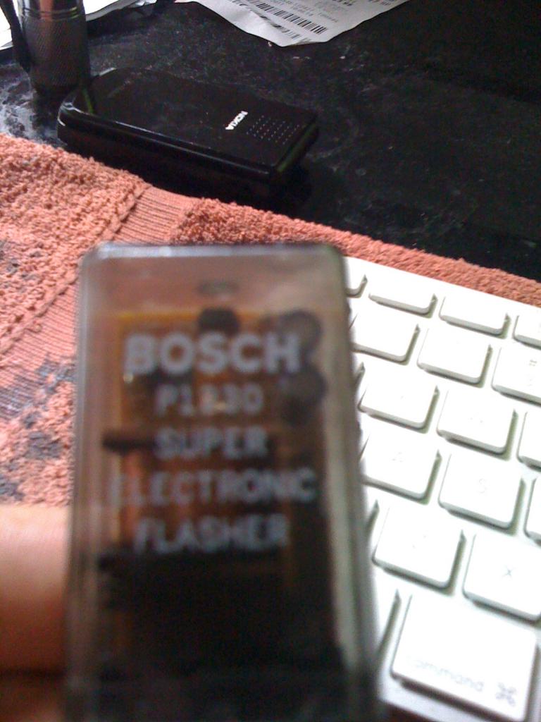

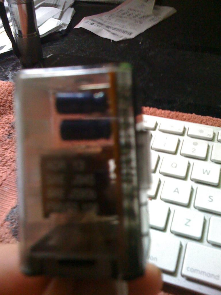

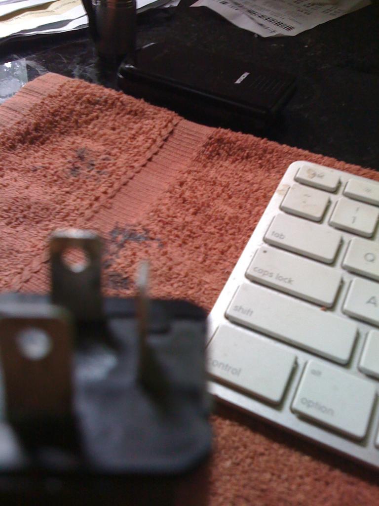

My car is almost sold but have to replace this part before it goes. I cannot find it on the web or a importer dealer that knows of this part for the Turn signal flasher. On the part it is stamped Bosch P1230 Super Electronic Flasher. I called the company and have no luck. Does anyone have any clues or another unit that will work in the RF. Bosch state they need the 10 digit part number to order the part. It is not stamped on the unit.

Unless you specifically need a Bosch flasher, I'd bring it to your local auto parts store and see if they can provide an equivalent flasher.
Try these #s Product Line: NAPA Flashers Part Number: NF EP35 , FL500 Interchangable With , Bosch P1230 , Hella 3016 ,Tridon EP35 Most autoparts stores should be able to get you 1 from this list.
