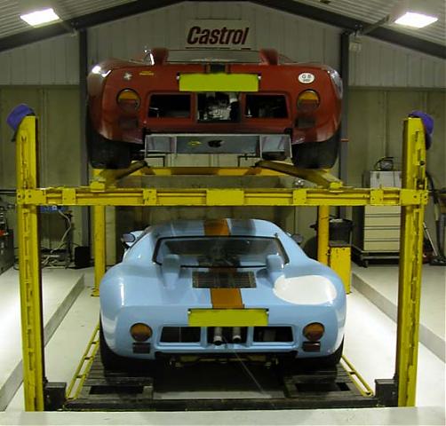

Bradbury are a good recognised make. The earlier ones are not made in China! I have a 4 post wheels free Bradbury in my garage. Not the most modern or compact but it is the best garage toy I have. Bought it second had for £500 and then had it professionally refurbed and installed for £750. It is 3 pase but I run it off a phase converter so effectively single phase. As I got it when the garage was being built I had the floor lowered to give me a totally flat run onto the lift.

We have a few of the older Bradburys out here in NZ, good solid overbuilt, not the fastest up or down, but dependable. Early ones had one large verticle ram @ on one corner post that was hooked to cables for remaining 3 posts. Later versions have ram under one ramp hooked to cables for each post IIRC.
