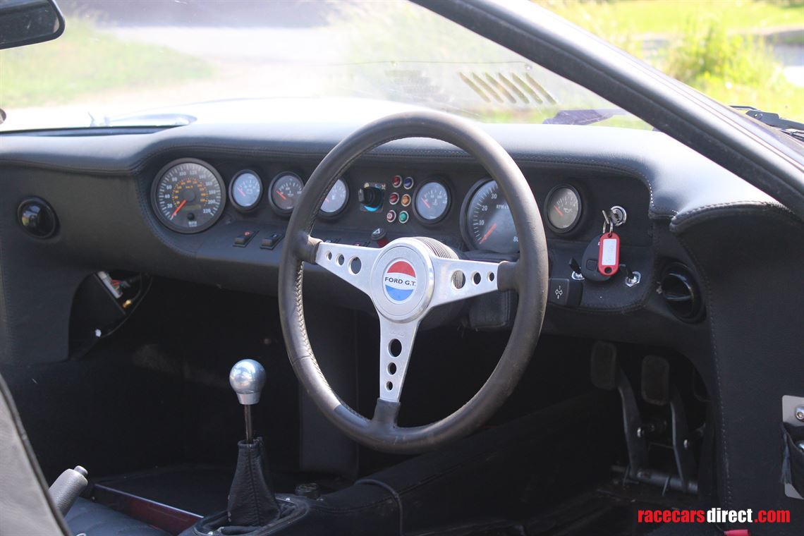

Not an expert on this but since CAV offered LHD and RHD it should not be too difficult. Key question is, do you want to keep the gear lever in the center position or move it to the rhs sill???
