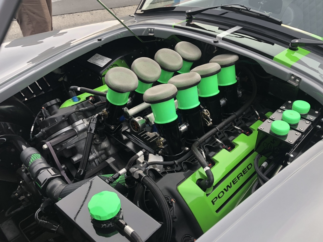

I have a Backdraft Cobra with a 1st gen Coyote, borla 8 stack, and haletech ECU.. mated to a T56 6 speed. Runs great. No complaints. Very reliable, no constant tuning or fiddling around needed. See pic

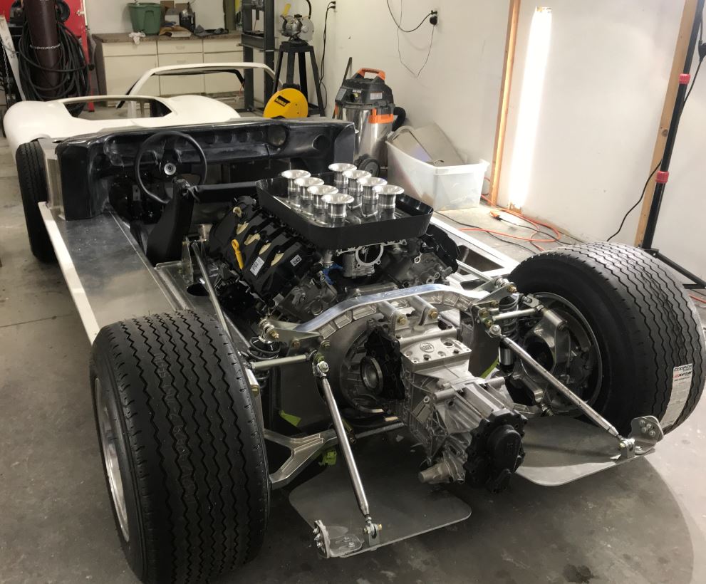

Tim Collins

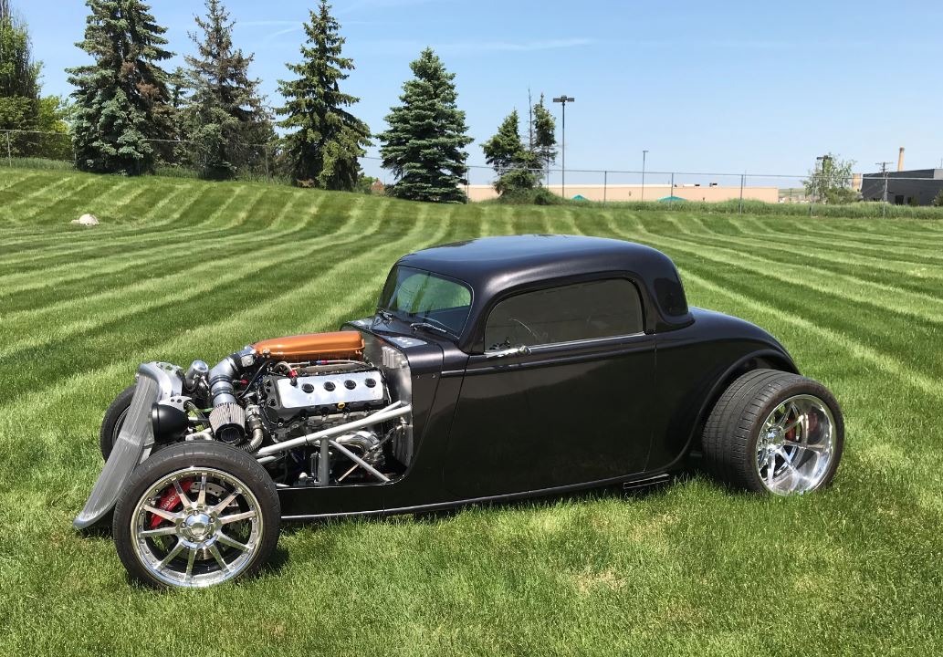

We opted for a Coyote with an InnoV8 8 stack in our RCR Mk1 GT40. I put a Coyote in my FFR 33 Hot Rod build and it's the best performing, and most straight forward install that I have ever done! I used a Ford Racing Controls pack, basically hooked up one wire and started the engine. I did have it tuned on a chassis dyno...made 445HP at the wheels.

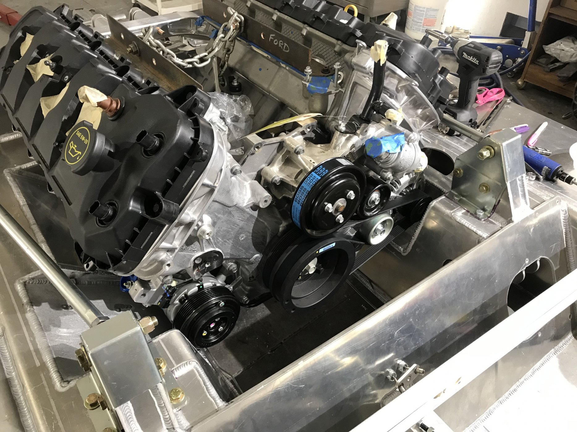

Tim Collins
Hello Tim,
A few of questions for you if you don’t mind.
What transaxle did you mate up to the coyote? ZF RBT. But been waiting nearly 2 years for the trans. They sent us an empty housing so we could locate the motor.
How did you relocate the factory serpentine set up? Didn't. We modified the RCR chassis to work with the stock Mustang FEAD, including the A/C and starter.
We’re you able to retain the factory starter location or wet sump? We are changing the oil pan to get a little more clearance. The stock pan fits but it hangs down about 1 1/2" from flat bottom of the chassis.
