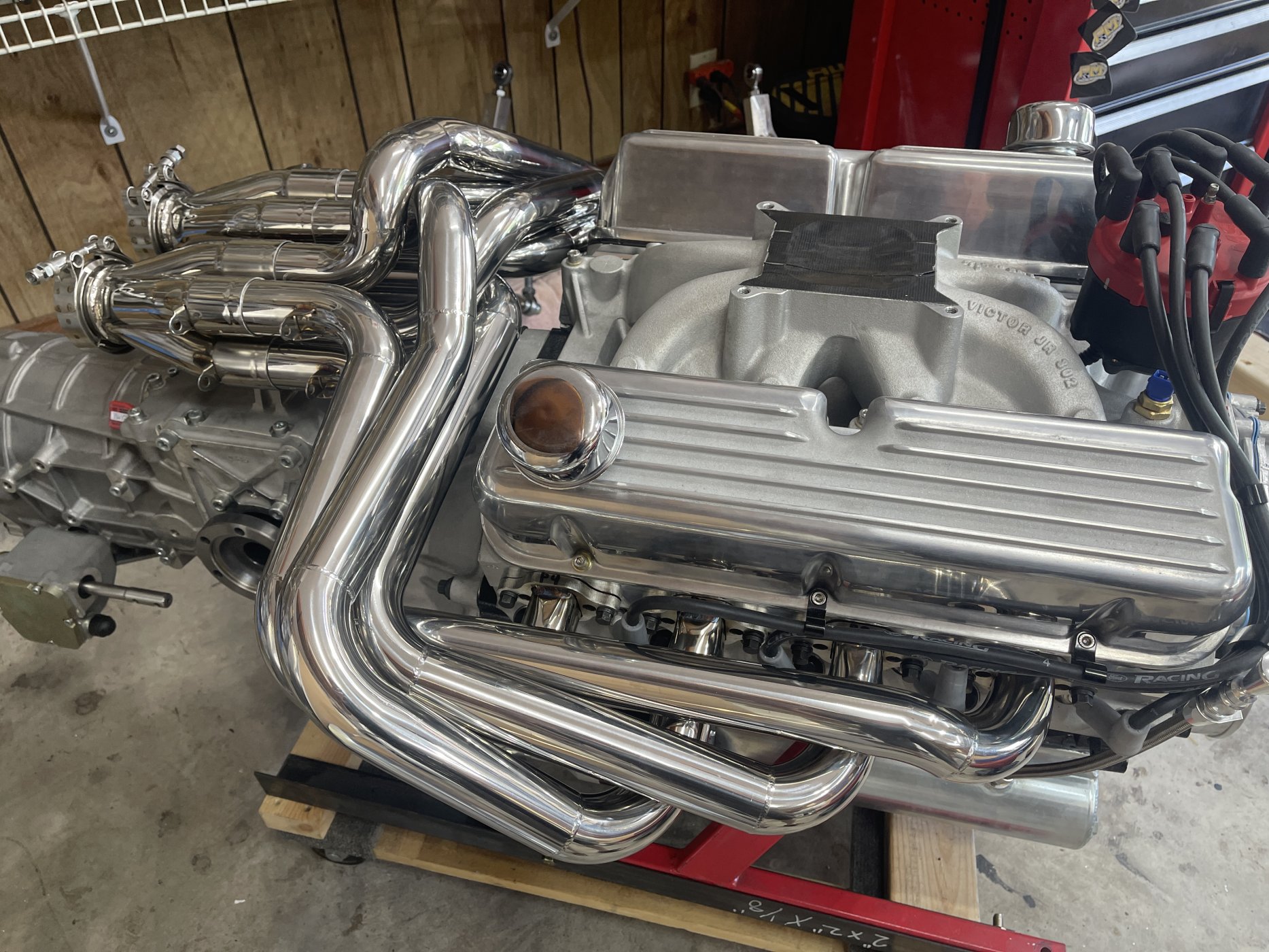

I used GP and was very pleased with their product and service. Used MagnaFlow mufflers which were ceramic coated to keep the heat down.
Pat
Looks great!! Did you go SS with the ceramic coating? How difficult was it using their builders kit? I’ve never used a mock up kit before but have assembled exhaust systems before but never a bundle of snakes! Do you remember what model and where you got those mufflers? How’s the sound and restriction? I don’t want to cut off too much power from my engine. I have magnaflows on other cars and love the sound and performance with them.
Yes, all stainless. They already have a pattern from a prior build so they can make them easily. The mufflers were supplied by GP. Sound is good, restriction is minimal. Video here.
I spoke to them the other day because I was hoping they had done a few RCR cars already and would have a pattern on stock but whoever I talked to told me I would have to get the builders kit and mock it up myself and send it back to them.
They do have a pattern and did not require a mockup from me. Call and see if you can speak with Zach. They have done several RCR with SBF and ZF/RBT. They built my headers and then I sent them the mockup for the tail pipes and mufflers.
Pat
Thanks! I’ll give them a call again today and see if I can get ahold of Zach.
