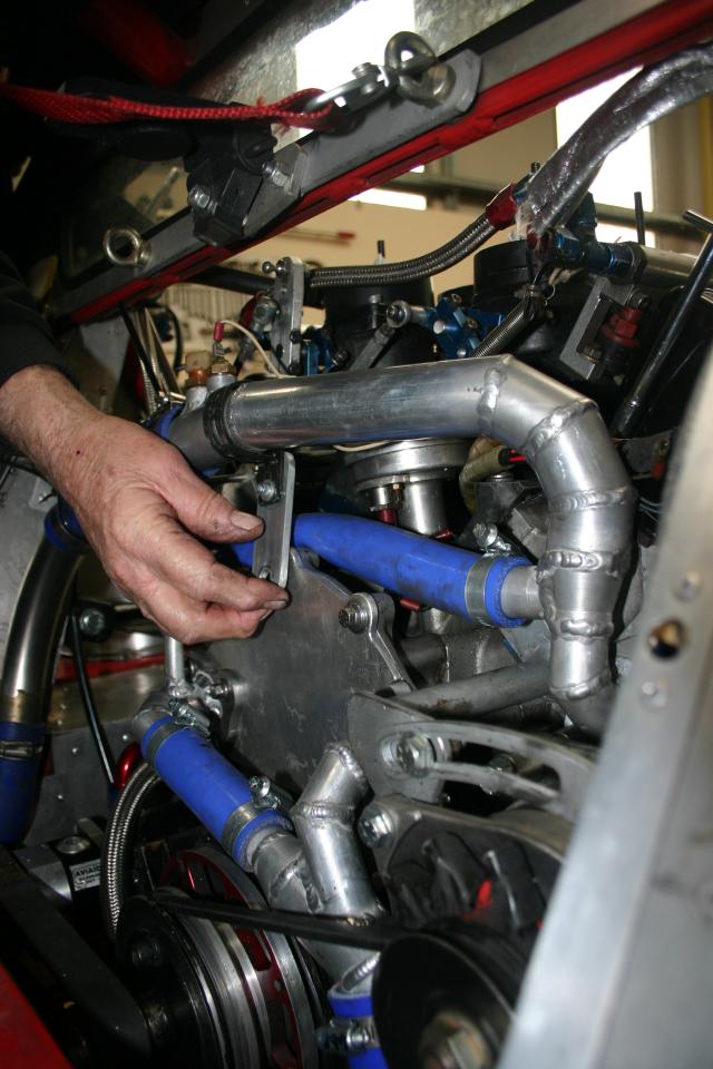

WHO NICKED THE WATER PUMP? : /ubbthreads/images/graemlins/smile.gif
Hi Trevor -
You assume correct, and time will tell. We know a number of people using the Davies Craig pump who have been very pleased with the results but I'm sure there will be a learning curve. The alloy Clevor block is fed from front and water flow through the head is controlled by a head gasket that incorporates graduated hole sizes to ensure water flows to rear of head ok. The water exits through the front of the heads through removed core plugs.
We will be logging the engine water temp as it leaves the heads using the Motec system and may use the ECU to control the Rad Fans and possibly water pump. I may add a few additional sensors elsewhere in the system as it might help us devise a better cooling control solution.
Finally, the gearbox is being fitted with an external electric oil pump and cooling rad (+ filtration) in an attempt to get the Crown and Pinion to last longer - we feel we are beginning to overstress these components. (on 3rd or 4th? set now) A specific oil feed may additionally be added to further lubricate 5th gear but the crown and pinion might not be fed also, as doing so robs power and we suspect that getting the gearbox oil temp down will help anyway.

Paul,
you could do a lot to the external plumbing to make it easier for the pump. Mandrel bent smooth radius bends will make a huge difference. The transition from the two head outlets to a single is critical as you may preferentially serve one over the other. Monitor temp at each head outlet will show this up (if a problem and all other things are equal) On high HP marine engines I have run two smaller pumps rather than one large one. (belt driven two stage) Not tried in car but same theory applies.

Hi again Trevor
Thanks for the comment - I will check with Silkolene and Shell to see what they say re temperature as you suggest.
Re the re-map, as I said we will run the car 'as was' initially as we are familiar with its temperature signature and can check logged data too. With the addition of extra sensors in the water system, I would look to log their readings and ensure all is well with the system before the new injectors and remap.
The problem with the existing injectors is we are running out of time to inject at higher rpm. Was not a problem when they were batch fired in pairs with the Accell as we often pulled to 7500+rpm, however, since moving to 347ci with Motec, I switched to fully sequential and the injectors need to be bigger. Max revs recently has been a little over 6K, say 6200?
Also - re the trans, we have considered splitting the return and feeding both c&P and 5th and may well do so in time.
Thanks for the input... /ubbthreads/images/graemlins/smile.gif
