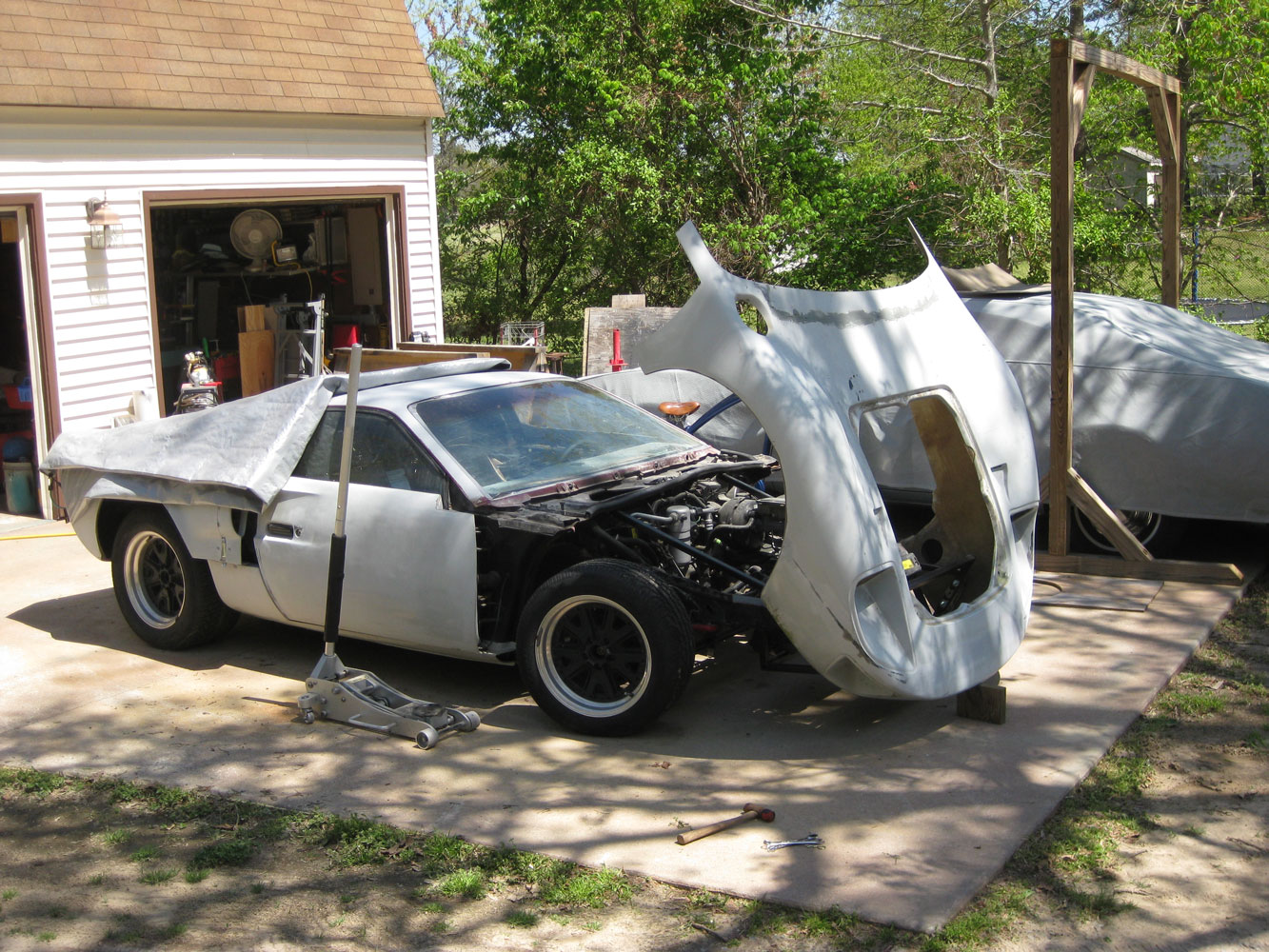

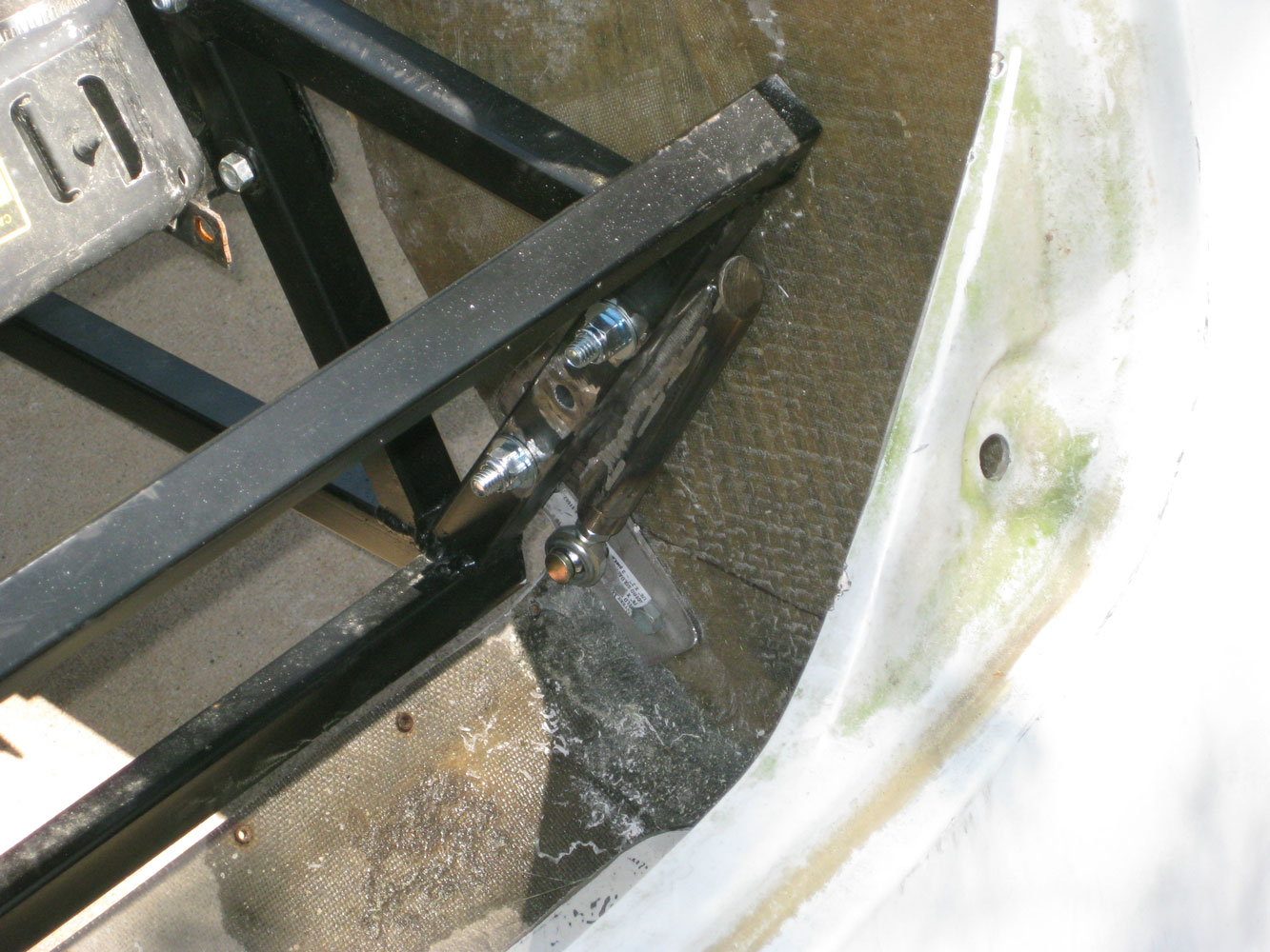

I got the inner fenders in place and built some hinges , and even got the front clip to latch

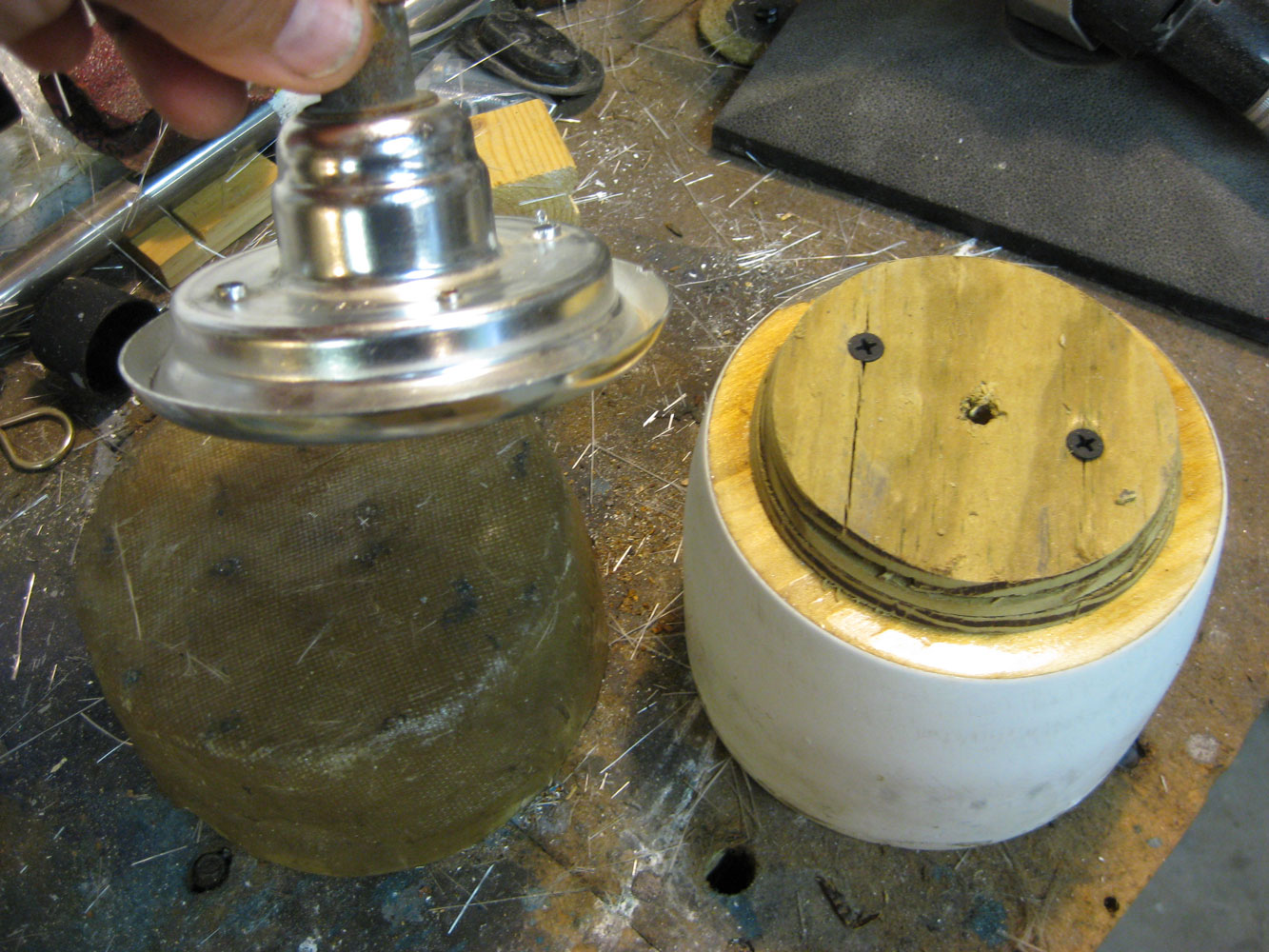

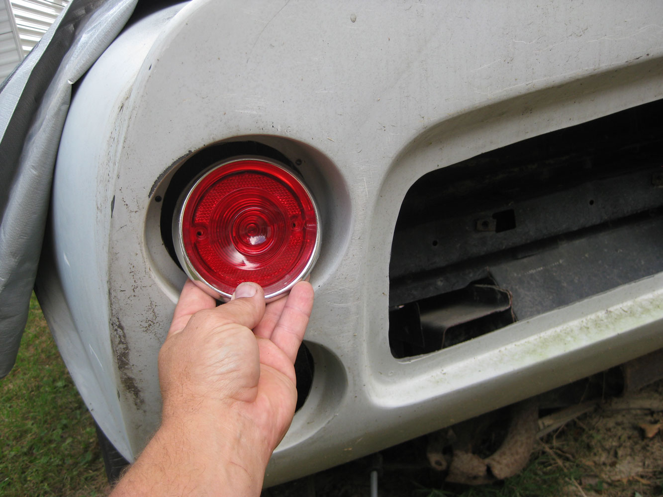

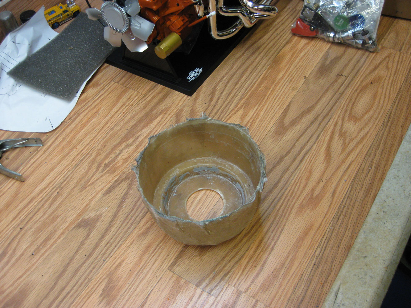

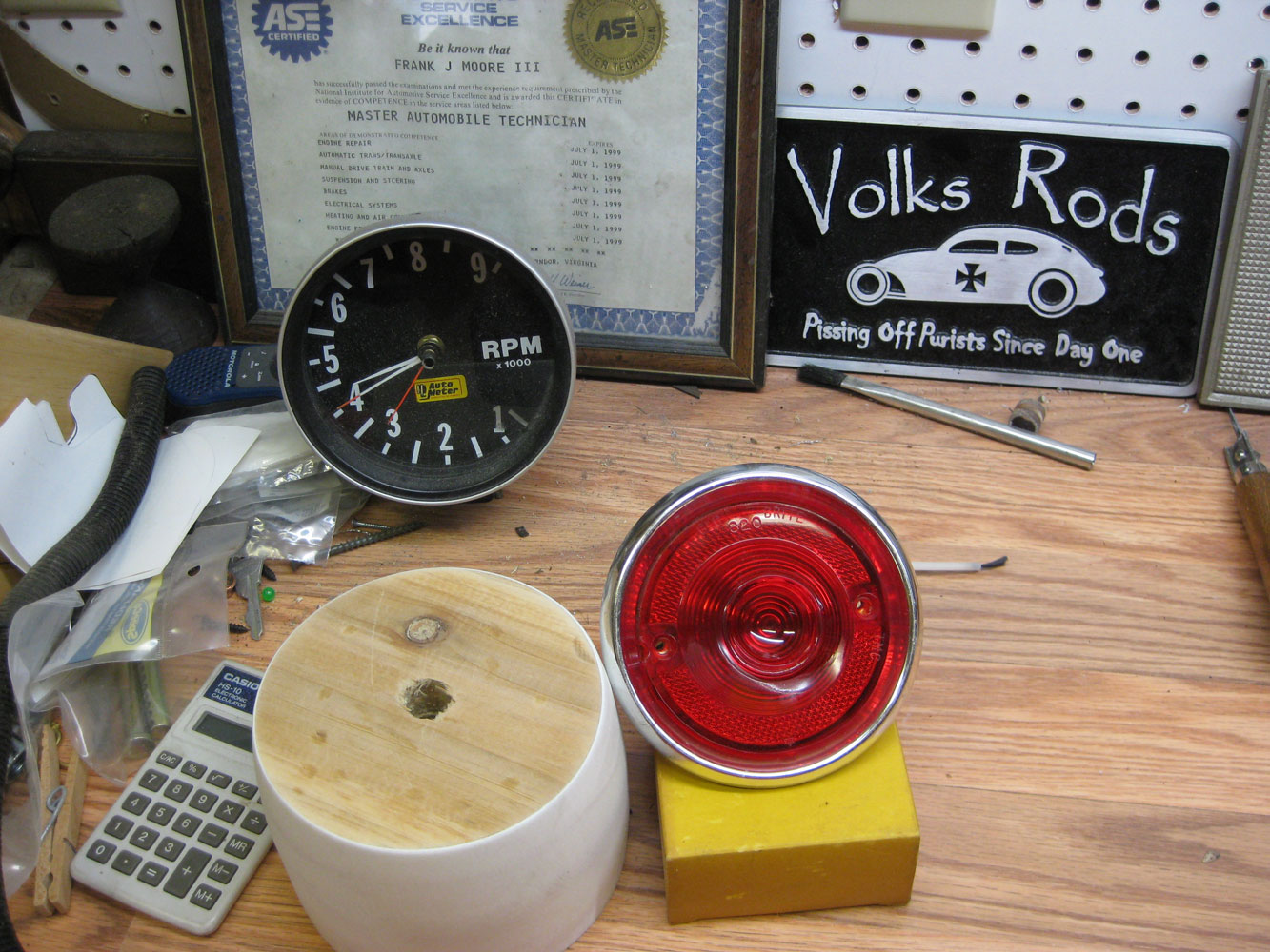

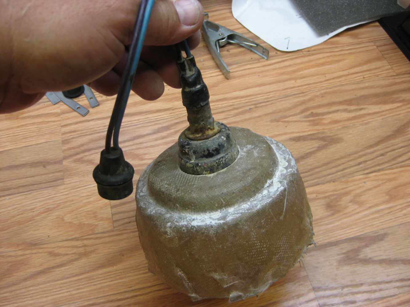

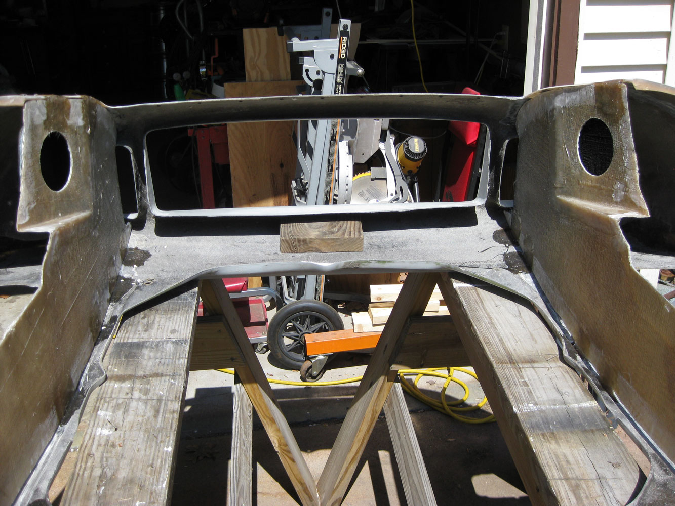

being A.D.D. as I am , I jumped to the rear
the tail lights bother me . there meant to be these large plain tractor trailer monsters . but I like the Corvair lights better , but the opening needs to be smaller so I had been searching for a while for something to use to make new plugs for the openings . I found that a pvc pipe coupling would work , so after a little shaping I'm ready to place them .

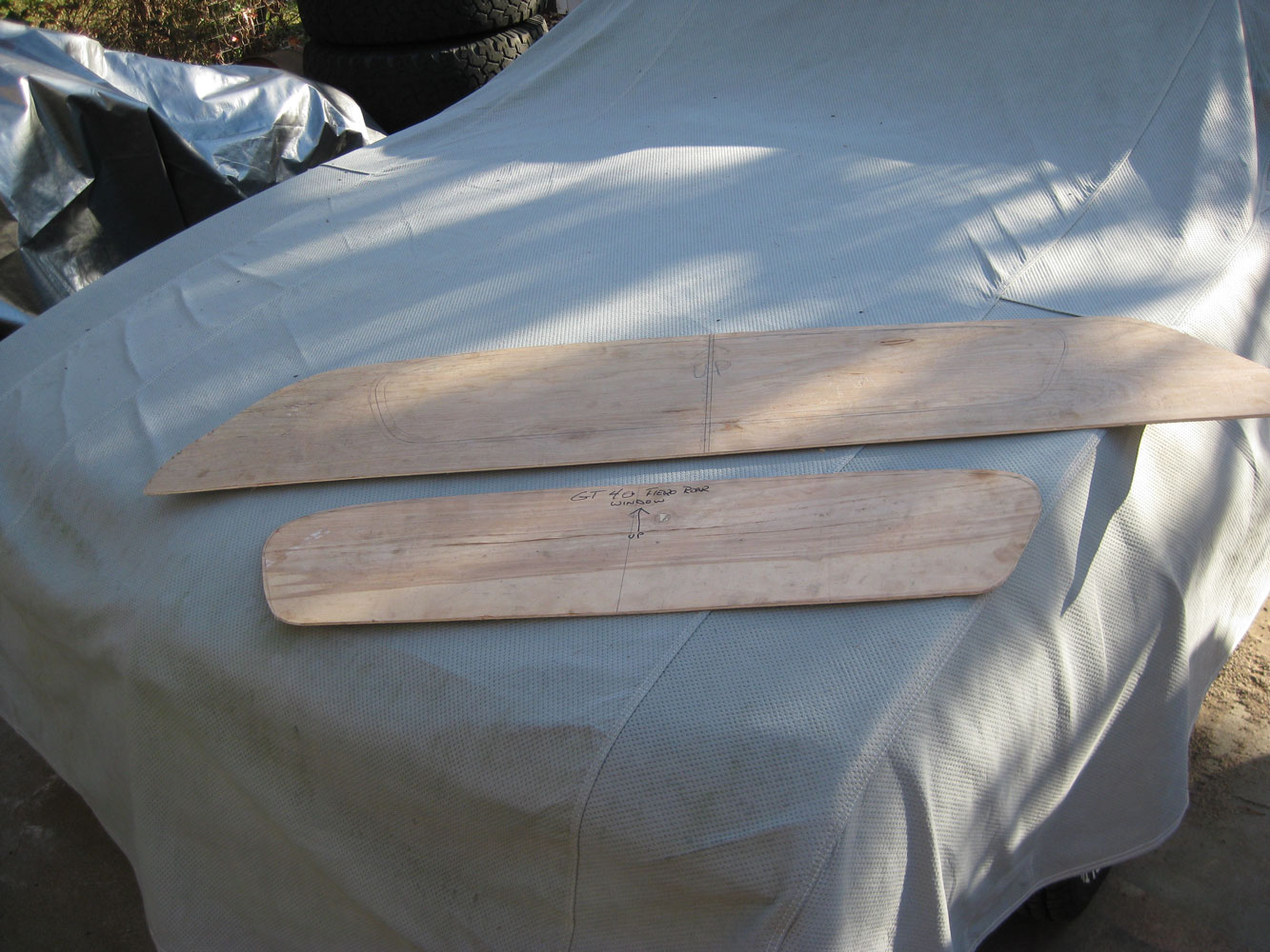

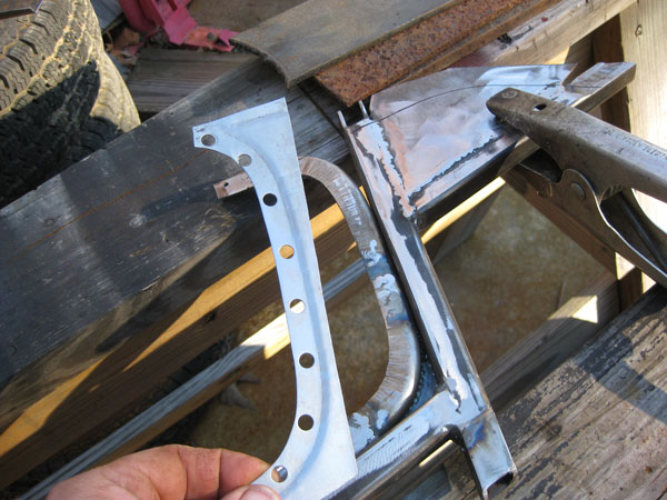

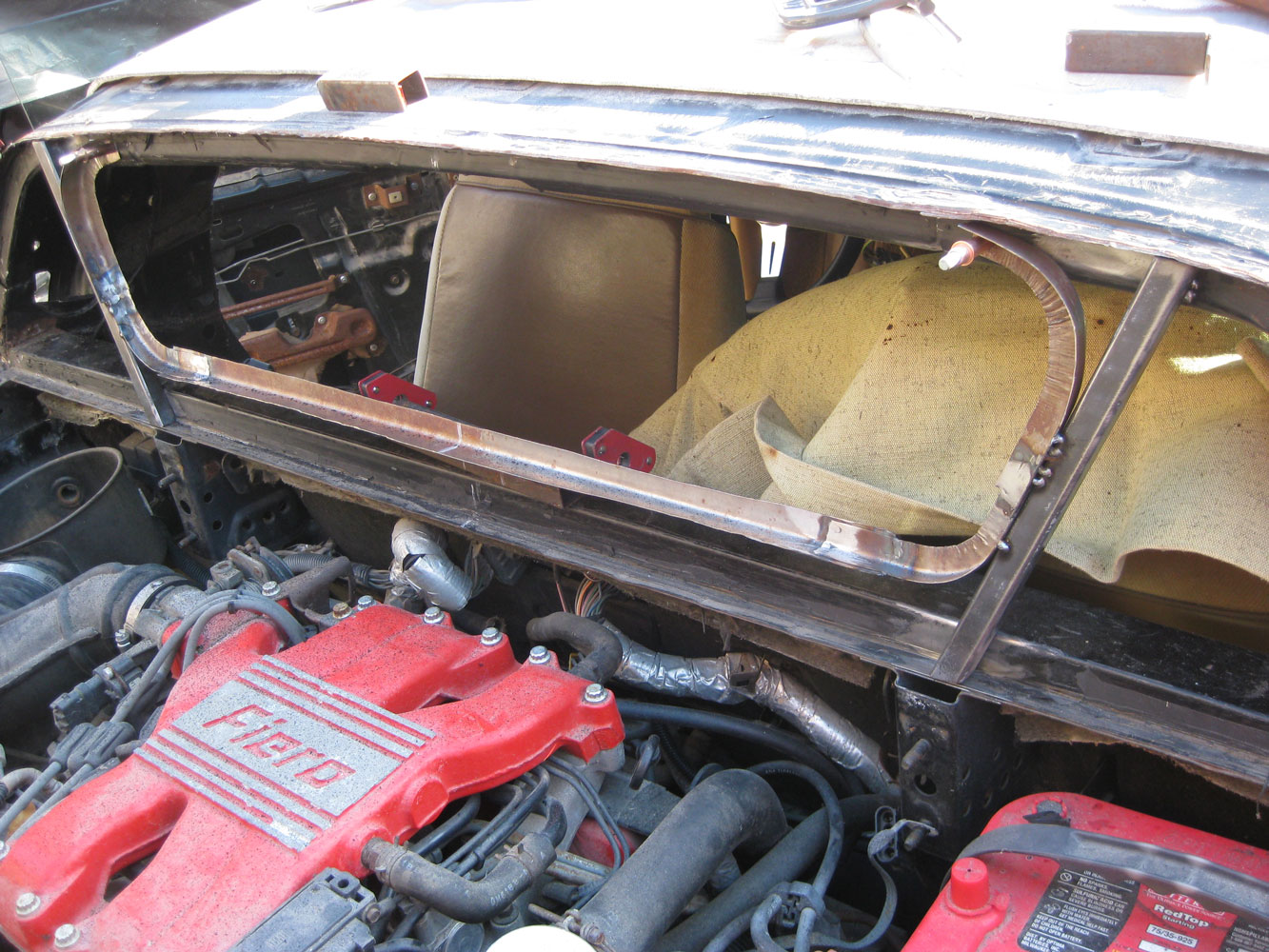

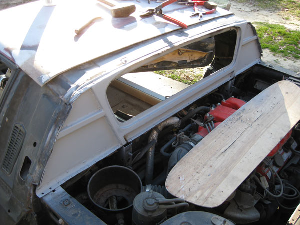

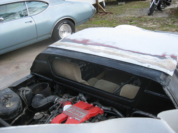

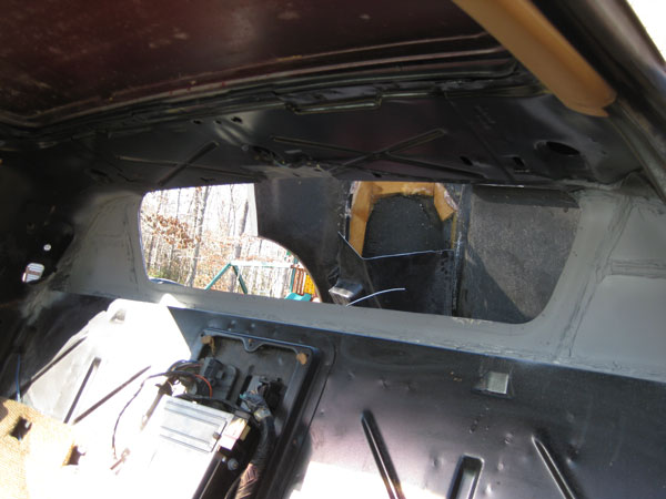

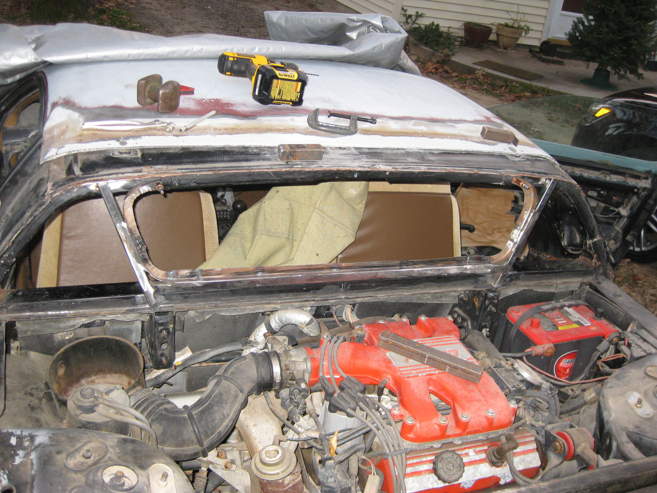

Then I finally got a rear window , thanks Mark IV , so another jump to another area to work on closing up the rear of the cabin .
I first made a pattern of the rear opening , then of the window shape .
a little bending on the brake , and some shrinking , some square tubing , and its under way ...
