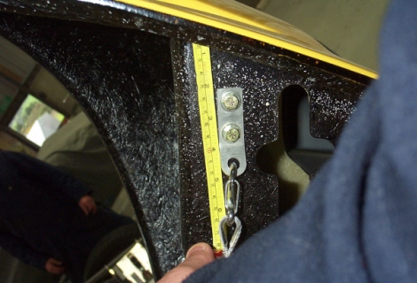

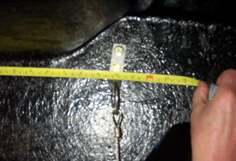

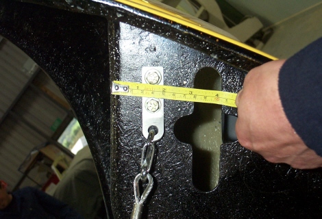

I am looking for some help on location of the Lanyards (cables)on the fiberglass body work.I know the other end goes to the sway bar upper bolt (on the front), and upper shock bolt ( rear ). If I guess now, and then later have the glass and all installed it could change the way it holds it open or doesn't in a slight amount of wind. Also the front as well. Any pics, measurements , thoughts etc. appreciated . Thanks, Dan /ubbthreads/images/graemlins/smile.gif

Dan,
I have attached a couple of photos of where the brackets mount to the body. The measurements aren't critical other that to say that the body must be beyond its centre of gravity ie, putting tension on the stay.
