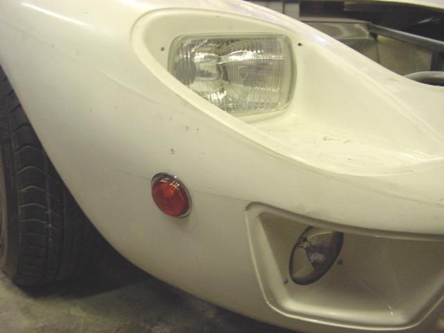

Hi Lynn, I agree, I think they are L488 with L471 amber glass. Check this link I sourced these from http://www.vintagemotorspares.com/.They certainly look like the originals are mounted from the back.Don't know any people with a real one. :( We managed to mount these from the inside with the rubber boot forming a weather seal from the inside. You could mount them so just the glass came thru. Mounting this way makes the light virtually flush with the exterior body.I am now attempting to post a pic of mine..here goes.

Dave,
That looks very nice. I have mounted the typical turn signal in the recess below a oval fog lamp, but I am concerned that other drivers that are close and from other angles might not see it down there. Therefore I was considering placing one in the same location that you have and as seen on several original cars.
