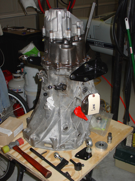

I am attaching a picture so you can see what I have. I'll call you in a bit.
Robert, I just spoke with Chris. When you send back the selector shaft, I would like you to include the central gear change kit also. Let me know what I owe for the parts please, no freebies accepted!
