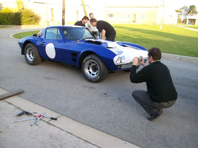

The GS chassis is a dupe of the original. A TON of tooling had to be developed for the car. Very little is shared with the production Corvette as was the case when Zora originally did the car. For example, while the rear gears are the same as the production 'Vette, the diff housing is totally different. That had to be tooled, cast and machined. No major suspension parts are the same, no body panels, no frame pieces, etc. It all had to be CAD designed, tooled, produced, tested and signed off. The amount of tooling on the GS is huge and none of it works for any othe SPF product! That amount of development and the low volume require the pricing as the amortization will take a long time over a fairly low production run.
