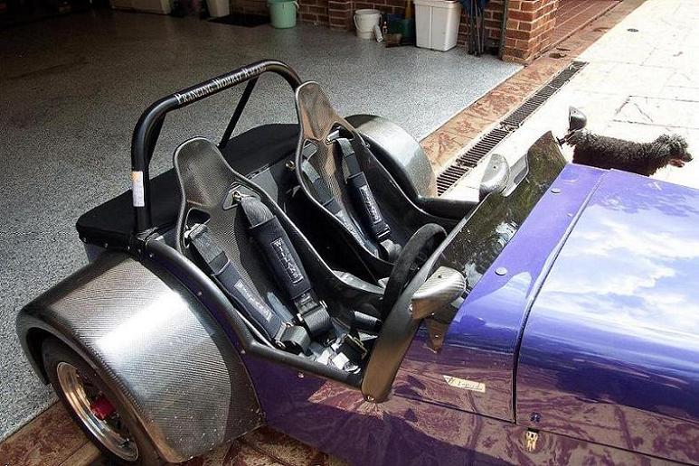

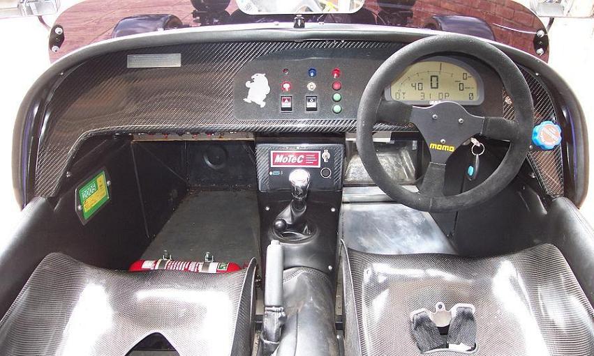

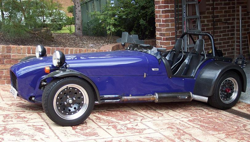

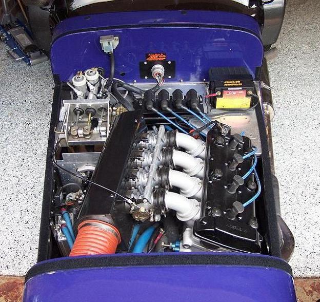

This is my PRB clubman. PRB is a Sydney based kit builder. My brother and i built two identical kits, but wanted something different from the "normal" 1600 toyota powerplant. Bike engines seemed popular int he UK, so we took on the project of modifying the chassis and engineering the parts & systems requires to get the Suzuki Hayabusa 1300 into the clubman and make it work.
Breif specifications:
Weight = 440kg (968lb)
Power = 210 bhp
Motec M4 pro
Motec ADL dash/logger
Quaiffe reversing box
Dry-sumped GSXR1300 with Yoshimura cams. Standard bottom end.
6 speed sequential gear change.

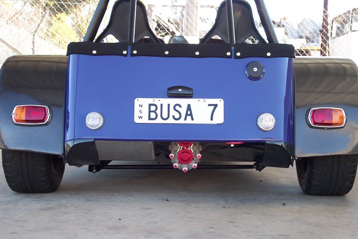

Winters "baby grand" quick-change fully flaoting live axle. Alloy casing, torsen LSD, gun drilled axles, quick-change final drive (ten minutes) ratios.
carbon fibre seats, guards, mirrors.
A real fun thing to drive. I have not lost a "green light drag race" yet.
/ubbthreads/images/graemlins/grin.gif
diff. See romavable plate for changing ratios
